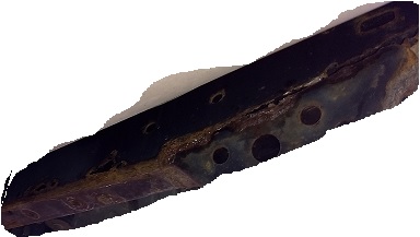

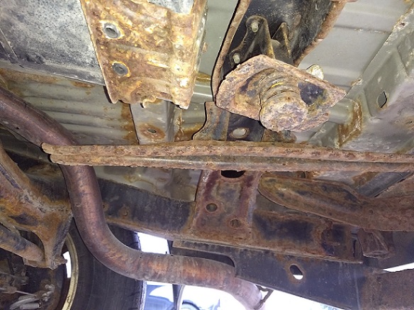

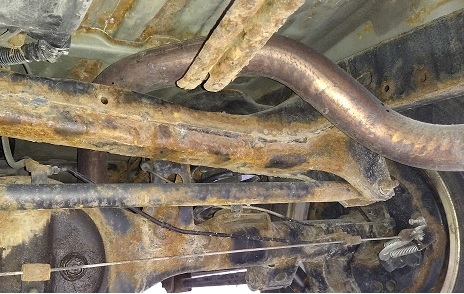

First two pics are spare tire area, tire removed obviously. I realize now crawling around underneath it why I didn't notice, it's not really in the back more the middle of the frame, in an area I hadn't gotten to yet.

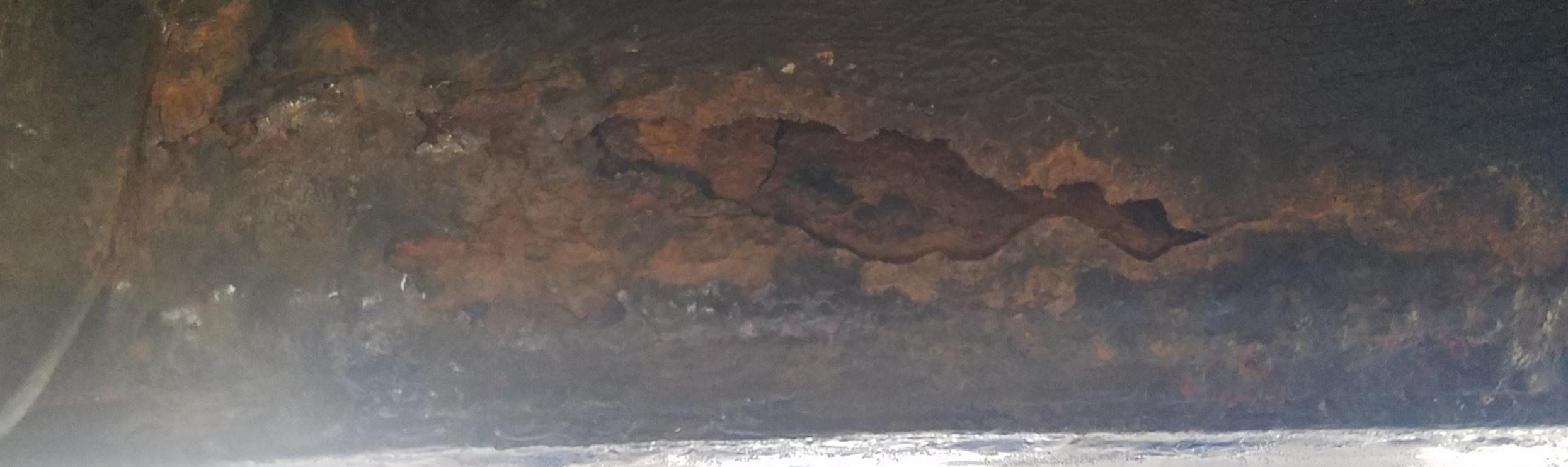

Last pic is the best I could get of the spot that has holes in it. For some reason I could not get the file size down to where it needed to be without cutting out most of the image. My phone's camera kinda makes it look like the rod connecting to the frame at the right of the pic is separating from the frame, but that's just weird lighting. It's still solid at that point. So far.

There's much worse out there. Here's your plan of attack.
1. Get it patched
2. Oil the frame. Any oil. Used engine oil, Fluid Film, WD40, whatever. Coat the whole frame with it. Take it for a drive to build up a layer of dirt to turn it into grease. It will preserve that metal for a very long time.

They also fill up inside with rocks, dirt and mud that stays wet every time it gets wet thereby eating the frame from the inside out. That problem spot by the rear control arm brackets is a low spot with poor drainage so stuff gets trapped in there and eats them out. It's prudent to flush the frame out every once in a while, or at least before you fill it up with oil.

Yeah where the center cross member rail is welded is where mines starting to rust..The trailing arm brackets are pretty solid. If you happen to check out my profile album I have photos of the rust/rust preventative I used and its held up pretty well. I think I'm gonna hit it again this spring after I get that spot patched. What will it take for yours to pass inspection? All we have around here is emissions and the county I'm in we dont have to pass any emissions. So I feel for ya. Good luck with whatever you decide!
Basically can't have a hole in the frame. So a patch, but nobody wants to do it. No auto body type place will deal with frame patches because of liability. So I'm looking at any other type of place with a welder that might be willing to do it.
My mechanic said they should drop the gas tank to check the other side too, which seems excessive to me. You can see well enough along the side and feel up there for any holes. AFAIK the right side is where it's always worst, and mine is just starting, so...
I don't know, I may have to shop around for a garage that will pass it even with a patch. If I can get away cheap enough and keep it legal for a year or two that would be cool. I can keep cleaning up the rust and coating the frame and see how far it gets me.
