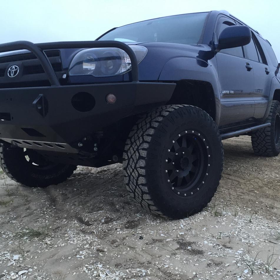

12-9-15
Had a buddy install a lot of my parts song could make a trip back in October . Have been remodeling my new house and haven't had time to work on my truck . Soo the bumper is on , CB , fog lights, winch, synthetic line front stainless braided lines , rear ext brake lines , metal tech bump spacer , long travel rear in and I went back to stock air box (again) tired of cleaning and oiling intake .
Got the metal tech kit went with the 3" dual rate long travel springs , icon 2.5s with cdc clicker things , and dropped ma sway bar . Went to Potts mtn and performed awesome for being open open with 32s the added travel out back definitely got me through a lot more places previously it was pretty pathetic what I would get hung up on due to lack of lockers .
Future plans
Rebuild coilovers , make decision if I want to save for gears lockers and 315s or go budget route and get 285/75/17s and just a rear locker for now .
Have the following to install whenever I get around to finishing my house and have time . Opr link guards , metal tech lower links , icon rear shock skids , cbi ditch light brackets and flood pattern led cubes , fuse box , ottraw switches , back up light , rock lights , on board air , prinsu rack (they make one for fourth gens now !!) and ebc stage five rotors with yellow stuff pads .
Problems incurred. When trying to install the new pads and rotors couldn't get the pads to work seems as if the auto store calipers I've replaced may not be exact oem replacement haven't figured out yet . After adding long travel rear the drive shaft nails the gas tank skid plate at flex . I cut the corner off where the mount is and relocated the mount more to the inside and welded it in place . Still rubs a little need to grind more but much better than it was . Previously the bolt heads on drive shaft were hitting the bolt head on skid plate mount so was a clunk clunk . Other than that everything works good winch works good , I've outgrown the tires for sure wanting more aggressive bigger tires . Looking to go with a total chaos long travel set up in the front or sas be looking more serious into it this time next year . Here's some pictures .
