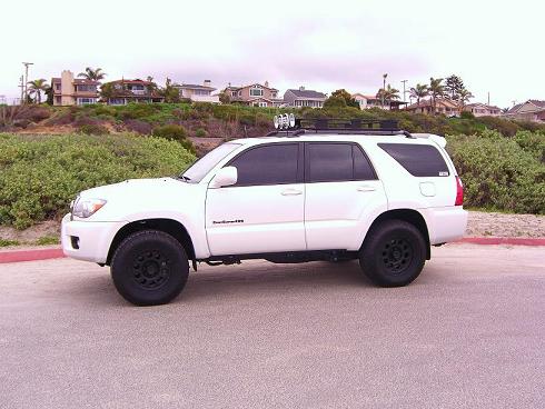

My 07 Sport V8 4wd
Roguesport1
It's a work in progress, Best truck I've ever owned
Replaced all interior bulbs with LEDs.
Replaced lic plate, rear signals and reverse lights with LEDs.
2in front spacer, soon will be 3in front and 2in rear.
Tinted to match factory privacy glass.
DRL override with switch.
Used factory tacoma aux switches for lights in dash blanks. They Light up red/orange to match.
Blk pearl emblems.
Removed step bars.
Replaced sport wheels with offroad 17in/8in wide and had them powdercoated 20% gloss with texture, took me a long time to find wheels that had a +10 offset so they would line up with fender flares.
Used Nitto terragrappler 265/70/17
Surco safari basket mounted on fact. rails so its low on roof and looks clean.
4 hella with 100w bulbs wired through fact roof rack.
Fabricated holder in basket for 4 5gallon cans.
Replaced radio with eclipse avn2210p(Crutchfield) from Urban Runner, ordered factory bezel and steering wheel button adapter along with the JBL adapter
Monster mats
Gorilla blk lug nuts
2 Level O Gauge, dash and b pilar mounted
110v convertor
Driver side grab handle
lots to come

Of course thats your opinion, but seeing that your geographic location is NC leads me to believe your several years behind, and since I 'm not a prof Hip Hop recording artist I don't find Chrome or Bling appealing.

Of course it's my opinion, who else would it be? U like it so you have it. hence I don't like it, I say so.
btw, i'm in north California.

those wheels make the car looked crappy

Welcome! Those wheels are PERFECT for offroading. ;)
Geez you have a long list of mods there! :jaw drop:
Welcome aboard! Your truck looks great (even though I'm not a big fan of your wheels). :cheers:
Judging by your very impressive mods list you are getting ready for some serious off-roading.

Looks great, as for el_do33, that's a pretty whimpy mod list to be so bold when putting others down for working on their truck.
Those tires look good, and the steelies will be great for offroading. I have a few big chunks taken out of my front rims. :D
Good idea to up-size your lift, those tires are beefy as hell, and eat up your wheel well space. However, I don't believe Terra Grapplers come in 275/70/17.......

I believe your right, I think they are 265/70/17. Yes they do real well off roading but I will go with a more meaty tread next time, like a M/T.

I hated the 3/2 off road, but it was fine for city driving. As for the HID, no one has flashed me, but I lowered the beam after I installed them, because I installed them around the same time I first lifted my truck.
Love the wheels! I think they look great, and the tint looks good too! post some more pics if you can.

Nice looking 4Runner Roguesport1. I've been looking real hard at the Surco rack but still have not made up my mind.. Could you post some more pics of your runner? BTW I'm from North Carolina(Raleigh) we are actually quite progressive.

I have used the Surco on my old Tahoe and now my T4R, but I don't mount it per instructions. The kit gives you cross bar that mount on top of your fact rack then under the basket. This setup, I feel put the rack too high off the body(personal) also exposes to much for air current to make wind noise.

Something else that I did is only ordered two surco light mounts and drilled holes in the two verticle supports to accomidate two more light, it took some time to measure it all out but was worth it. It all lines up perfectly.

Sorry, let me rephrase it. Your wheels are not in my good taste.
