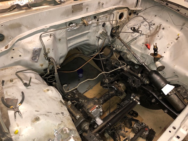

My 1987 build..."Achillies"
Also I have some serious build up/corrosion in my cooling system. Can this even be cleaned out? I don't think i can get these lines brand new anymore? I have missing bolts all over, mix match bolts and some that were way loose.

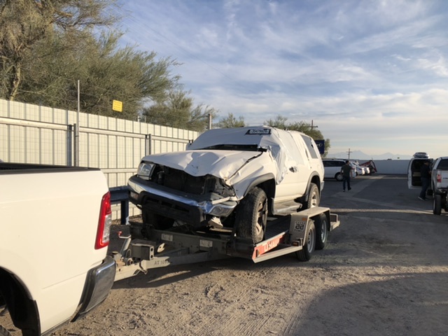

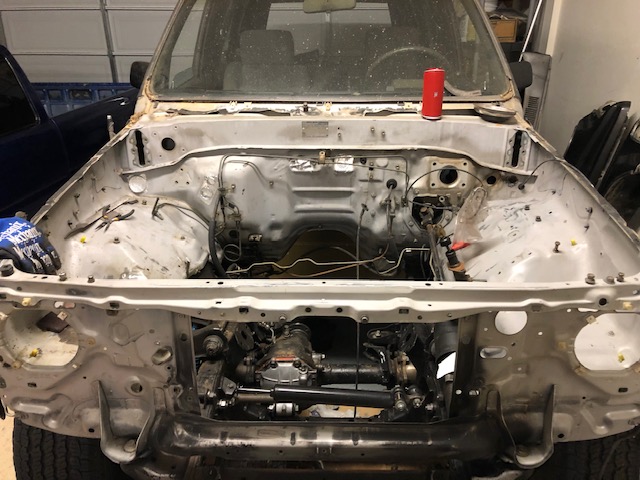

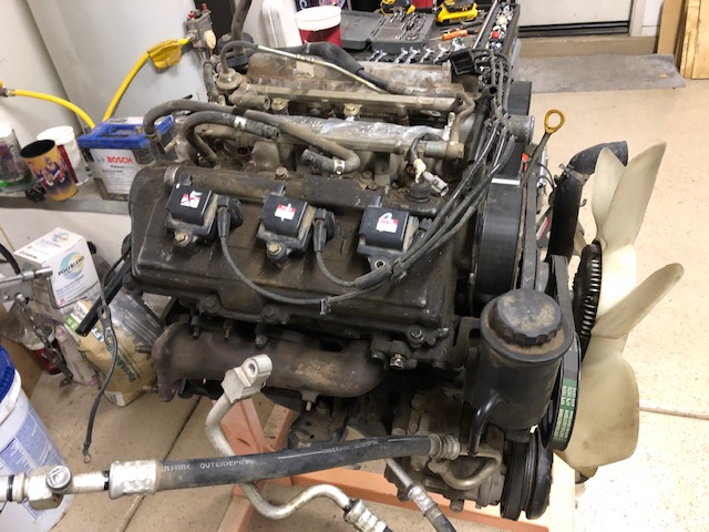

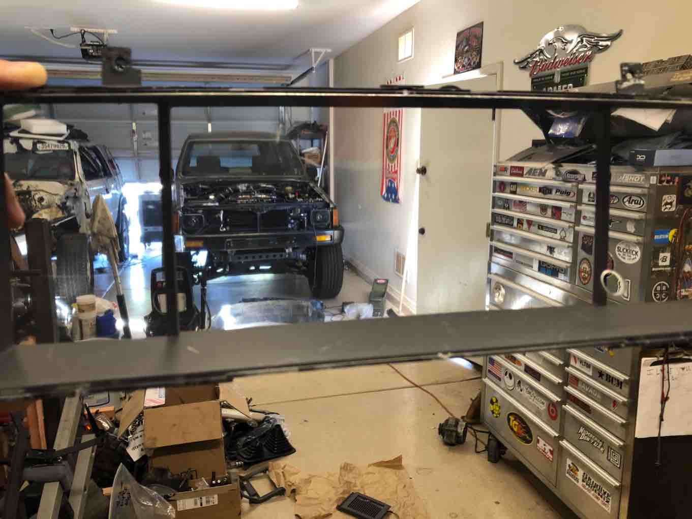

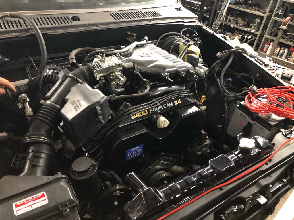

Truck has been down since my engine failure but got some good news. The engine swap is finally happening! I picked up a donor at Copart, 99 5spd with elocker and outstanding service history. Ive been busy stripping it and cleaning up the first gen but hope to have this thing running within a month or so!
All cleaned up! I will be painting the engine bay black

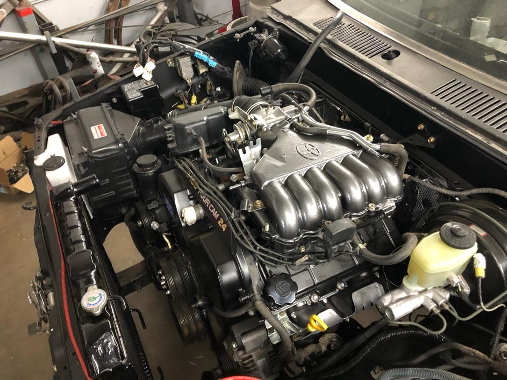

Also working on doing some maintenance on the engine and cleaning it up as well. Timing belt, water pump, idle bearing and all the other stuff was just done about 20k miles ago. This thing started right up when i got it home and ran very good!

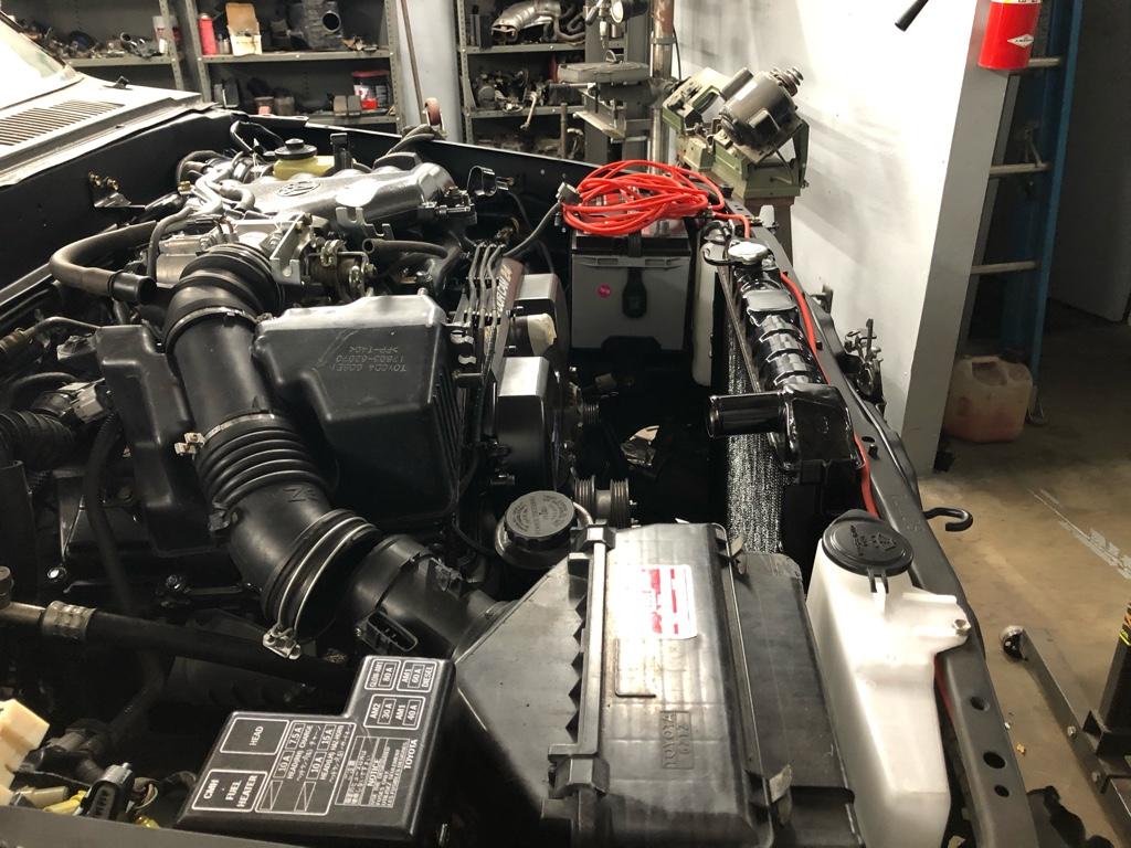

Been busy on this thing

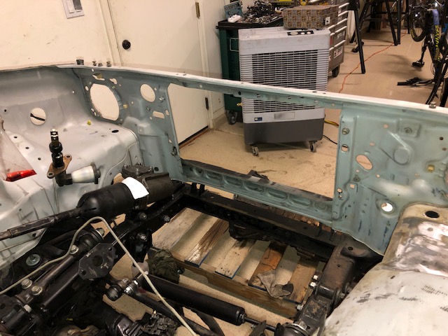

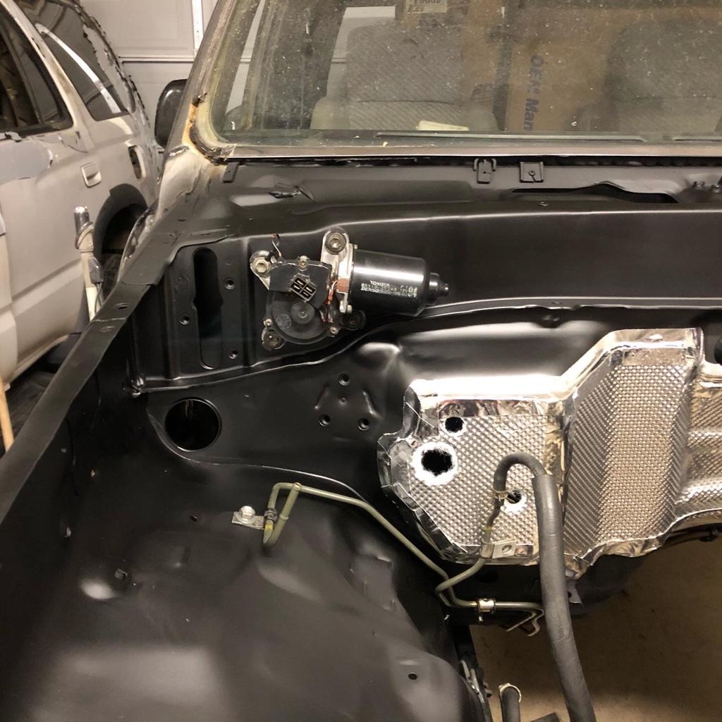

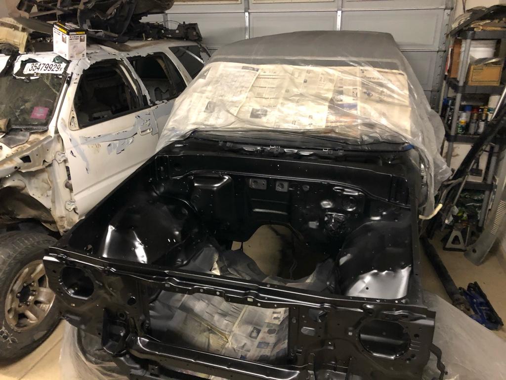

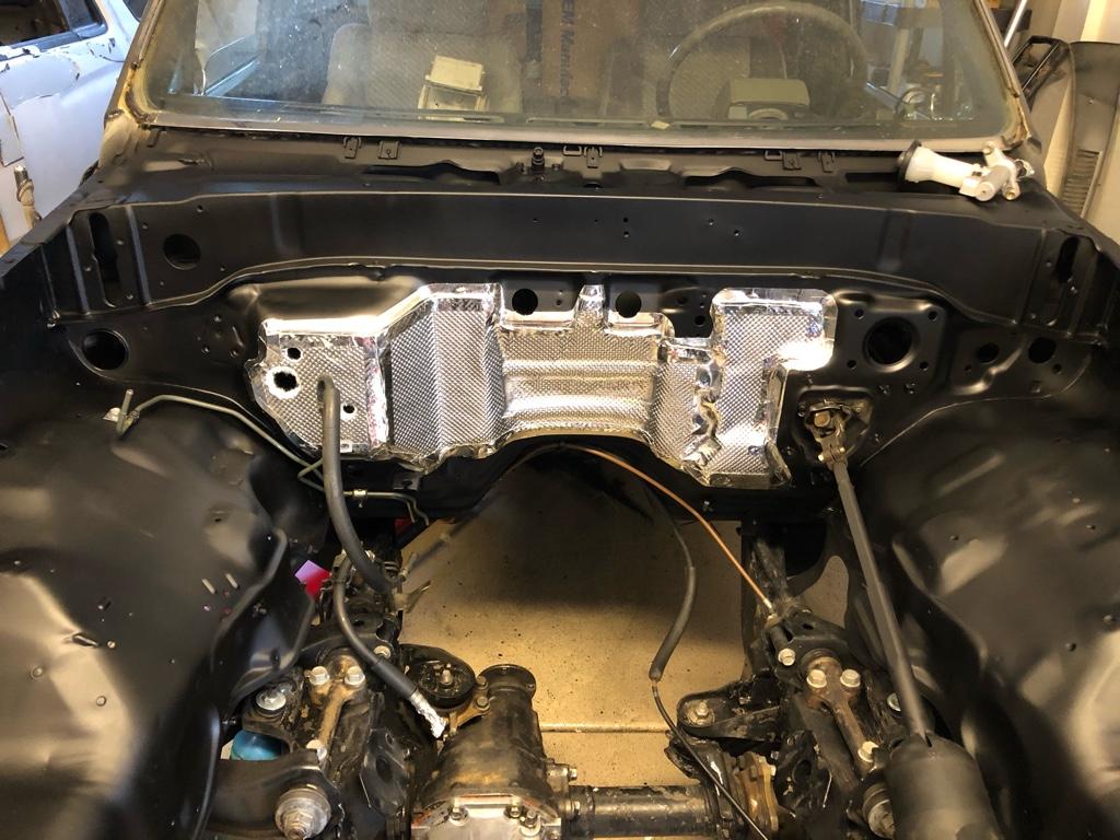

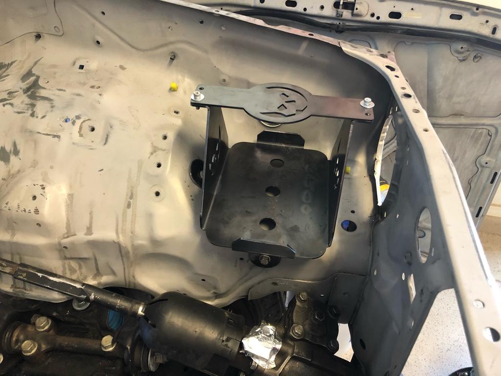

Mounted my ballistic fab battery box, painted engine bay and put down some heat shielding. Been cleaning parts like crazy before I put them back on.

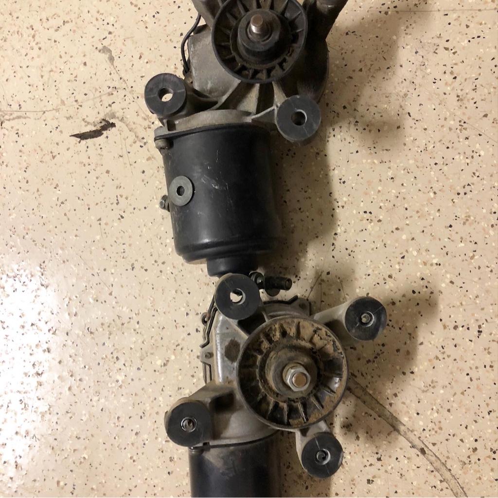

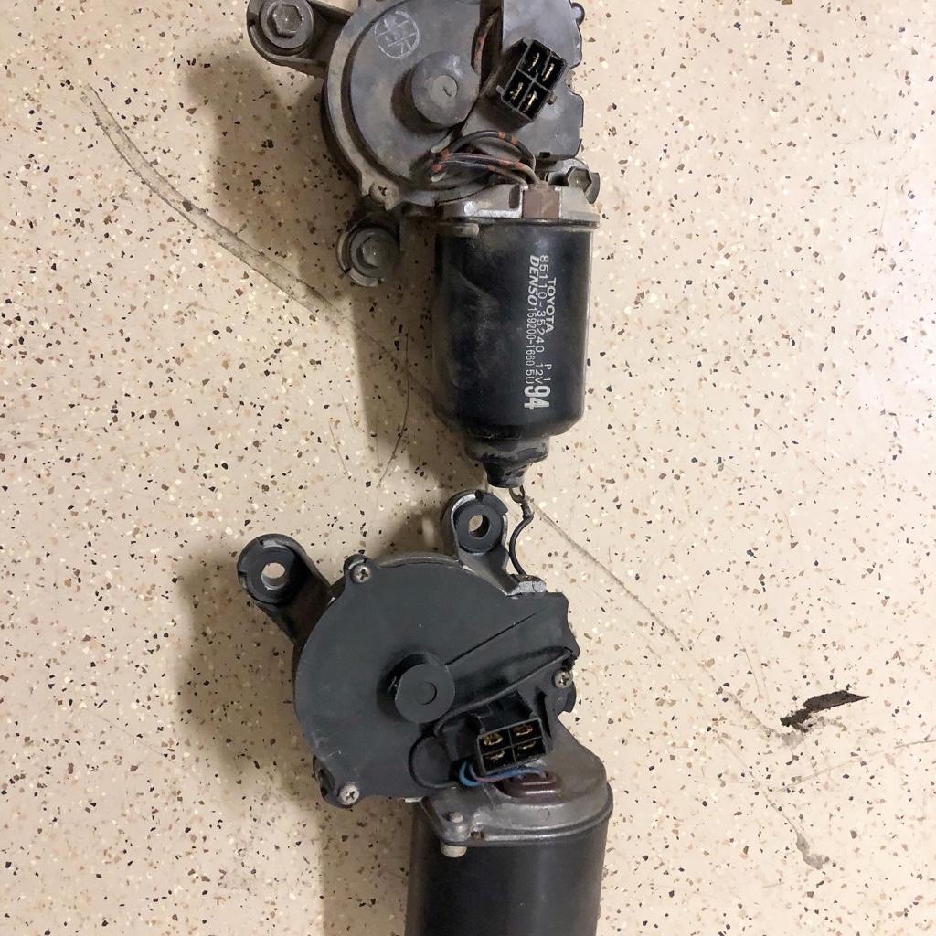

Also if you didn’t know the wiper motor from the 3rd gen is a direct replacement. The plug is the same even the grommet on the back. It’s nice having a parts truck!

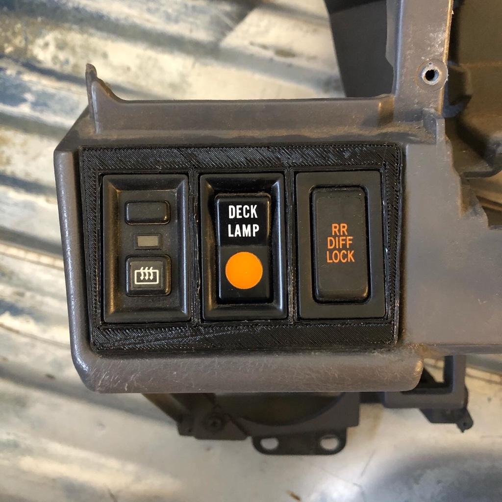

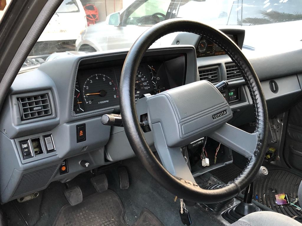

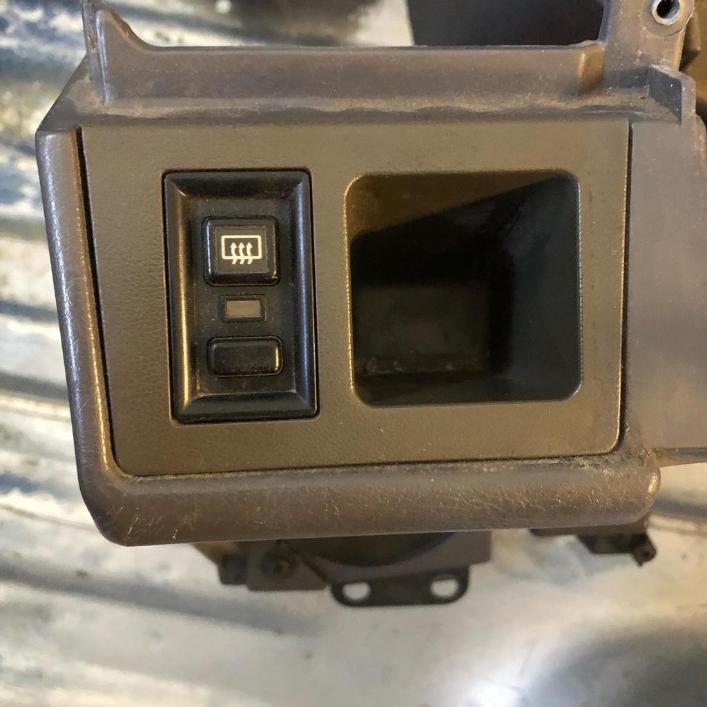

I also designed a replacement dash panel for factory switches. If you don’t have power mirrors like me you have this useless cubbie hole. I don’t like the look of aftermarket switches so I’m going to repurpose a factory deck lamp switch for rock lights or light bar. I will also mount my diff lock switch here.
It still needs to be finished but the switches fit perfectly and it snaps into place on the dash like the factory piece did!

Engine looks awesome!
What is the heat shielding on the firewall?
Nice 3D printed switch bezel!
Thanks!
Shielding is DEI floor and tunnel shield. I finished the edges and seams with DEI high temp tape

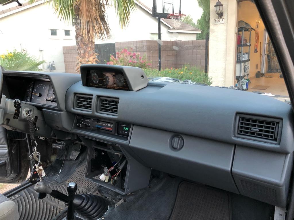

Starting restoring interior

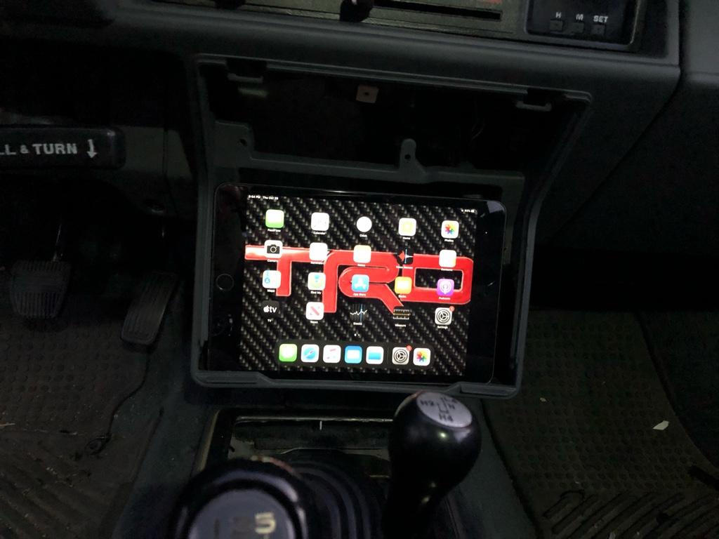

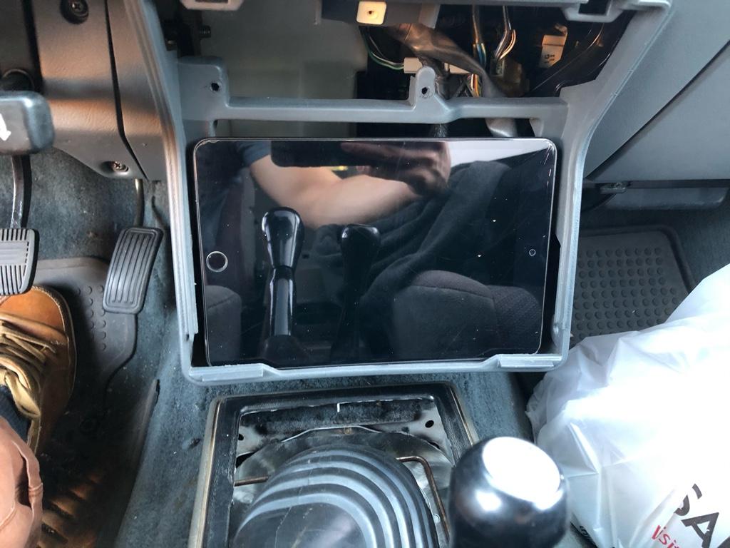

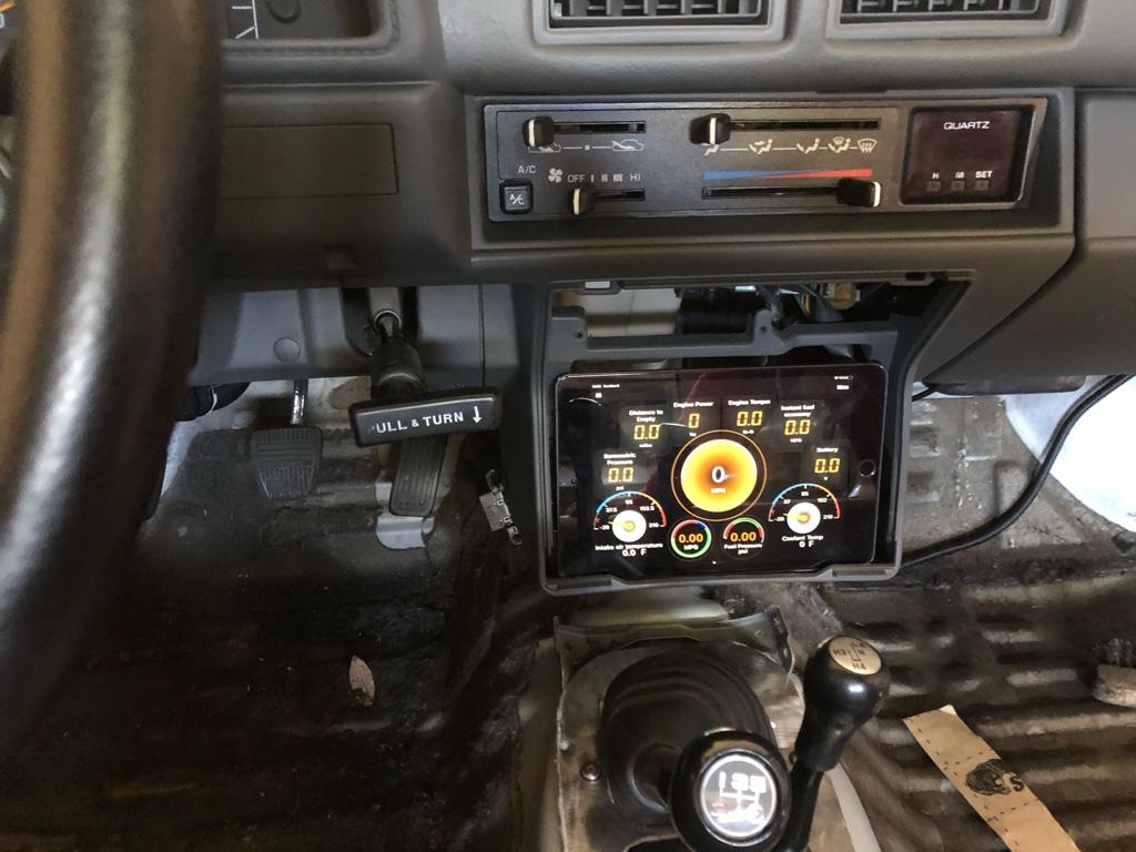

Doing an iPad install

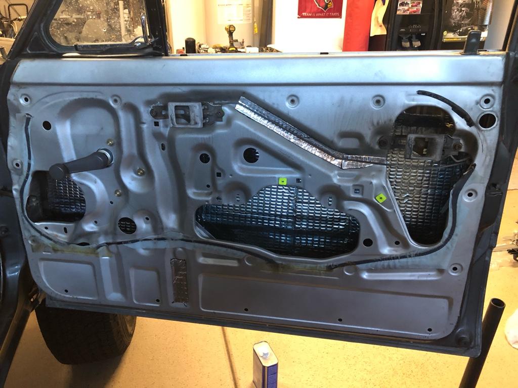

Installed sound deadened
Stripped and getting ready for paint

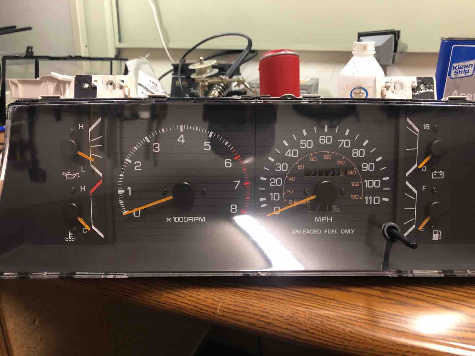

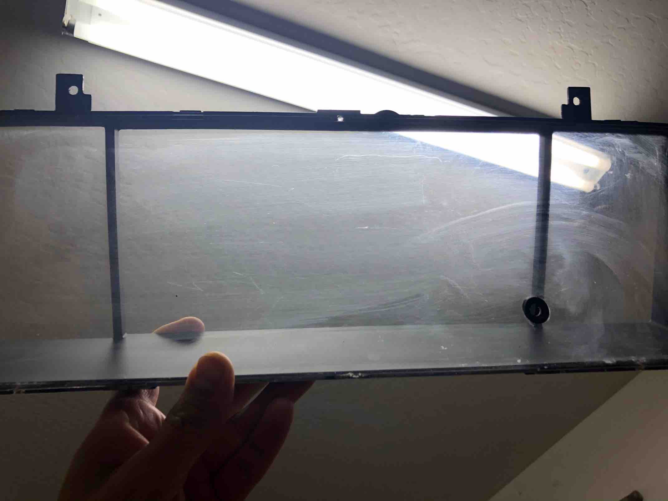

Gauge cluster restore
