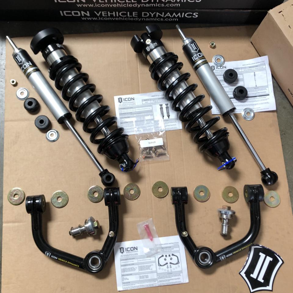

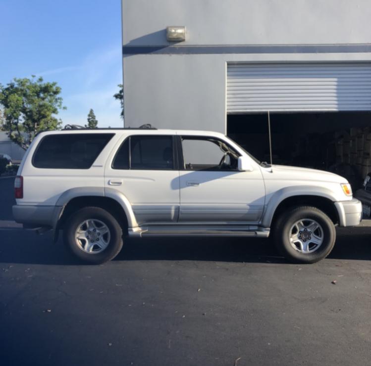

Hello guys. I recently sold my 1998 Tacoma Xtra cab 4WD and purchased this 3rd gen 4Runner Limited 4WD and I am new to this forum.
To do list:
-Use JDM engine x
-Replace steering wheel x
-Replace front seat cover x
-New radiator x
-New tires x
-New rims x
-New heater core x
-New front window x
-New coilovers x
-Reverse camera
