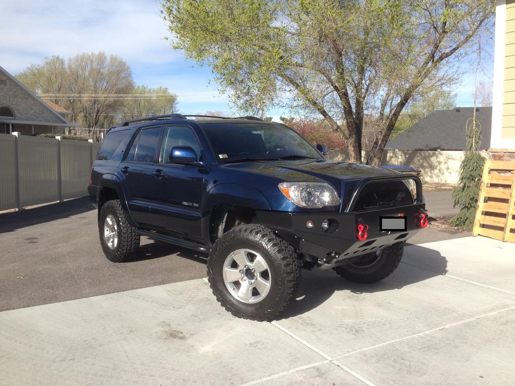

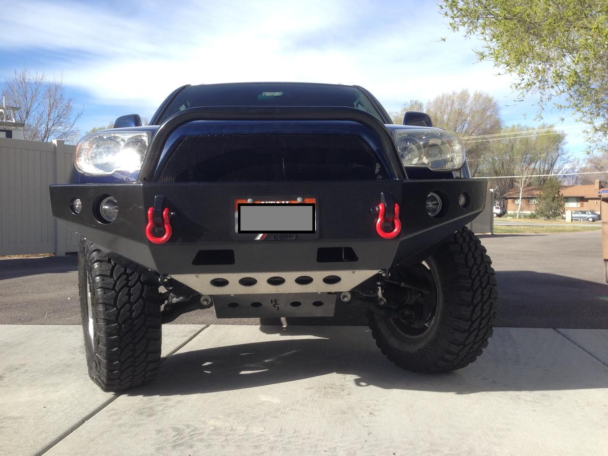

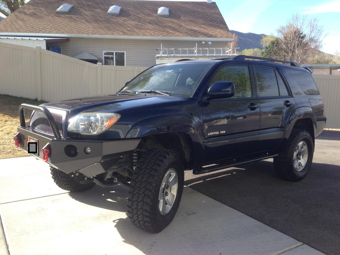

I hope this can help those with the earlier 4th Gens who are looking to this mod. This is an exact "to buy list" and 4Runner fabrication list. It took me a while to piece all of the different threads together but it was worth it.
I have a Shrockworks bumper so I did not need to trim the grille. There is a 3" gap between the bumper and the front of the grill so the lower part actually sits nicely within the bumper. If you have a 2003-2005 bumper you will need to trim.
I didn't take any before pictures of the early Grille or pictures of what a 2006-2009 grille looks like before it has been cut, sanded and painted because they are already on this site.
Total time was 3 days but that's because I was extremely meticulous with the paint. I also had Toyota install the lights because the wiring was just something I am not skilled enough to do.
***Note***
There is plenty of room between the mounting holes on a custom bumper and the grille to install a light bar, rectangular lights or round lights.

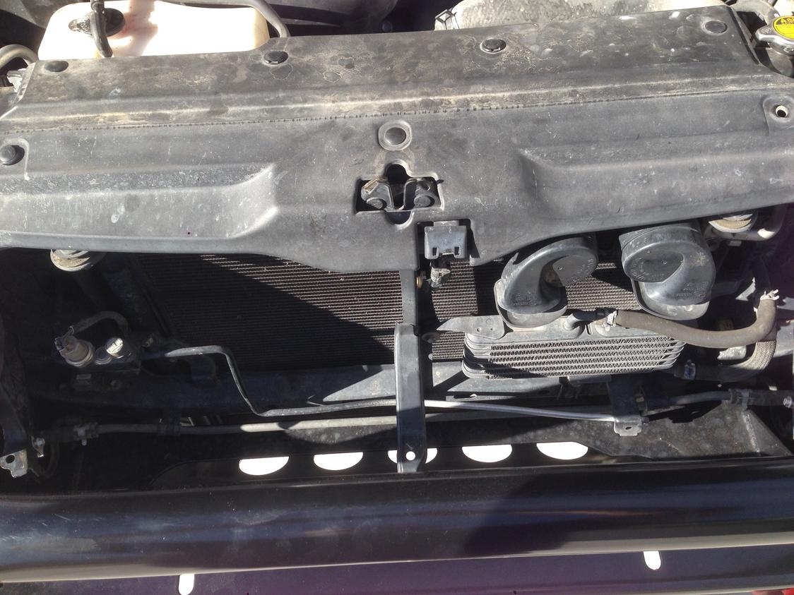

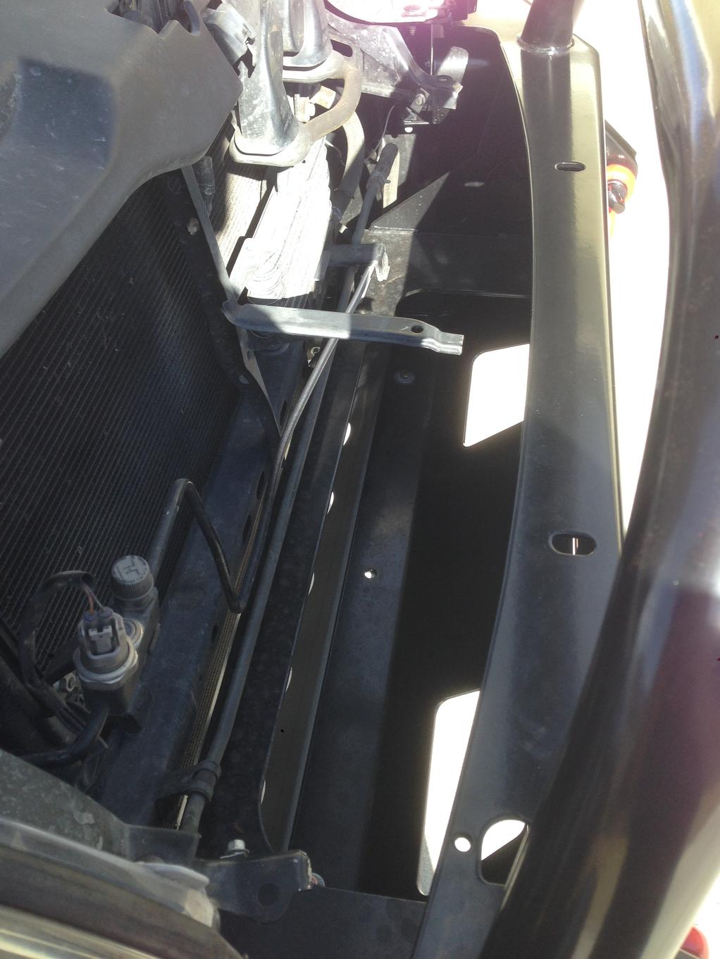

Behind the grille there are 3 brackets. In order for the hood to close you need to cut away the front lip on the left and right bracket.

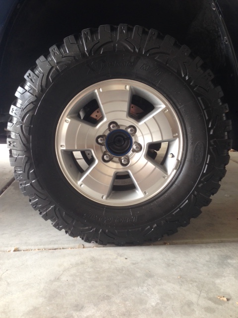

Your truck looks great! I'm thinking to re-do my satoshi to 2005+ as well in a future. What tires and size do you run? Nice looking and beefy tires, but I don't see any markings on sidewall.
Thanks bud. I have Pro Comp MT Extreme 285x70x17
Amazing off road, rock crawling and in the mud but pretty loud on the highway. They wear extremely well.
