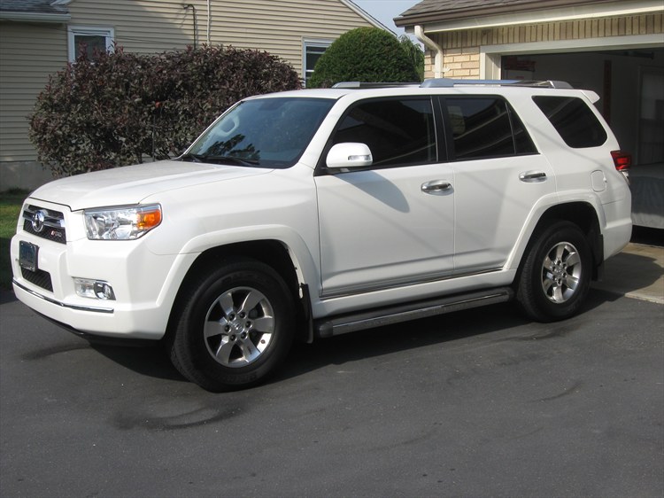

Your truck looks great. In this State(MI) you are asking to be pulled over and having the tint removed. LEO want to be able to see who's driving!
