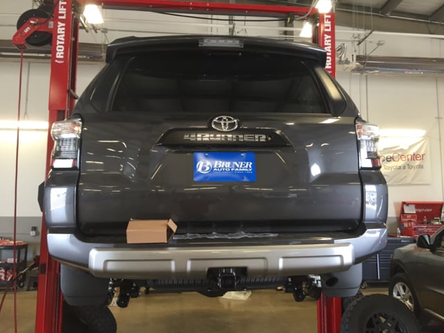

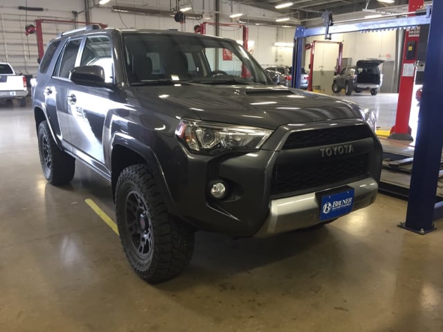

Started with a fresh 2016 T4R w/KDSS then added TRD Pro Shocks, wheels,and grill... Blacked out the badging on back and put on Cooper max tires... Still waiting on trail duty to to deliver my gobi stealth rack and rigid industries light bar(for 11 weeks by the way. They keep telling me next week for the last 4 weeks[emoji107]) any thoughts??
Looks Killer! Are those 275 St Maxx? What did Toyota charge for the suspension install if you don't mind me asking?

Yes 275/70 R 17 MAXX LT.... Well as far as the charge for install I work for a dealership and put some of my own sweat into the install so the cost is skewed it cost me a little over 2k including the kit

The 275s have a slight rub until you take off mud flaps...... 285s would be too big for me at stock ride height

Yes we had to that was the most difficult part. The sway bar is under pressure from hydraulic so keeping it from pushing down and forward take some ingenuity. The back shocks were easy though

Yes we had to that was the most difficult part. The sway bar is under pressure from hydraulic so keeping it from pushing down and forward take some ingenuity. The back shocks were easy though .
I hopped the dealer shop had a secret way of doing it with out removing the KDSS:doh:
