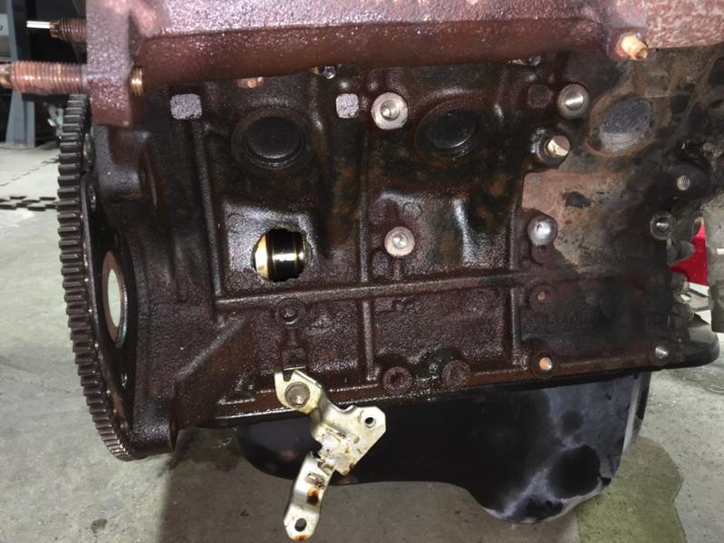

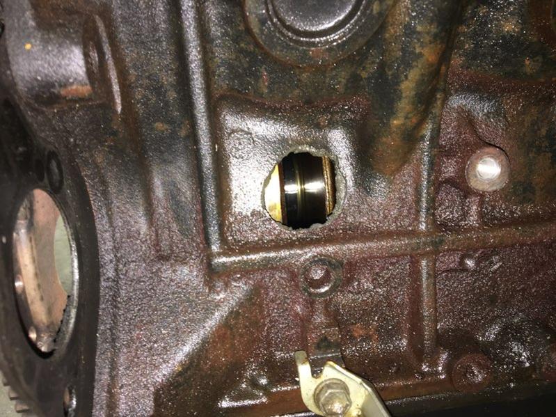

Confirmed it was a rod failure.

Yep, no doubt.
