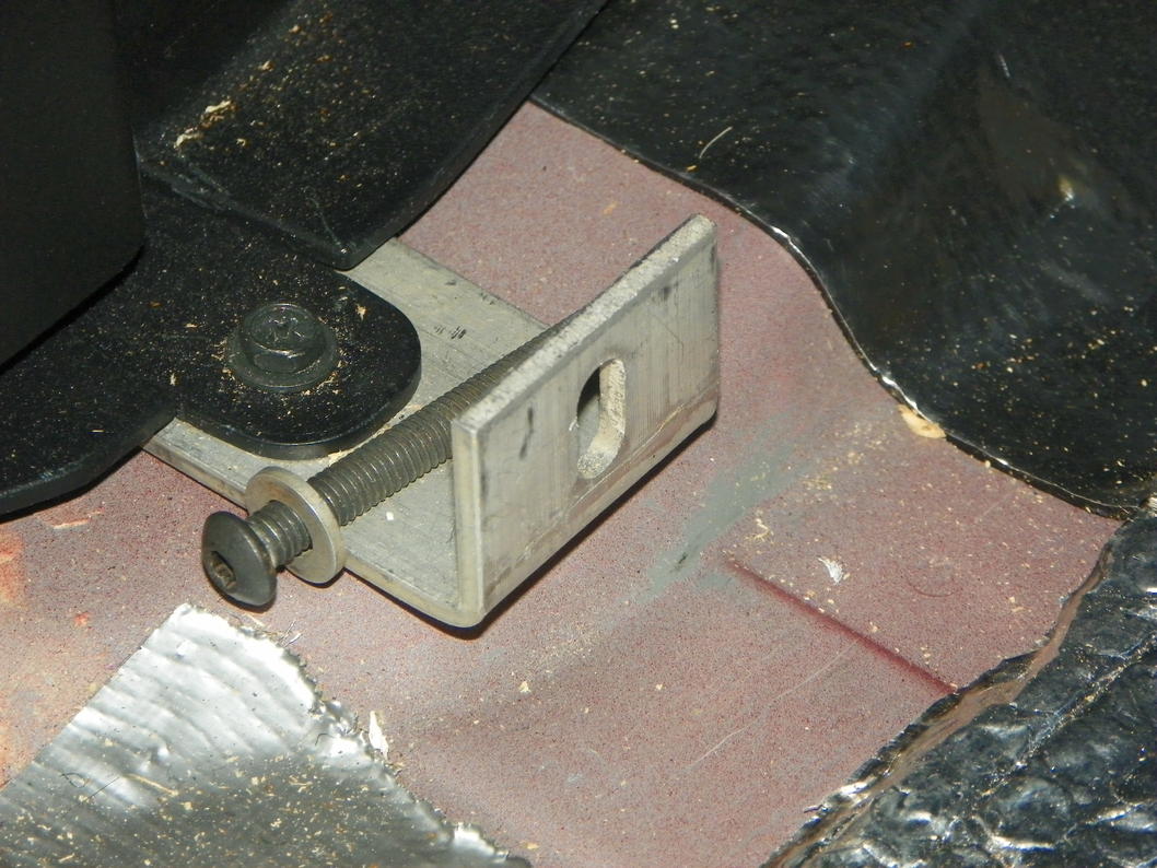

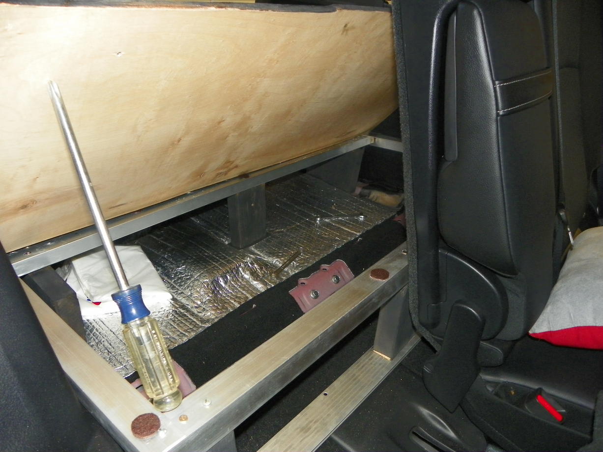

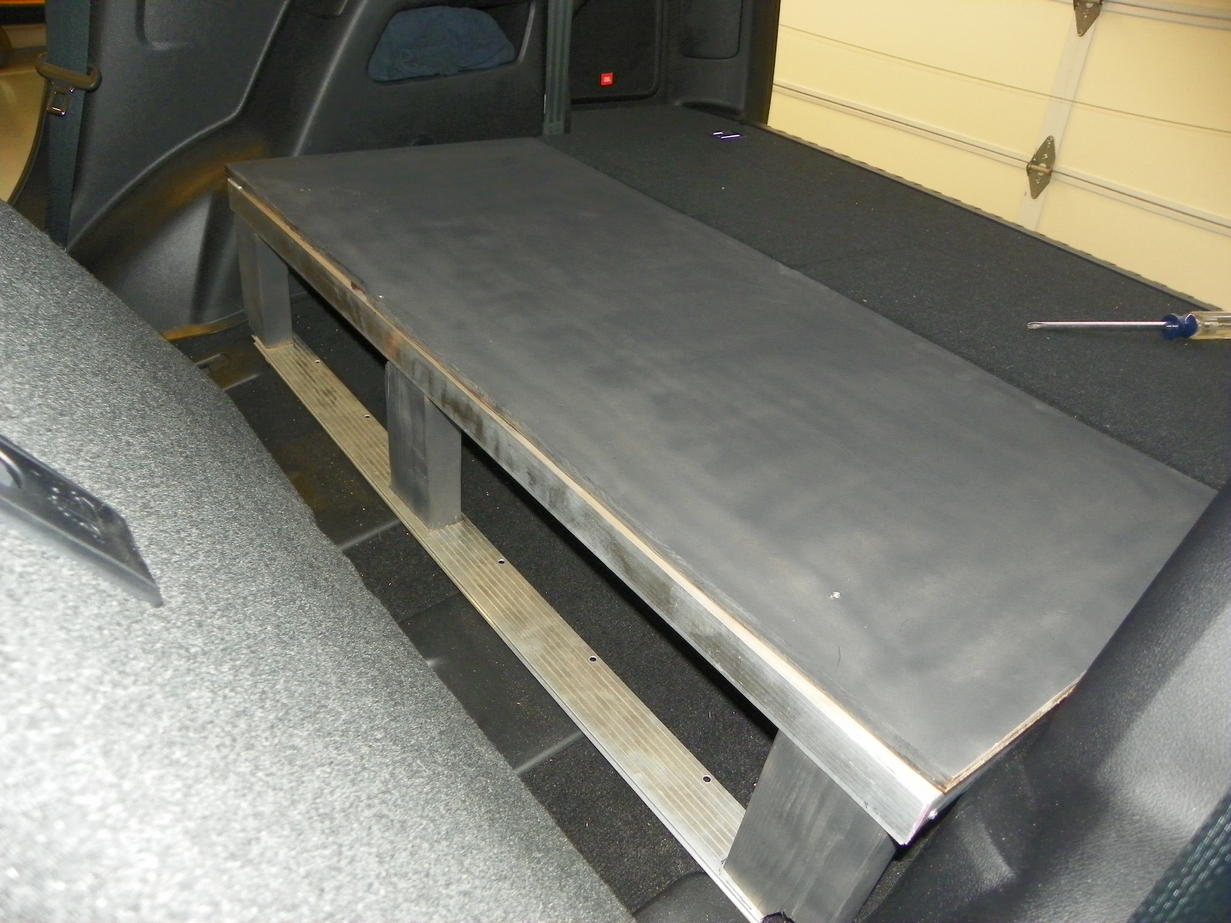

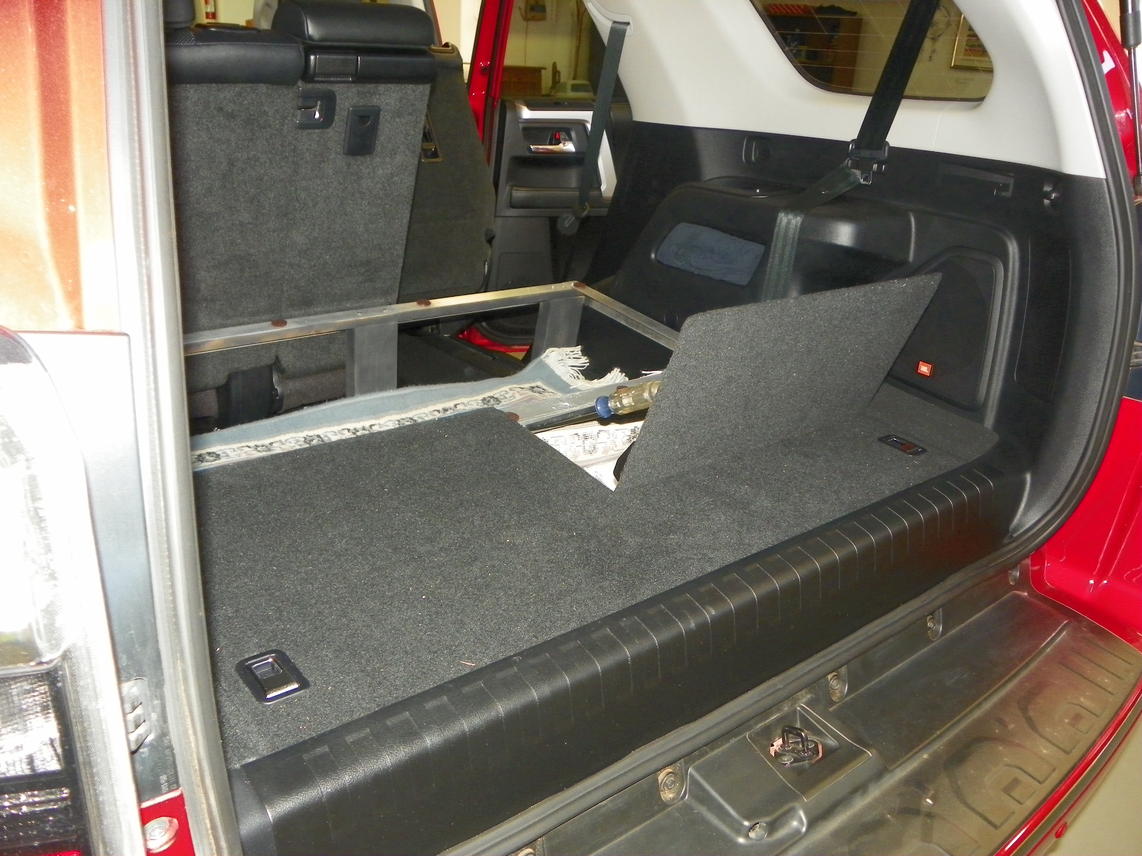

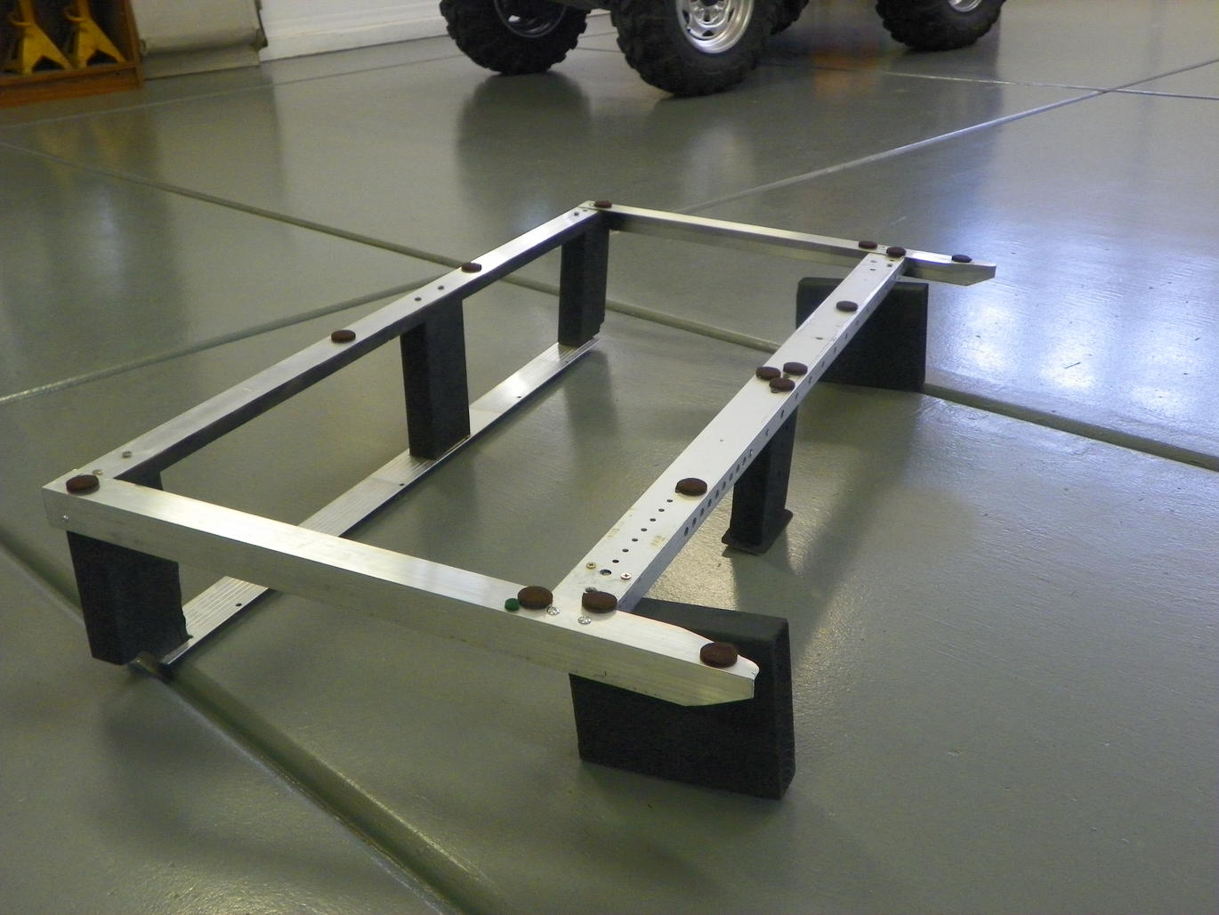

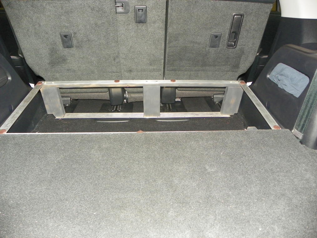

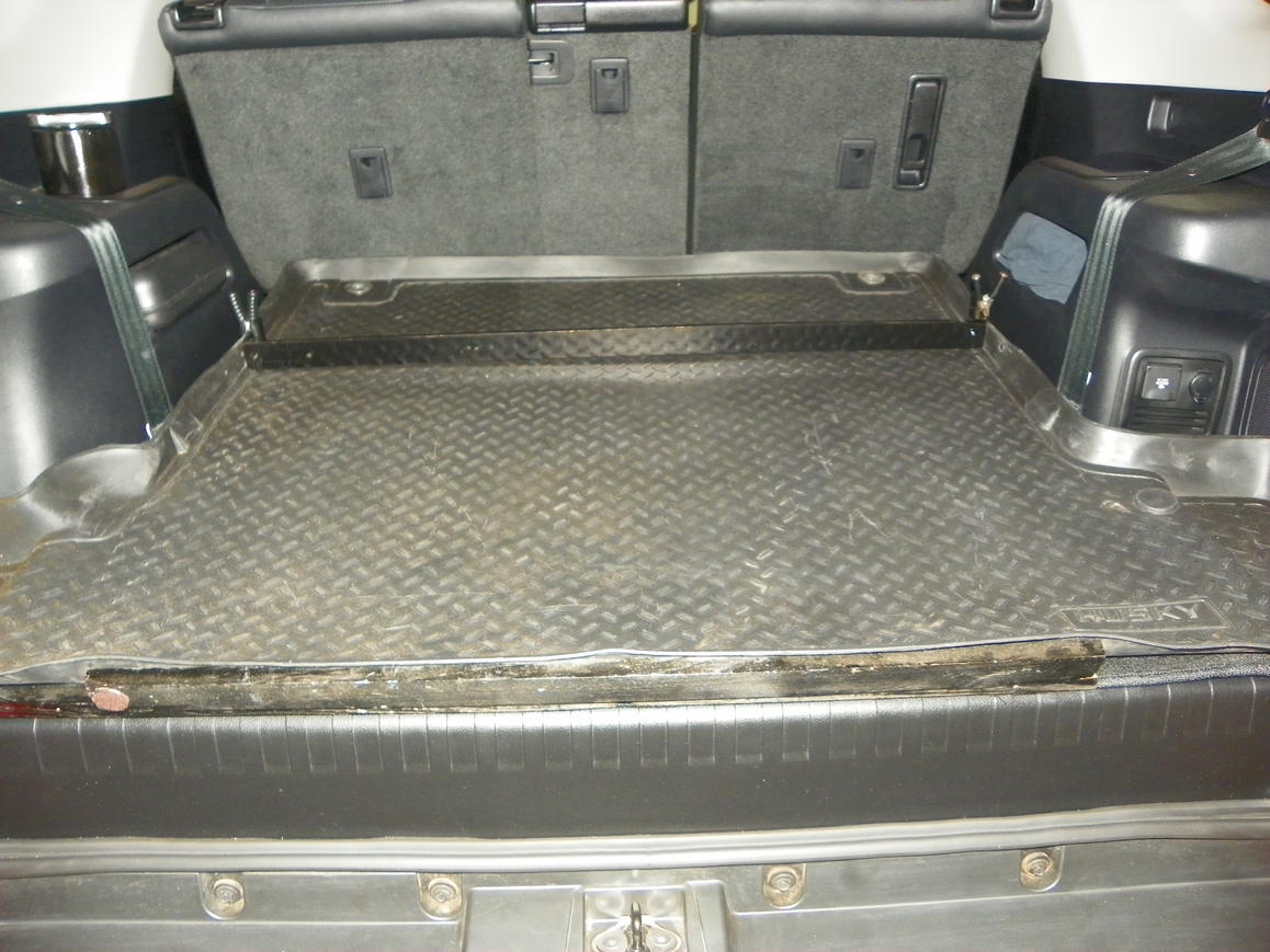

I am new to adding pictures so I hope this turns out ok. I removed my 3rd row seats and made a false floor for increased hidden storage. It also saved 100 lbs. Those seats are heavy. The aluminum angle aluminum and plywood came from Lowes. The whole frame and plywood only weigh 4-5 lbs. and can easily be removed by taking out 2 bolts on the shown bracket. The picture with the huskyliner shows the liner I kept from my 03 to show you can not tell from the outside there is storage under the floor. I did not hinge the plywood so that I can open it from front or rear. Smaller items can be hidden out of site by sliding the 2nd row seat forward and putting them in the front opening.

The black carpet you see on the front part is just what the factory has installed. In the back I just put in some sound deadner material and I found a floor matt for the house laying around that fit the front section pretty good (not shown). If I can find some black carpet at a good price I may finish it off but I am happy with it as is for now. On the top section on top of the plywood I have the factory carpeted mat and my huskyliner on top of that. I also found some Rubbermaid plastic containers that fit real nice to keep things organized and can be removed from the front section behind the 2nd row seats without lifting the top to get to them. This is still kind of a work in progress for me. There are no squeaks or rattles. I have it bolted down with the shown brackets. Under the plywood on the aluminum frame I have felt pads to cushion the plywood.

I do not have the dimensions. If I get a chance I will clear some of the stuff out of the way and measure it.
After the pictures were taken I removed the rear flip up floor sections. They were a pain opening the wrong way. I just cut out plywood panels that I can easily lift one section at a time for access. No hinges at all now.
