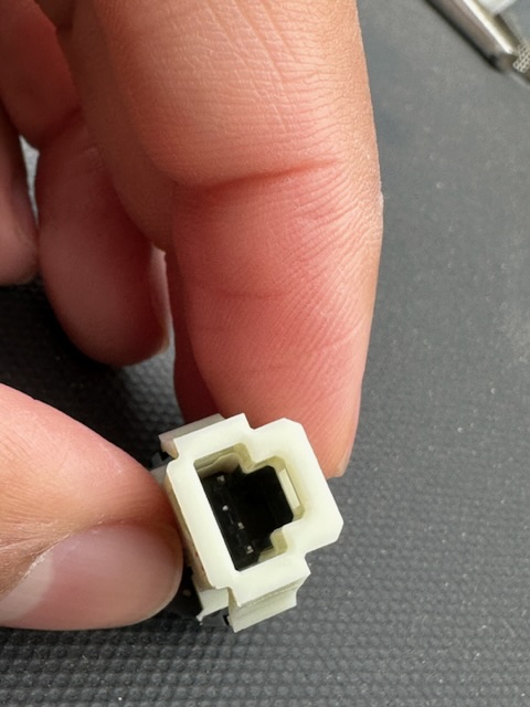

Thanks for your help and here is the link for the sensor purchased on Amazon.Amazon.com: Auto Light Control Sensor 89121-50020 for Lexus Toyota 4Runner Avalon Camry Highlander Land Cruiser RAV4 Sequoia Sienna Tundra Venza : Automotive

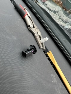

You should read the first few pages at least, pictures are there with an explanation. The entire thread is about this mod only. The sensor is located in the center of the top of your dash. If its daytime and your lights are on, it will keep your dash lights and head unit in day mode, and allows your dash lights and head unit to darken at night with your lights on.

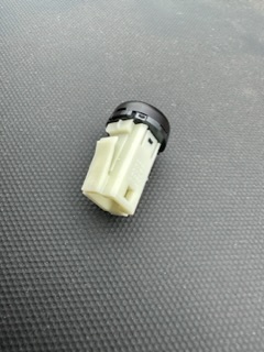

knock off one works fine as well from reading the thread and at $8 worth a try
New Automatic Light Control Sensor for Toyota Camry Corola Lexus 89121-50020 | eBay

I just completed this mod and I'm happy with the way it works in my 22 Sport. I got an 82191-30020 online for $62.50 including shipping from th-motors-jp. It took 5 days to get to me. The one thing I did that varied from the instructions was that I clipped the ears off the sensor so it will be easy to replace. It fit in pretty snug and hasn't moved. I found the instructions in post #55 helpful though my system didn't seem to work exactly the same as described I did manage to set things up with acceptable levels of brightness for both day and night. I did leave the day mode function on because I like the way it works.
