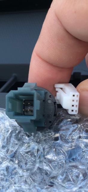

I ordered the ambient light sensor part number 89121-50020 for my 2021 ORP and it did not match the harness. Anyone else with this problem? Thx

I took my 2021 TRD Offroad in for service last Friday and asked how much the sensor would be for this and they stated $196 and they would have to pull the dash, order some special tool, install a harness, and potentially replace the head unit to get this to work. I told them I already have the harness from the factory, but wasn't going to pay $196 for a simple sensor. Found one on ebay for $36 this past weekend, got it today and it works perfectly. Part number 89121-30020

Yes, that’s the correct part. I got one on eBay for $50ish. Shipped from Japan. Took a while to get here. Installed in 5 minutes. Works perfectly. Love it.

It’s the same sensor used on 2020, 2021 Camry. I found one for a 2020 4Runner - easier to search the part for Camry.
