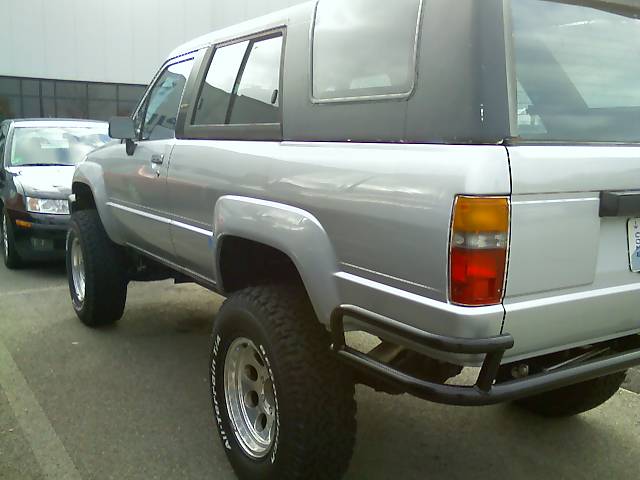

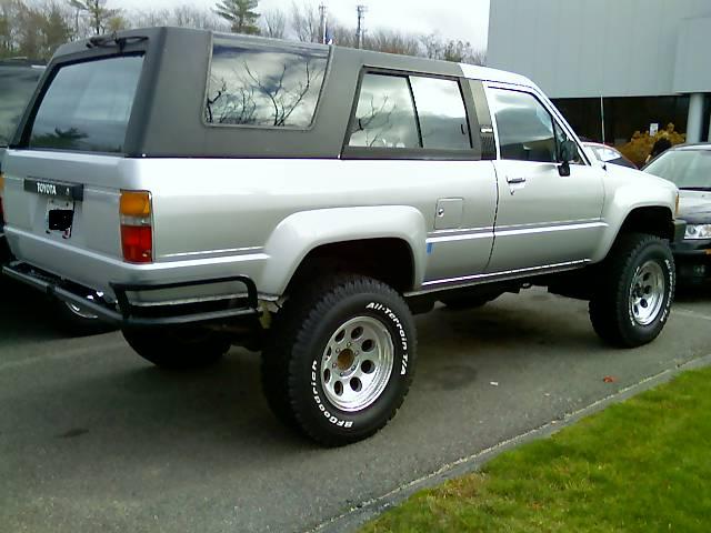

my 87 SR5
04 sc V8
This is my 87 runner. I'm from Rhode Island and I also own a 2004 sport 4x4 V8 with a TRD supercharger, TRD air filter, TRD boost gauge, Borla exhaust, TRD 20" wheels with 295/45R 20 Kumho Ecsta STX tires. Husky liners front to back. I will post pics of this one as soon as I can.
1987 SR5 Centerforce dual friction clutch. Allpro rear bumper. 2-1/2 custom exhaust. Doestech shocks. Poly body mounts and a 2" bodylift.
Nice looking truck. did you do the body lift yourself? if so were there any mods needed other than spacers and longer bolts? I am planning a lift on the same year truck.
Thanks! I have owned this runner for 11 years and done a ton of work to get her to look like this. I am a mechanic and installed the bodylift my self in one 8 hour day. I bought the lift from Downey and it came with everything needed. Longer bolts, washers, brackets etc. I also opted to install all new poly body mounts at the same time. I have no regrets about the lift. I t makes working on the truck a lot easier. I was able to remove my gas gauge sender without removing the tank.
I need to do the sending unit too. Makes it an even better idea. What size tires are you using. I have 31's on mine right now but would like to go to 33's some day. First I need to do the cam and exhaust though.
Thanks I appreciate the compliments guys!
The Tires are 265?70R16, about 32" tall.
My 04 with the SC runs good, it took a little tweaking to get rid of the high gear low RPM pinging. It was worth it though.
