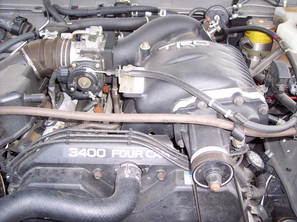

Hey everyone, well at 89,5XX miles I called my mechanic and made the appointment to drop off my 4runner on monday for the service. It's a 2001 Limited, 4X4, with the TRD supercharger installed when it was new. I am the original owner.
Here is a list of the things I made for my mechanic. I welcome any comments you all have if you think I may have overlooked something or, if you think i'm doing something not so necessary.
Timing Belt, Water Pump, and related. This also includes the idler pulley, tensioner, thermostat, cam seals, crank seal, and crank bolt. I have all the parts already!
Replace radiator and heater hoses, flush radiator and new coolant.
Tranny fluid change.
Power steering fluid change - our 4runners take ATF fluid not power steering fluid!
Brake service. Going to see if we can possible squeeze another 10K miles out of the original brakes. If not, new pads, new shoes, new brake fluid.
Front & Rear Differential service, and transfer case too.
I asked him to inspect the charcoal canister and clean with compressed air if necessary, and to clean the breather for the rear differential and also check the breather extension. I picked myself up a pair of rear axle seals so i have them in case i need them in the future but hopefully a good cleaning there will prevent that from happening.
Also, my sway bar has a rust issue, which is the result of that being where the AC drips water on it. So that will have to be fixed up.
No doubt this is a TON of work but hopefully it will not be tooooo bad as I already have all the parts unless something unexpected comes up.
Thanks in advance for any suggestions.
