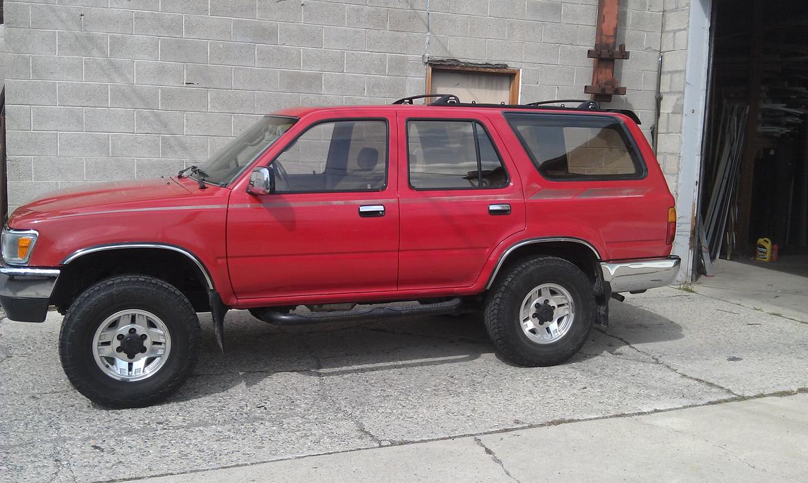

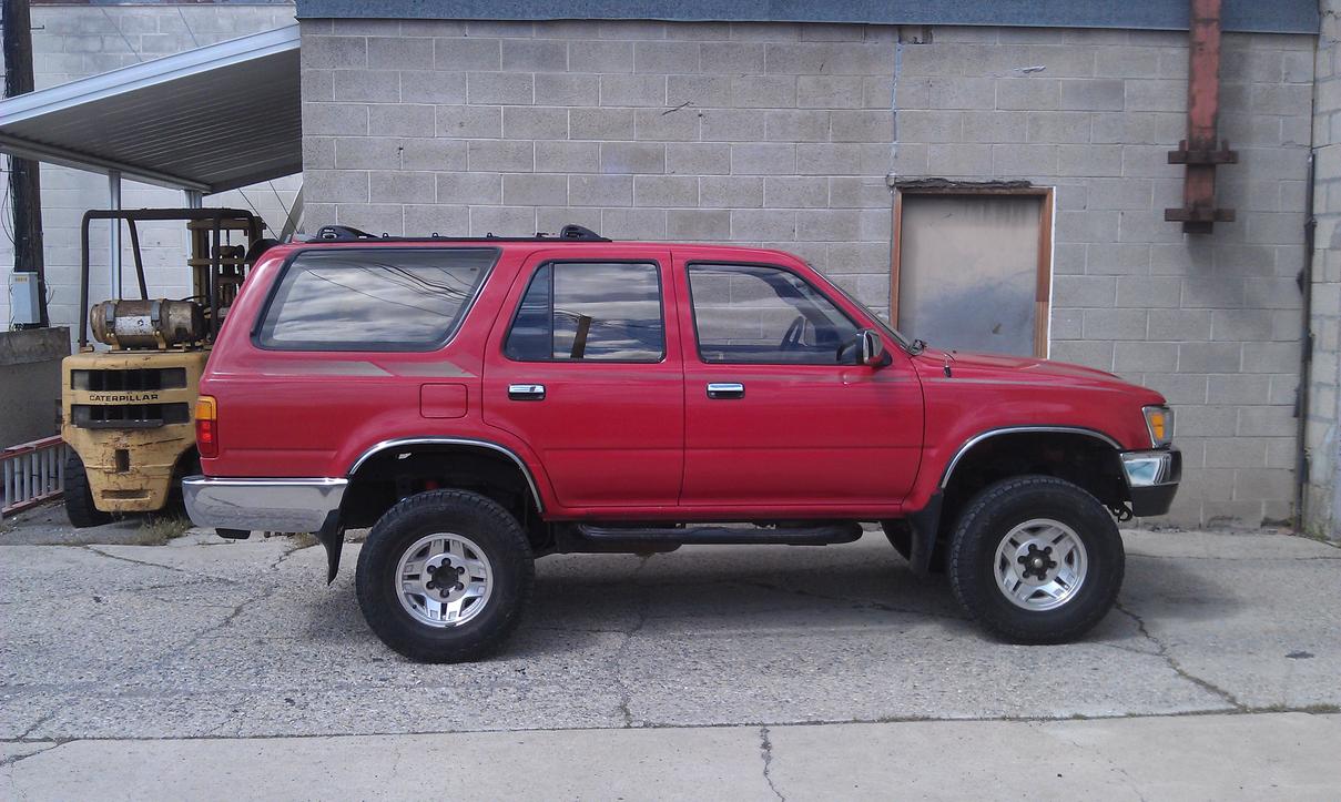

I just put some land cruiser springs on the back and 1.5 in bj spacers up in the front. Trying to get rid of the notorious sag. It sits a little high in the back but I am hoping the springs settle after a bit of driving around. Thanks to this forum I was able to get the info I needed to get this done since I am not a mechanic, just know enough to get me into trouble most of the time. Here is a before and after photo of my truck.

If you got them used they wont settle any more because the Land Cruisers are alot heavier. They look good IMO.
Thanks guys, it seems to look good the more I look at it. I am a huge fan of the 2nd gens, this one is my wifes and I really am thinking I better get me one to build instead of seeing what else I can do to hers. She just wants to drive it. She found a sticker she wants to put on it that says lowriders are for guys who can't get it up. I had to laugh.

I bought some used LC springs from someone on the forum. They lifted the back about 3.5 inches and that is why I went with the 1.5 inch ball joint spacers. I found those from a guy in Arizona in machines parts for classic 4runners. I also had to get a 4 inch panhard drop bracket, and still had to shim the bracket over about 3/8 of an inch to get the axle back inline. Not sure why that was so difficult for me. I am not much of a mechanic. To get the ball joint spacers in you have to grind some of the arm away. I just bought new CV axles and am going to drop the front diff to take some of the angle out of the CV axles. I just picked up some Warn manual hubs too. I bought just sky jacker shocks for the front and rear, I don't know the part numbers off the top of my head but they seem to work good.
The thing that bugs me still is since the ball joint spacers, my steering linkage is messed up. It seems that i need to get a dropped pitman arm and idler arm. There is a lot of play in the tires due to the linkage twisting. I don't know how to explain it really. Makes sense when I look at it. If anyone has suggestions for this, I will listen.

you need to realign it after adding the bj spacers. There is a driveway realignement thread on YotaTech and TTORA.
Oh yeah, I had it aligned by this guy who is a nazi mechanic. Its almost like it needs a dropped pitman arm and something with the idler arm. It drives straight and things, just when it goes over bumps the front tires wobble pretty good.
