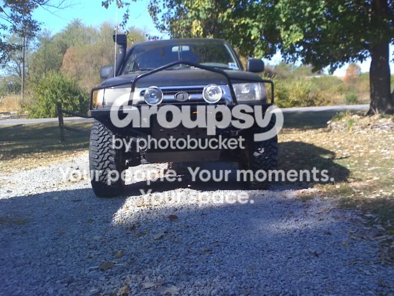

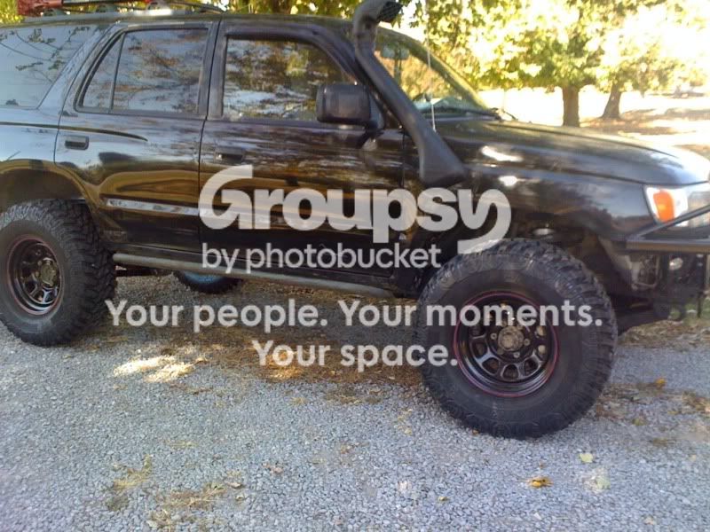

Here we go! I got the 97 back in September! I traded my 98 tacoma Sas for the runner. The list of mods are this
5.29 gears
Cooper Discoverys Stt 285/75/16
Arb locker in the rear
Aussie up front
Mossy rocks sliders
Mossy rocks rear plate bumper
Buds skids
Plated gas skid
Lc header
Toytec coil overs with tundra rated coils
Snorkel
Custom front bumper
1st gen rollbar in the rear
Flow master muffler
Us wheels black

Change out front bumper

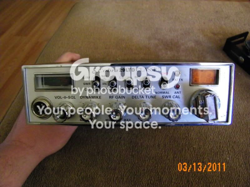

Change out the Cb thats mounted in the ashtray

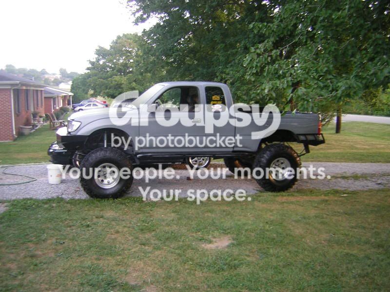

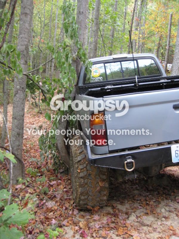

Trade the Taco for this!

I'm sure the Tacoma bumpers from either Marlin or Trail Gear would work with mounting, not sure about body panel interference but I'm sure you could get it to work.

Thanks man! I took me a Lil over a year to build the sas rig!
The tacoma wasn't cutting anymore when the family went wheeling! Not enough room! Chris wanted a Sas and i Needed the room! :bigok:
That aint gonna fit under the radio. I used to have a cobra29, ive tried. The only options for that slot is a uniden 520, cobra 19, or a unit made specially for a 1DIN slot. The uniden and cobra units also fit in the ashtray spot.
WHo said that i cant trim it to fit? I know it ain't gonna be a drop in by no means! I had a buddy install one in his tacoma. Well it wasn't a cobra but its the same size!
Unless your saying it's to long! Also thought about mounting it on the passenger side between the airbag and glove box. Or under the glovebox by the radio cluster. What do you think?
Take a look at my old build thread (link in my sig). I had my cobra29 mounted on the side of the center console. With my uniden, i just mounted it in the ashtray spot. No pics up yet on that thread. If you search the thread "cb radio in 3rd gen" there are lots of ideas. My ashtray pic is on the last page of that thread.

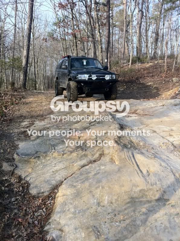

Welp i blew the diff the other day! So its time to regear the rear and change out the ARB for a Detroit! Pulled the diff and found out that there was 10 teeth missing
The new Diff is in and the old is out! Ok time to get some wheeling in and move on to the next update or mod on my wonderful list of things to do.:whipping2
