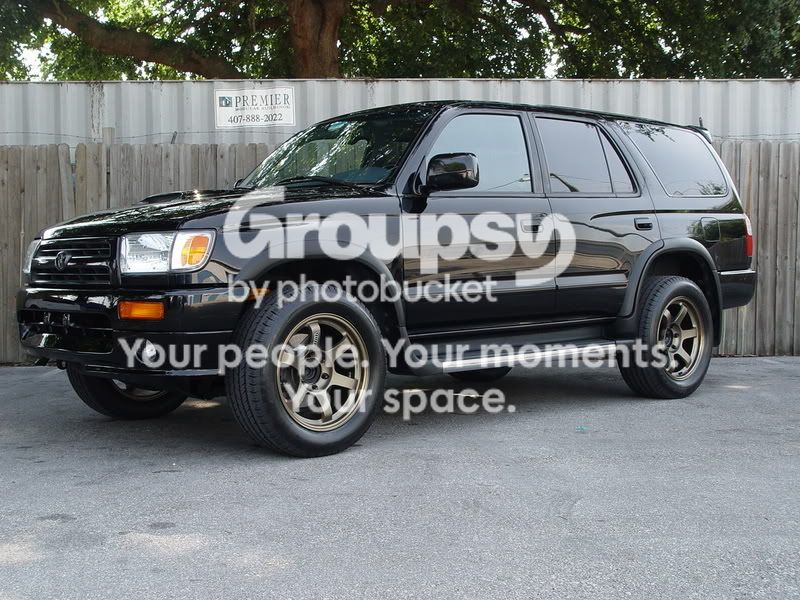

My '99 Urban 4Runner...
2jzmk3
1999 4Runner SR5 Highlander 2wd
3.4L V6
4-speed
Leather
Sunroof
(Scroll down for pictures)
EXTERIOR
OEM functional scooped hood
18in Volk TE37 Gloss Black
Michelin 275/65/18 Latitude
Hilux Surf clear corners
Black Anodized OEM emblems
JAOS Rear Wing
96 bumper w/PP lower valance
Bushwacker fender flares (color matched)
All Bumpers and Trim Color matched
Removed Sidesteps and roof racks
SUSPENSION
Bilstein HD's
Addco sway bars
4wd springs
STEERING
Polyurethane steering rack bushings
BRAKING
Powerslot front rotors
TRD Friction pads
INTERIOR
Kenwood Navigation DVD/TV
Kicker Dual 12in
Kicker 1000w Sub Amp
Kicker 300w 4chnl mids and highs
Hertz 5 1/4in components in all doors
Hornblasters Trainhorn 1.5lb tank
TRD boost gauge
2x 6.1in screens in both headrests (for my kids)
PERFORMANCE
TRD supercharger
URD 2.1 pulley
Flex-a-lite fans
Edlbrock headers (ported, HPC, wrapped)
Custom test pipe
Custom "hidden" Exhaust
URD O2 simuiator
TRD thermo 170 degree
308cc injectors
Walbro 190lph fuel pump
NGK 2-step colder plugs
NGK plug wires
URD/Splitsec FTC
URD Speed Unlimiter
IPT Valvebody
B&M trans. cooler (-6 A/N Lines)
Trutrac w/4.88 gears
Bored and tapered throttle body
Custom Intake Box
93 Toyota Supra MAF
HKS DLI
Optima Red top
8 Ground straps added
331whp 345tq @ 11psi
I'm sure there is more, just cant think of it right now.
