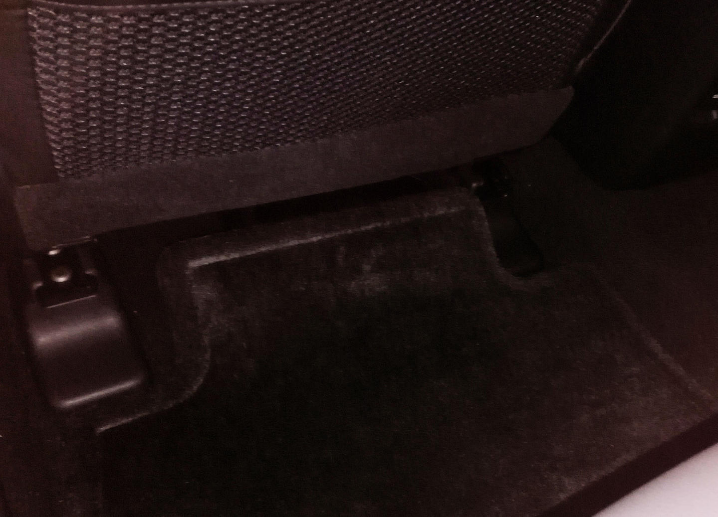

1st picture is floor mat cover the rear of the amp.

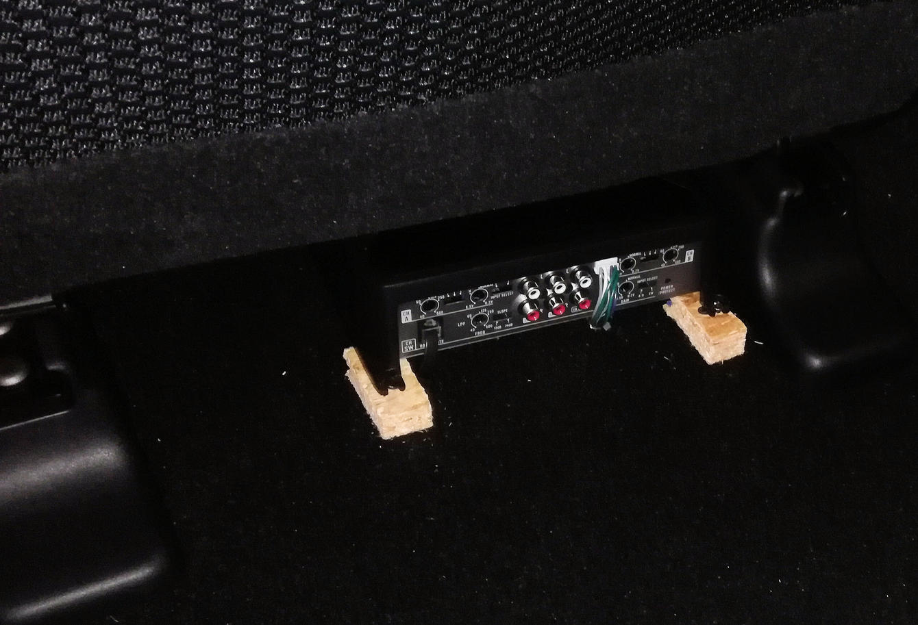

2nd picture is floor mat removed exposing the rear of the amp.

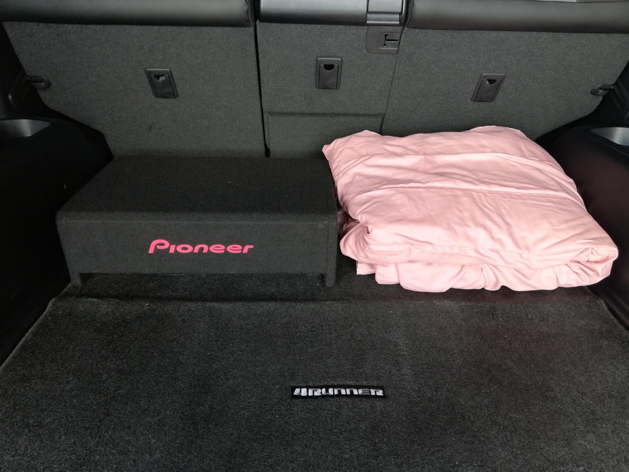

3rd picture is sub-woofer & emergency blanket .
