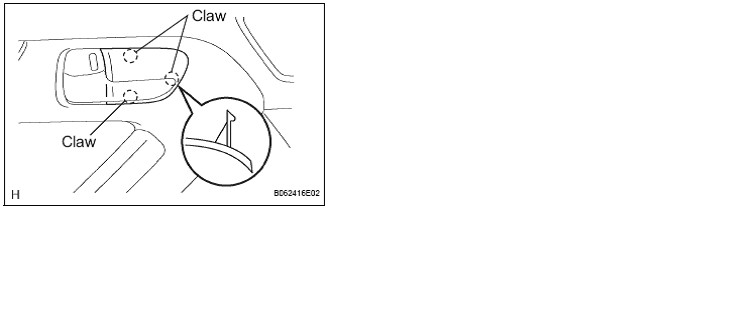

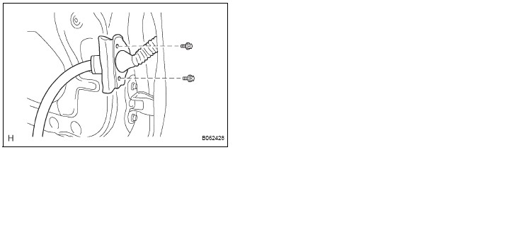

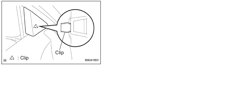

Here's the door removal pics from the toyota manual.

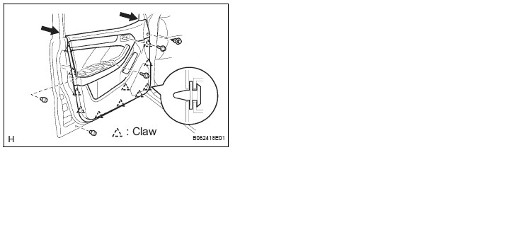

Unscrew these 2 screws and pop one plastic snap-like thing then pull off the door with all your might.

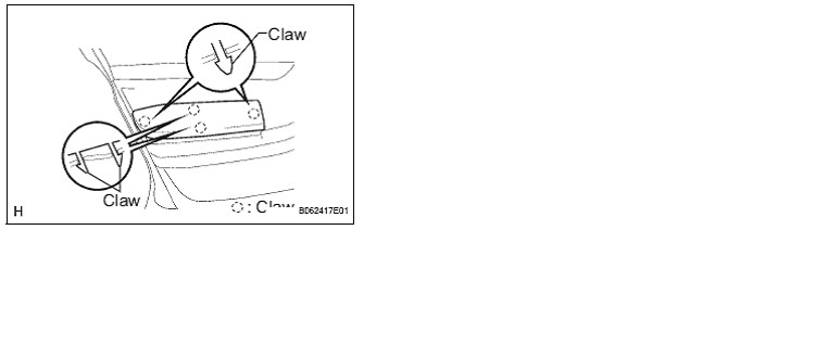

Finally, you can unscrew this piece if you want to run wire through the door to the cabin. I haven't done this yet but will when I run the tweeter wire.
I haven't figured out where to install the amp and crossovers. I was thinking about putting them under the seat, but not 100% sure. Same with the cross over. Not really sure where to put them. I saw a post with them in the door but I'm not convinced that mine will fit. Maybe there's room under the steering wheel.

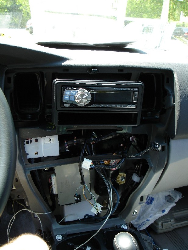

I got the headunit in. Pics to follow. Then I removed the driver's seat to install my amp for the from door speakers....

Here's the headunit at least

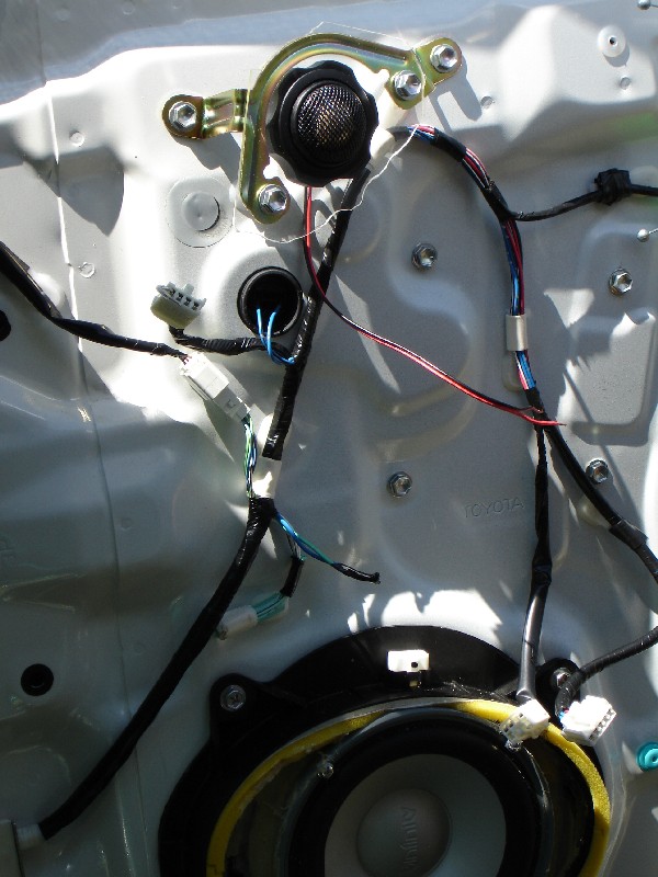

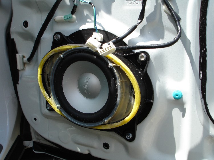

Here's my door speaker replaced. I used the original speaker spacer. I ripped out the paper OEM speaker and created a Plexiglas plate to cover where the old speaker was. Then I cut a hole in the Plexiglas for the new speaker and glued it all together.
Infinity Perfects that I took out of my old car. They fit fwiw. I did have to cut the door panel plastic about 1/2 inch to allow it to properly snap back in place. No biggie since noone will see it.

I did the same basic thing with the tweeter. I had hoped to put the tweeter closer to the midrange but I couldn't think of a good way to do it without cutting the door panel. I used the Plexiglas scraps to creater the tweeter mount as you can see. If you've done this install recently you will notice that I put the wrong tweeter mount on the door and it's also upside down. I was forced to make it right when the door panel didn't fit back on lol. :p
