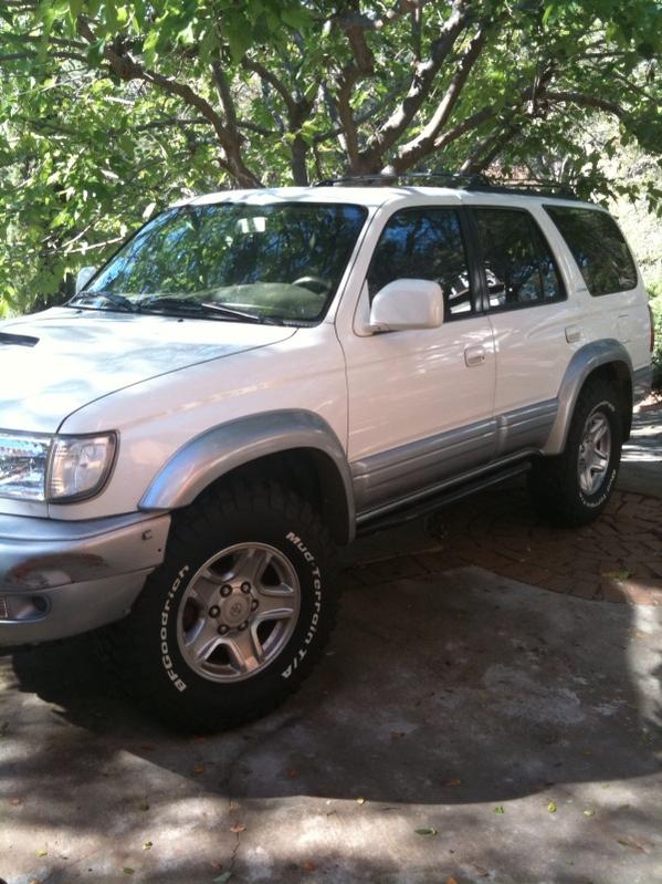

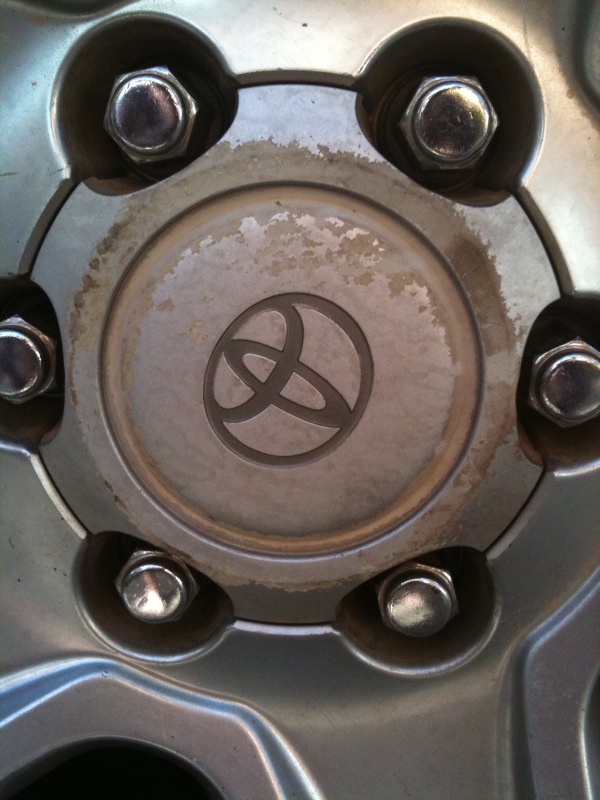

also i wanted to paint my rims, but im not sure if its a waste of time.
there kind of chiped. let me know what you guys think

On my center caps, I went to an auto parts store and they let me take out a few cans of paint to try to match up the color. I don't remember the exact color or who made it and have thrown the can away since then.....but it worked well and seems to match well. I think there's some threads about it on here too.
**EDIT: I do still have the rattle can....it's Duplicolor Truck, Van, & SUV paint in T178 Silver. I also didn't worry with re-painting the toyota symbol yet.
DSCI1277.jpg~original
From a little farther away:
DSCI1271.jpg~original
