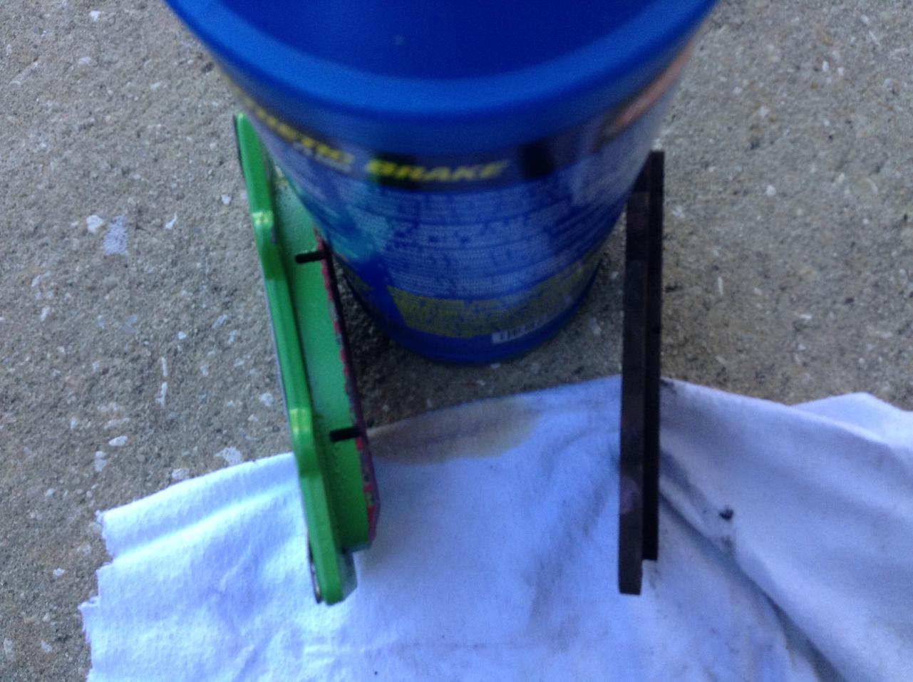

I live in the sunshine state and have had no trouble with my calipers seizing. Recently replaced the pads all the way around at about the 90k mark. I never engine brake, but the original pads were due to be changed. The original rotors were fine. Check it out.

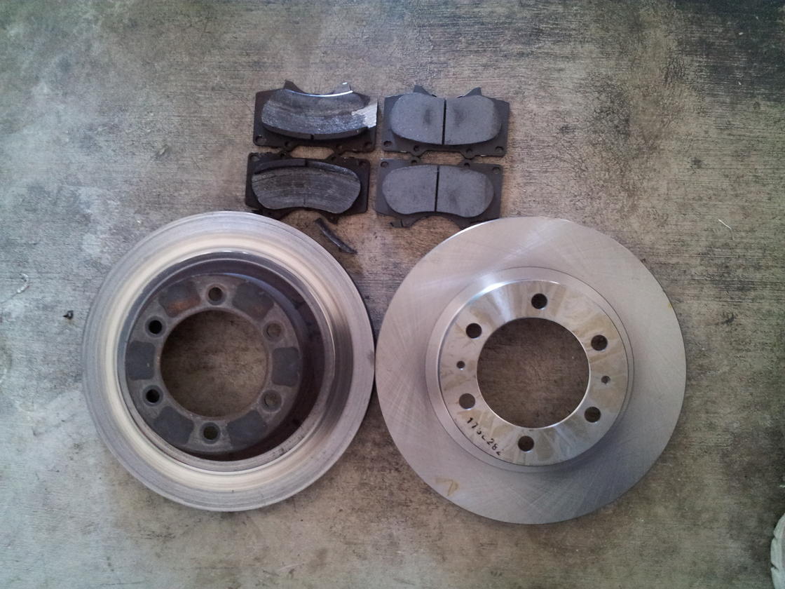

On my 4th set of rotors and pads at about 300k. I wore em down to the backing. Auto zone lifetime replacement has been good to me haha.
Wow. Those rotors on the left were for 16" wheels. Your pads were not working properly the whole time. Looks like the rotors on the right are the proper ones. Your pads should last longer too.
Those rotors are exactly the same left and right. One is old and worn out, one is shiny new.
Most of the SR5's have the smaller rotors that will fit 16" wheels. That does not mean they are incorrect. Many SR5's came with preferred equipment packages that included the typical 17" SR5 wheels.
The first time I ever replaced the rotors and pads I went to auto zone and said I had a sr5 with 17" rims and they gave me the 13" brake rotors. Went to assemble and got em together but they would not spin at all. Then found out some came with the 12" rotors and never had a problem since, except stopping power is a little short especially when towing.
So, you are saying that if you put the rotors together, face to face, old and new, that they are the same diameter?? The way your pads are worn, with the top 1/4" or so not doing anything or worn down, that the old rotors are the wrong size for the vehicle.
agreed. the pads shouldn't have that much overhang on the rotor.
those parts are not matched correctly.
hopefully the new parts were are correct.
