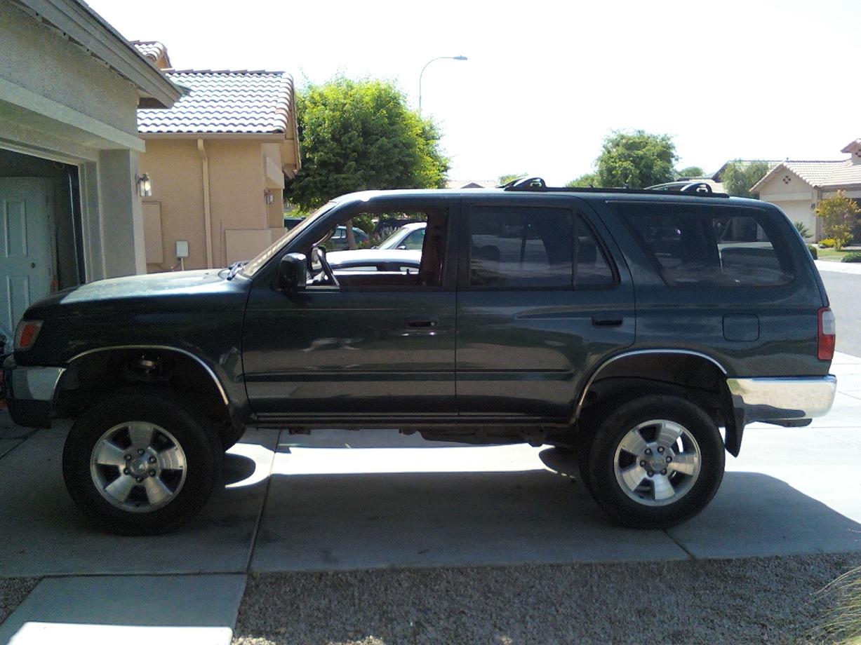

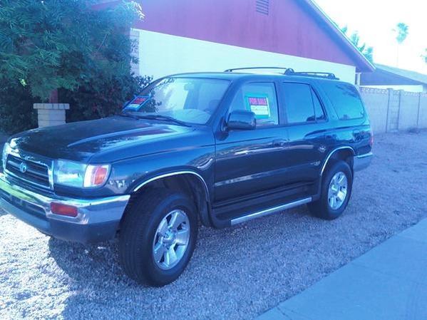

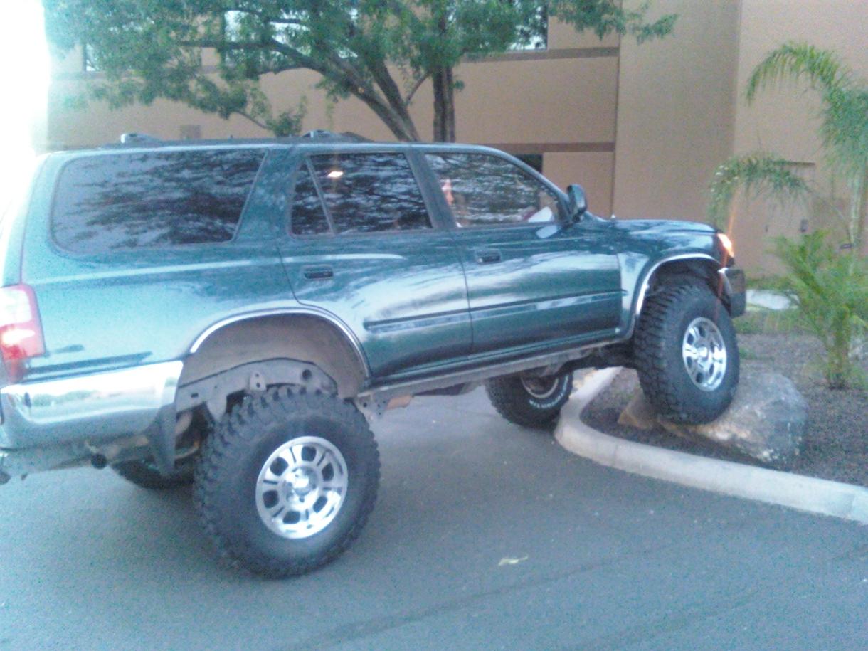

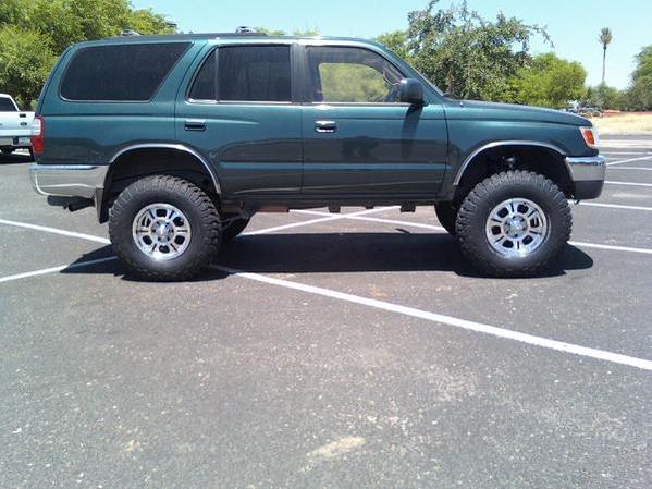

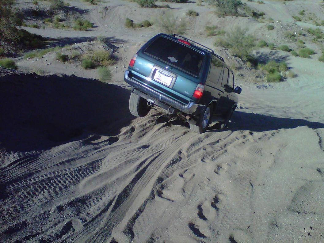

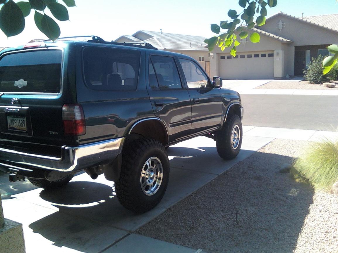

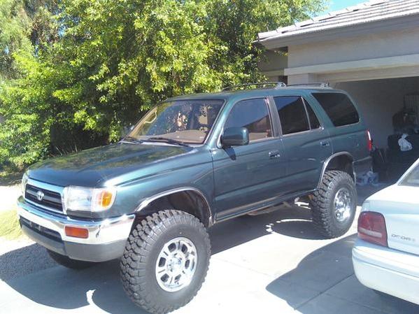

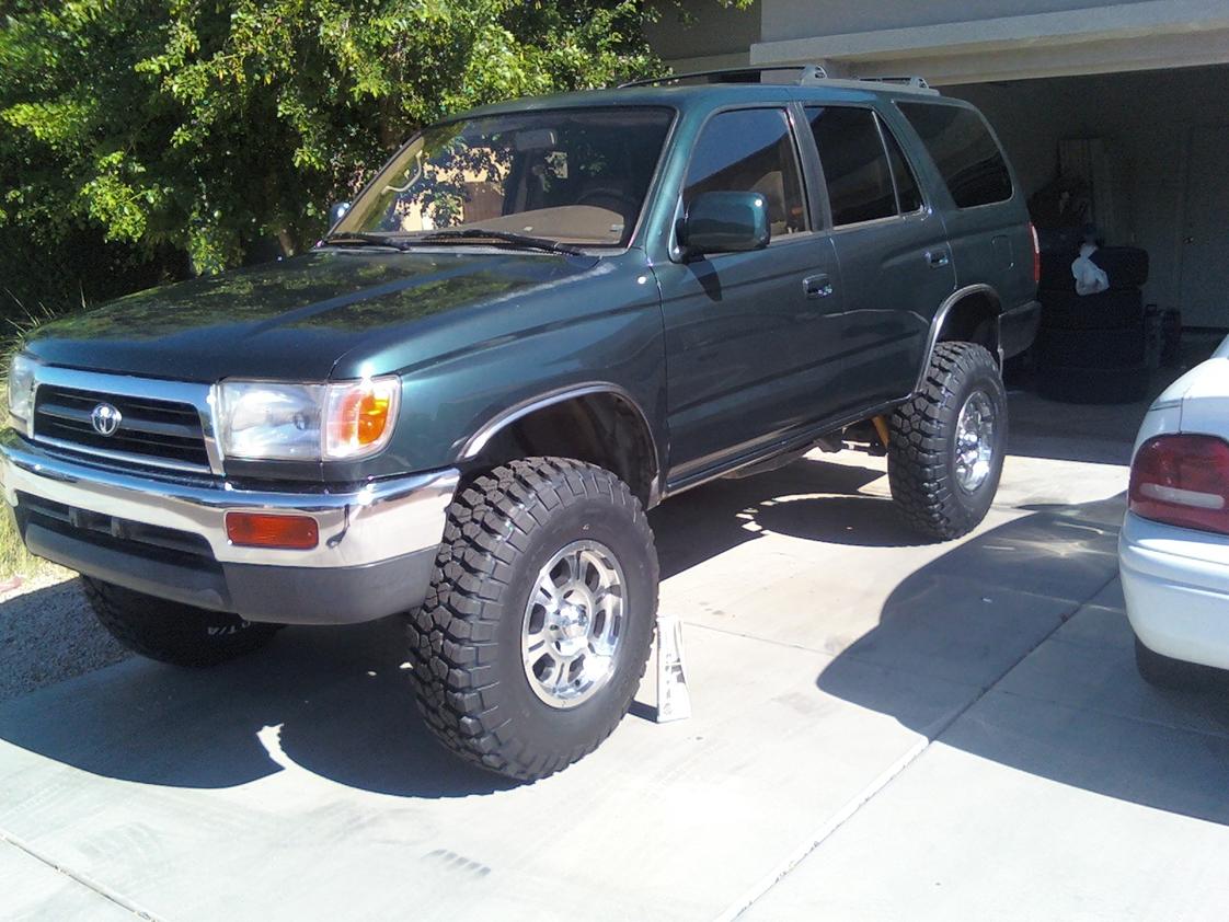

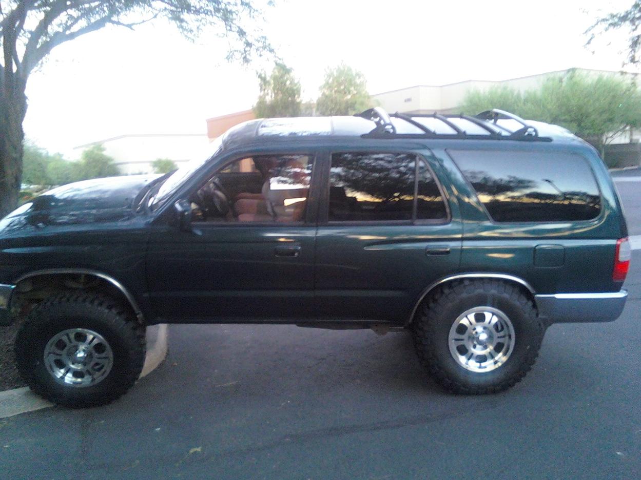

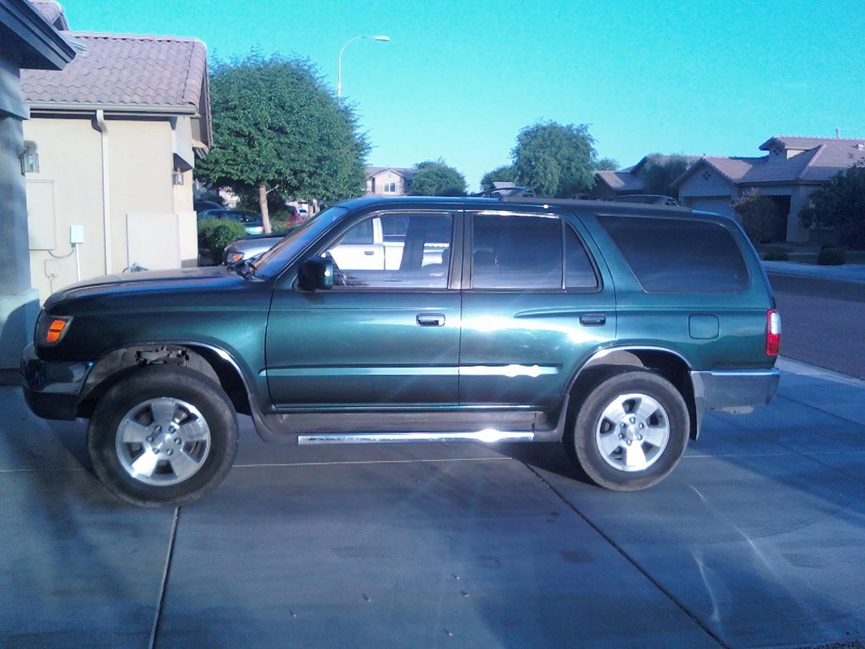

ok so the first pic is of it when i bought it siding in some one yard it is a 96 4x4 sr5 with rear locker i got it for 4500 and it had a little over 115k on it nothing for a yota. the fourth pic is when i had my ome 891 look at the stance i did not like it one bit i got 3'' out of my toytec CO but only like 2 out of the OME coil so they go sold. 5th pic is wheels and tires with 250 pound in the rear, the coild are 9 wrap LC love them. the pic with the Newpaper by the front tire shows some size comparison that news paper is exactly 1 for tall. I hope you engoy i have more coming soon. Oh also current set up is Toytec CO with diff drop, LC 9 wraps, SS adjustable trac bar and rear brake line OME rear shocks i dont know how these are going to work out so they may be for sale soon. MB predator wheel 16x8 with -6 offset Bfg 255/85r16 i may go 33x12.50x16 next time since there is about an 1 to 1 1/2 inches in between the tires and coil over

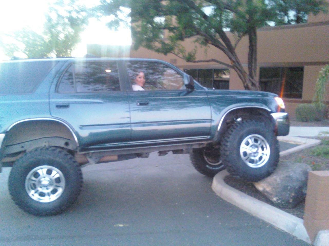

Nice, where was that one pic with your wheel in the air taken at? I just got my 97 and been looking where to do some mild off roading (still stock). Going to be making a trip to Sanoran Steel to get the 7.2 kit soon. I'm in Goodyear.
Spish im just up the road from you, where this was taken is actually really close it off of I10 and watson road. I am going to be taking it to sedona on the 5th and running as many trails as i can up there. If you need help with the install on that kit let me know i can probably do a rear in about an hour since i have done it twice. Also i have a co worker that has the 1.2 and i will take a pic next to it this week
Spish im just up the road from you, where this was taken is actually really close it off of I10 and watson road. I am going to be taking it to sedona on the 5th and running as many trails as i can up there. If you need help with the install on that kit let me know i can probably do a rear in about and hours since i have done it twice. Also i have a co worker that has the 1.2 and i will take a pic next to it this week
I used to ride my quad out there, I'll have to go check it out. Have fun in Sedona.

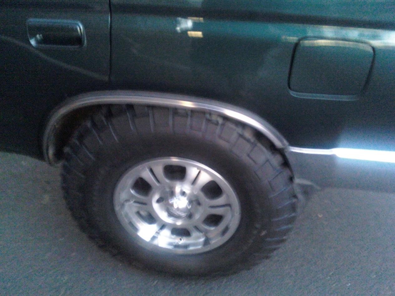

so i did some urban wheeling yesterday to get to test some flex and all i can say is i got some rubbing issues to take care of. hope you enjoy
