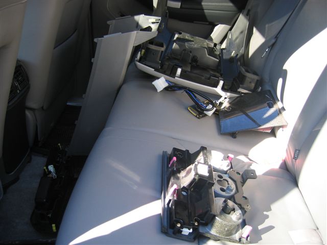

I followed the "how to take apart your dash". It was pretty straightforward. I think all screws that are removed are 10mm. I used a screwdriver that you can put "bits" on. This solves the wrench problem and wratchet fit issues.

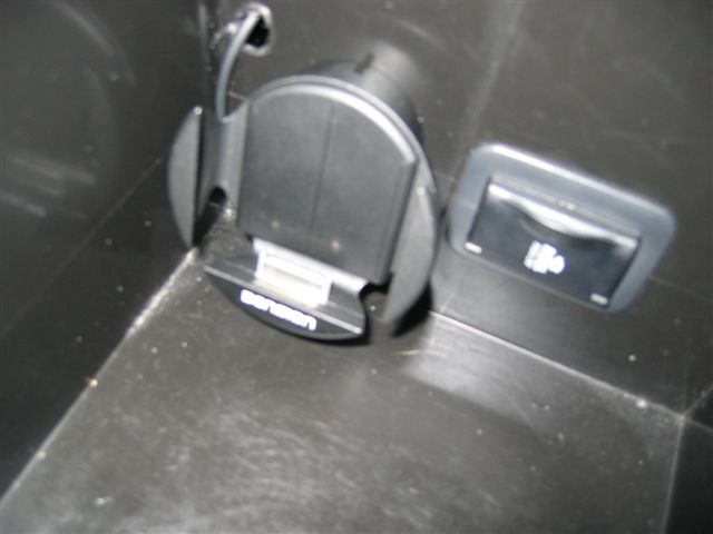

I ran the cable from the icelink to the center storage. Drilled an ugly hole (that no one will ever really see) and mounted the dension cradle there. The mod is completely invisible. I get in, open the consol, drop in the nano and hit the road.
Since everything is out of sight, I don't mind occasionally leaving the nano in the vehicle.

1) I forgot to replace 2/4 of the HU screws. Rats. I'll have to do that later at some point.

-The dension cradle is not appealing. The anchor/adjuster pin was very very difficult to get in line for the "adjuster" pin on the base.
