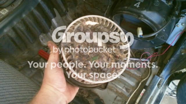

I seem to always get mice in my fan if my truck sits for too long.
110_0162.jpg~original
ew.

Yeah, if you're lucky the nest will only be in you blower motor, they usually find their little way into the condenser and/or heater core as well in my experience though.
lol nice air filter.
