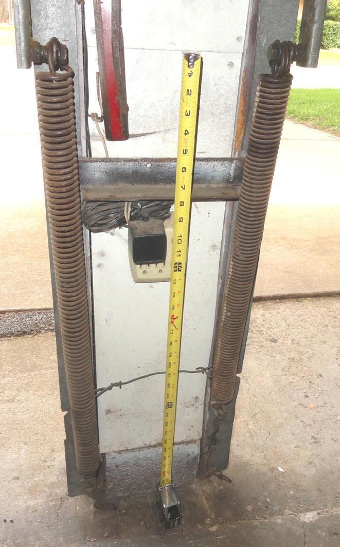

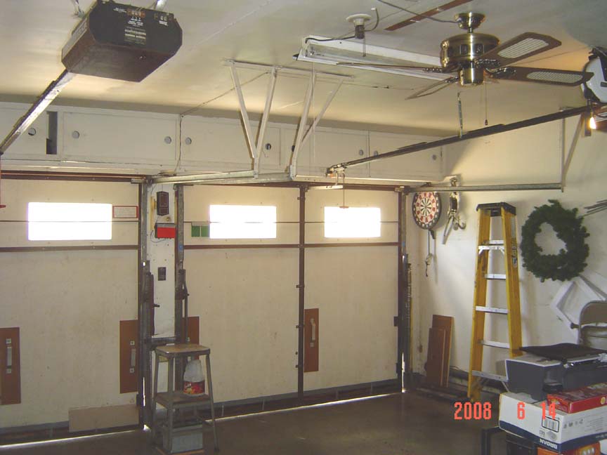

I like your garage doors if they are solid panels pivoting up on arms pulled down by 24” or 30” springs. Our 1969 built homes had those types of doors but most have been converted to Rolling Panels in vertical tracks. I still have my rebuilt old style (attached) but springs are no longer sold in this area for the door. Do you know of a source online for these springs?A Tech told me the doors are still used in CA due to no snow to restrict the door from opening, In North TX since 1973 I have had to move snow 2-3” deep X 6” wide to allow the doors to pivot 2-3 times.
Bottom Line! I rebuilt the doors with 1/8”X1.5” angle iron frames with 3/8” ply to replace the Builder’s Grade. A Grade a Garage Door Opener would damage vs reversing (from force if the door met resistance). Topped off the project by adding overhead storage above the doors (that has been ideal) other doors w/n allow.

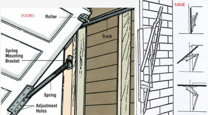

Thanks for the reply. Something must be different about our doors. Your all wood should be heavier. Our local Home Depot carried the correct length but not the correct weight class. Plus, they were designed to pull overhead vs down toward the floor.
Looking closer, I see two arms appearing attached to your “one door” on “one side”. I have one arm, “one arm on each side” lifting the bottom as the top is supported in a track parallel to the ceiling. Do you have tracks in your ceilings?
I do have 5 extra used springs (24” as what broke vs 30” stronger) and only one spring broke last summer since moving in 1973.
