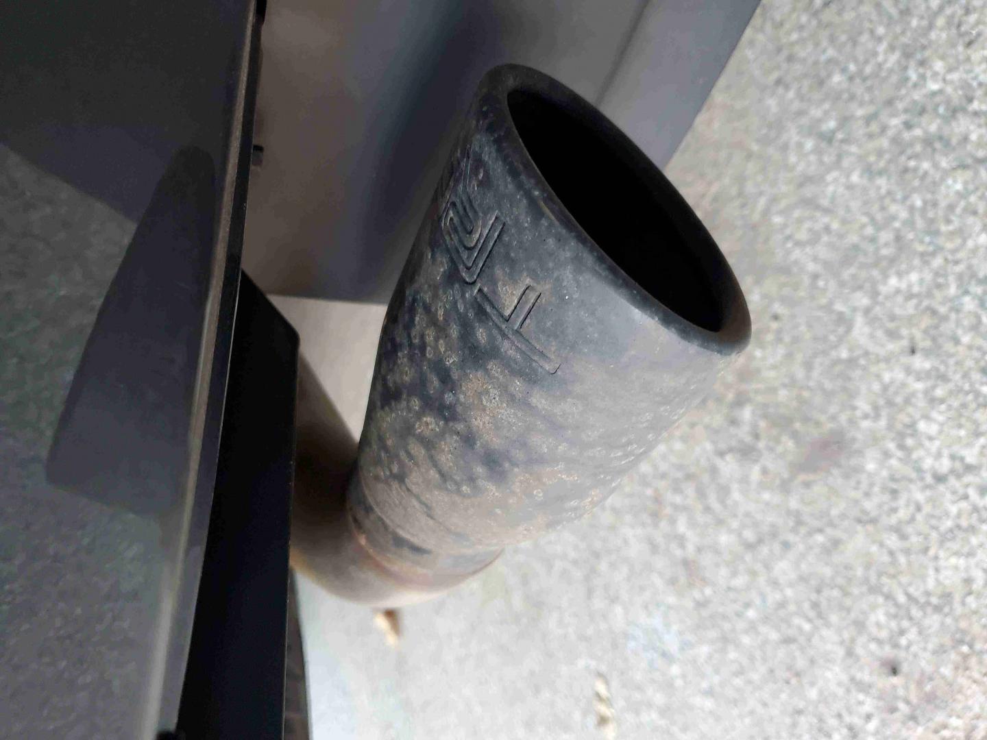

Wow thanks you guys for this feedback. I am surprised to learn about how week the 2.0 is. I will need to keep researching. Again, I was really driven towards the Toytec option first because of the aluminum. Our road salt in MN is awful. Just look at what happened to my TRD exhaust after a couple months this winter. I was hooked on the Bilstein 5100 for all 4 corners prior to ToyTec (I actually thought Toytec used Bilsteins in their coilovers). Welp, anymore feedback or opinions would be great. Thanks again guys.
