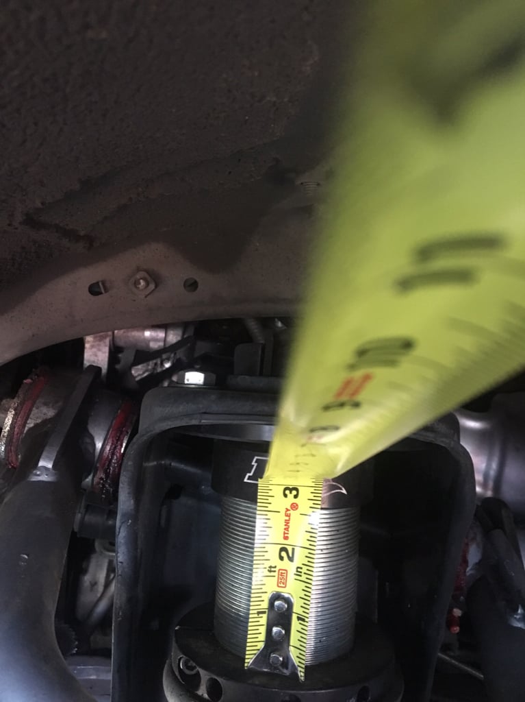

I've got Fox 2.5 CO's in the front with 2.5" of thread showing. I'm trying to determine if this is my actual lift height or something else. Anyone know the actual lift height with that amount of thread showing?

What are your front and rear height measurements?
That is quite a bit of preload on the front coilovers. To get rid of the reverse rake, you can lower the front down some (decreasing the amount of preload), in conjunction with a higher lift rear spring.
take some measurements from the center of the hub (or ground but include tire size) to the bottom of your fender flares and we can begin to get an idea of how much lift you have. Like it was said you've got those coils preloaded quite a bit, but we also don't know what kind of weight you're running or what your coils are rated at.

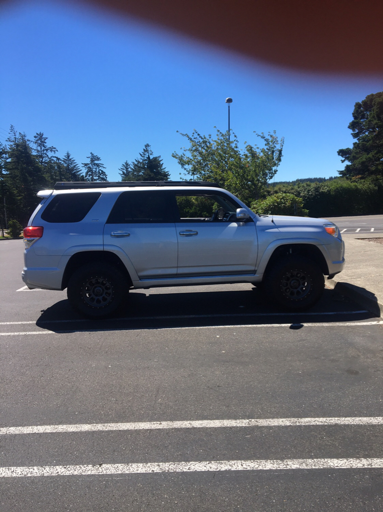

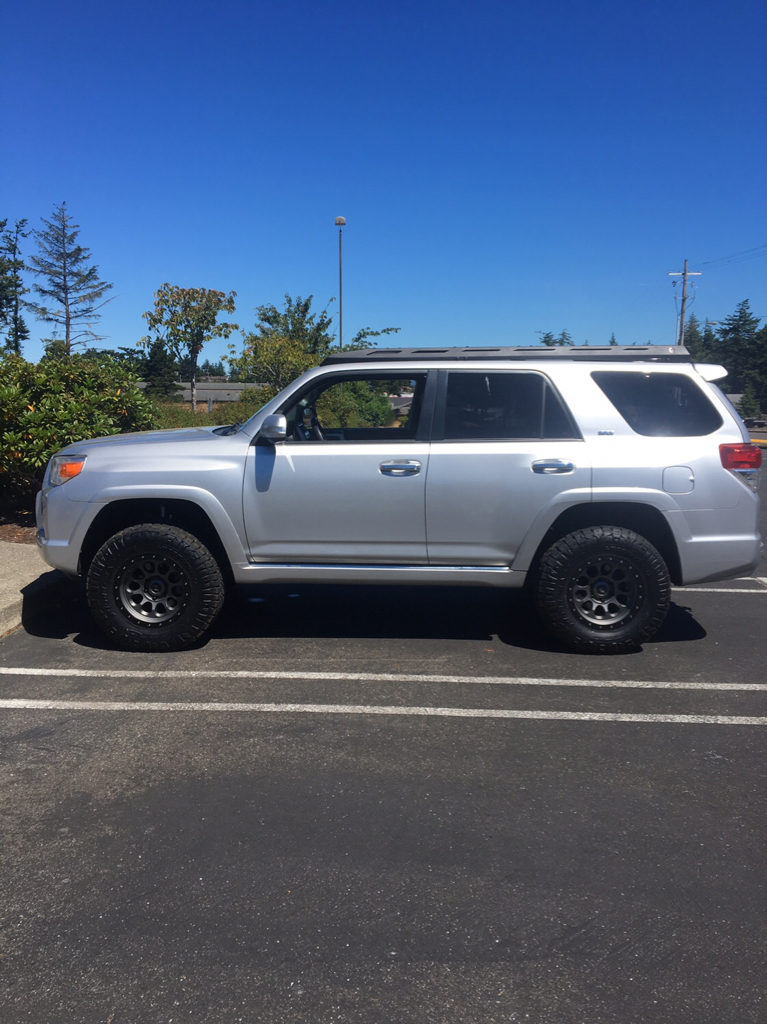

And, a picture from the side would help.

Looks fine to me, I'd just lower the front COs to 1.5-2.0 inches thread showing and start there before moving to more involved steps. Decreasing your preload would go a long way for ride comfort too.

Ok, I thought so looking at the pics. That's a big tire to stuff into a 2in lift. Definitely, upgrade the rear springs. I'd want a full 2in up front as well which your numbers look close to...To be honest, I still think you are going to have some rub up front when stuffed...
