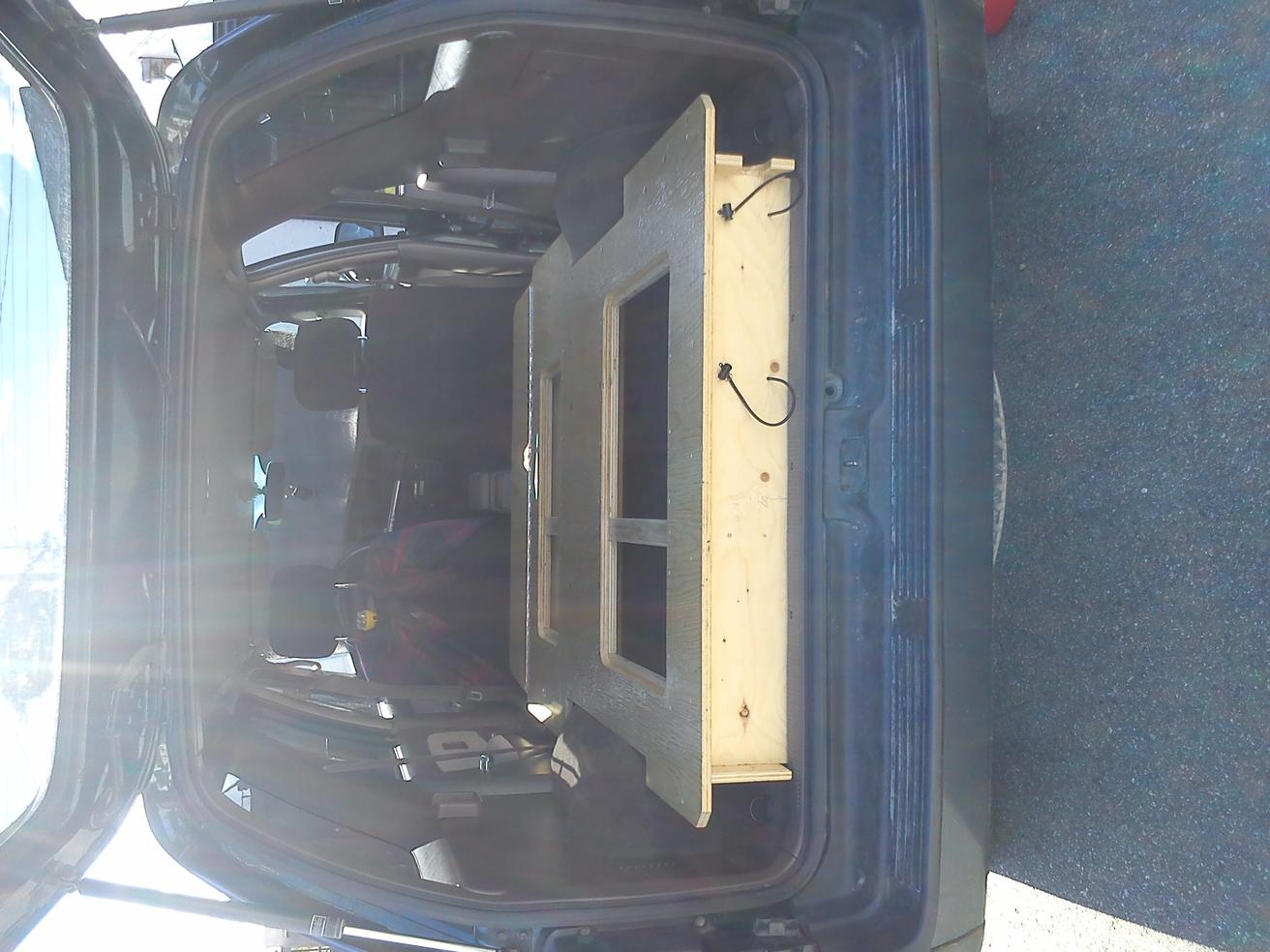

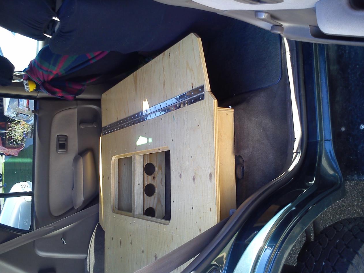

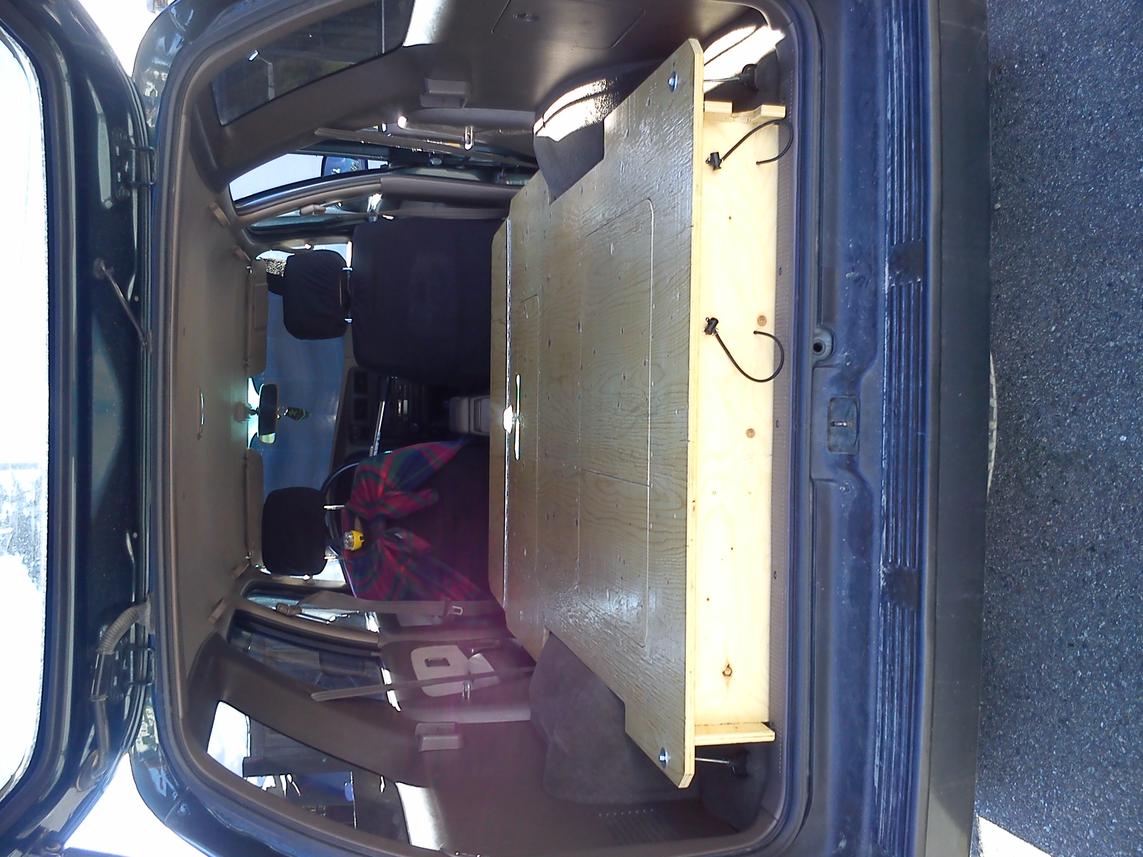

Hey,
Yet another option for bed platforms. I have seen a couple of folks ask about low profile for living space inside the 4runner. This option at 5 1/2 '' high has lots of storage and is fairly lightweight and easily removeable. And we can comfortably sit up to read or watch movies on a wet night. Full sitting headroom, at least up by the front seats.
Material is all 1/2 in ply. Mostly glued with a few screws. Water based varnish finish. It is fastened securely to the truck with 4 2'' aluminum straps in the front fastened where the rear seat hinges used to be. Two threaded J hooks hold down the rear to the cargo tie downs.
As for tested, this has been used for 2 seasons, an 8 mo trip from Yukon to Mexico and an 8 mo trip from Yukon to Arizona another year. No problems to report. It does, however, make the 4runner a 2 passenger rig as the rear seats are out. The platform makes a very passable seat for short distances with the head folded back but then there are no seatbelts.

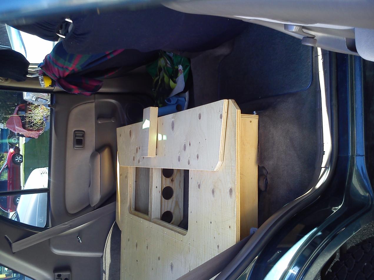

I don't seem to have any pics of the underside. Maybe the wife has a few of when we built it, have to ask. There is no bottom in it, the side and end pieces sit flat on the carpet in all spots, and there is a center stringer in both directions to divide into 4 seperate compartments. It took a bit of measuring to make them fit correctly. and after 2 winters of use the carpet shows no damage other than being a bit flat.
The bungees held a hand bicycle style air pump. For emergency use if needed.

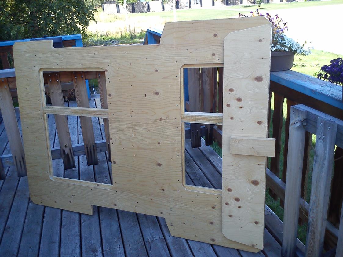

We built this just before our first trip to Mexico so the rear seats came out completely to make room for storage. I think we’ve had the runner 8 years now and the platform has never come out and the seats have never gone back in. We’ve got the corolla wagon if we need more seats.
The top is one full sheet of plywood. It’s about 6 feet long and slightly under 4 feet wide. A second sheet made all the under structure.
I’ve pulled it out a couple of times to reduce weight by cutting holes and trimming corners and to revarnish.
We had recently been sailboat owners which gave us the idea for the top hatches. This has been one of those things that worked out just right on the first attempt so there has been no need for a version 2.
