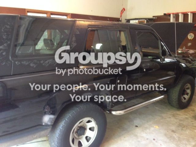

Ive been a member for a while now. Formerly a 4th Gen owner but now times have changed and I am now the owner of a 1988 4runner with 4 cyl. 5 speed and 210k miles. It has spent its life in North Carolina so no rust anywhere that i can find on the frame, but a little on the shell corner and some has been repaired on the fenders....
For now the plan is to get maintenance completed and become familiar with the older vehicle as well as start a deep clean on the inside before anything else.
[/URL]~original[/IMG]
Thanks, the interior is grey. The body etc is in pretty good shape, there are some other issues with it but overall seems to be alright. My main issues are wiring, theres a lot of wires that look like a hack job, and there aren't any lights on in the dash area except the gauge cluster. gonna have to get all the maintenance up to date then start tracking down electrical.
