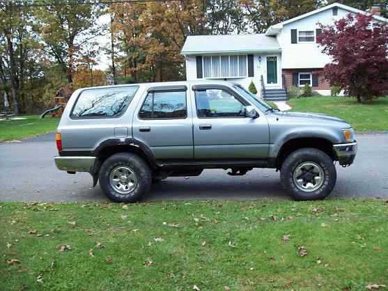

I recently picked this up to use as a daily driver and a toy to build. It's 22RE 5spd with 162K. I got it for $1600 which I guess was OK, for the body condition. Frame is in great shape but as you can see the normal rust spots are plentiful & bondo'd. It turns out that it was serviced at the dealership I work at and I was able to get a good bit of the service history for it. Headgasket was done around 80k. valve cover starting to leak a little on DS of engine & front of engine a little wet. I had a master tech look at it and he said it's the head gasket probably starting to leak. No burning oil or coolant yet so I will get those done first just to be safe. I was thinking about changing all diff and xfer case fluids because the most recent record I could find was 100k ago.

Look forward to any suggestions, hints, tips, tricks

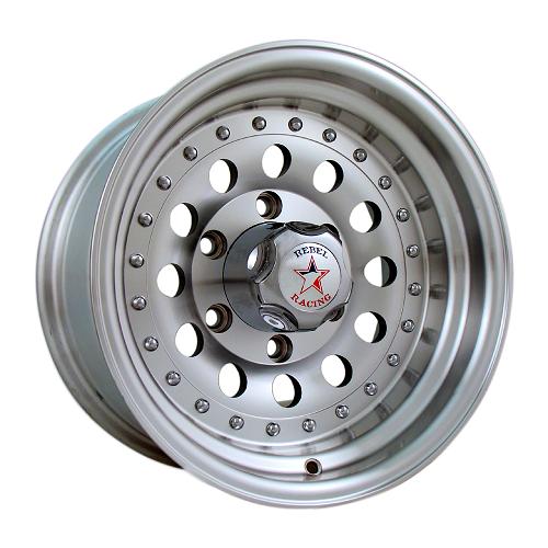

Yeah, I actually forgot wheels on my list. These are the ones I was looking at originally, but not sure yet. Still debating about 15 or 16 w/ most likely 33 x 12.50

Looks like a good buy you got there. One recommendation regarding the rims. I had those same style on mine for years and yes, they can be a bit hard to clean around the rivets. Also, after awhile my buddies told me that style looked a bit "80's". Not that there is anything wrong with that. I'm a product of the 80s myself! :-) That is not the reason I changed rims though.
I wanted bigger meats and decided I wanted to get some 15X10 rims for 11.50 or 12.50 wide tires. Here is a suggestion and is what I did when I was shopping around for rims.
First I took a side picture of my 4runner with my digital camera. Then, with my computer and a basic photo editor (you can actually do this in Microsoft Word), I overlaid various pics of rims off the internet so see what would look best on my ride.
By doing this I was surprised as to what looked good and what didn't. Many times I thought "Hey, this rim will look Awesome!". Then after I did the overlay, I realized it either looked bad or didn't really fit the style of my truck so much.
Anyway, that is just a suggestion for shopping for rims. If your going to spend the cash make sure its what you want.
