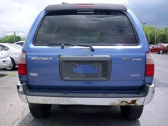

Hey y'all,
Just picked up a '99 SR5 V6 5-Speed w/E-Locker and only 102,000 miles this weekend for $6500.
Flew up to PA to get it and drove it 600+ miles back to Charleston, SC. I'm really happy with it. It is very clean inside and out with only a few blimishes. First project will be replacing the rear bumper, replacing the TB/WP and tackling the rust on the rear of the undercarrage.
Also, on the way back I noticed some wobble in the steering wheel and front end when going above 65mph. Gonna have the tires balanced, but I noticed a little play in the steering linkage in the front end too. I think I have a bad bushing or ball joints... Any ideas?

I think the wobble has something to do with the Steering Rack Guide. I got under it and had the wife wiggle the wheel and there is some play in one of the bushings.

i can tell you already,
-anti-sway bar bushings (advanced auto has them for cheap - the poly ones)
-steering rack bushings (i will help you - i barely had the elbow grease to do alone - realigning the rack was extremely difficult alone)
-LBJs (the last thing I did - now it drives better than when I got it at 100k)
of course, wheelersoffroad.com for bushings and a toyotaOEM LBJ.
