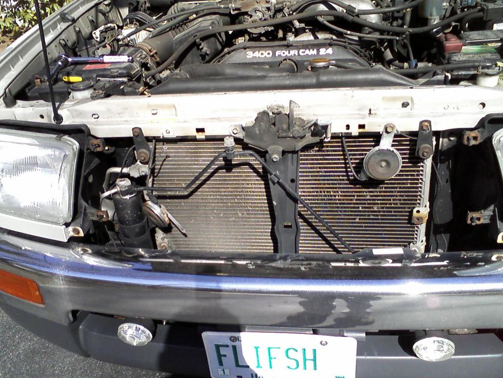

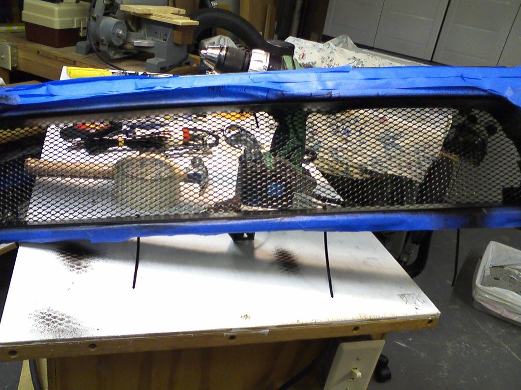

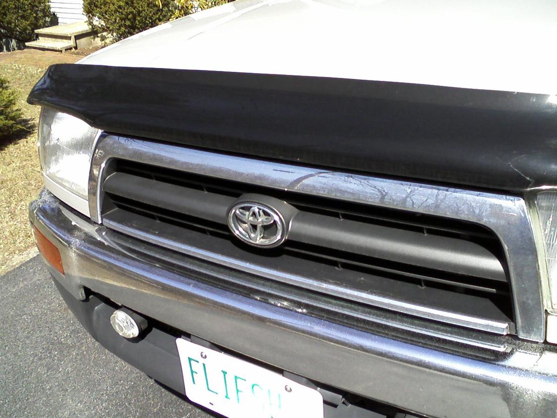

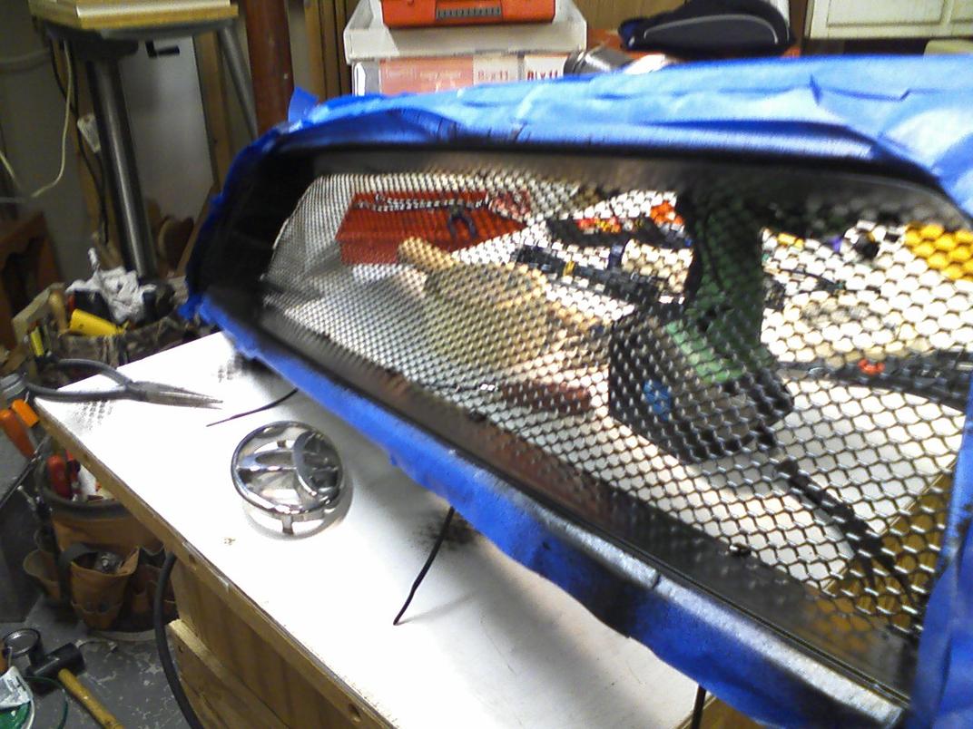

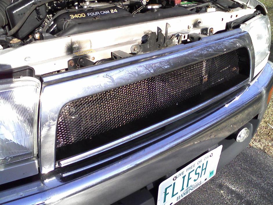

I started the satoshi grill mod last weekend and just completed it...I still have to reinstall the grill, but it came out nice...I just have to decide on an emblem...
Here are some pics

might be a dumb question. but how do you get the grill off?
I have looked at the attatchments and am afraid I will break the first two. till I figure out how they are removed.

BTW, I think you have to go with the TOYOTA logo in order for it to be "satoshi" not to be picky but wasn't the logo + black mesh what made the original creator's name stick. Without the same logo it is just a mesh grill, one of many. I hope I don't get flamed for pointing this out, it is just my opinion.

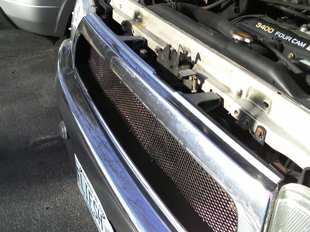

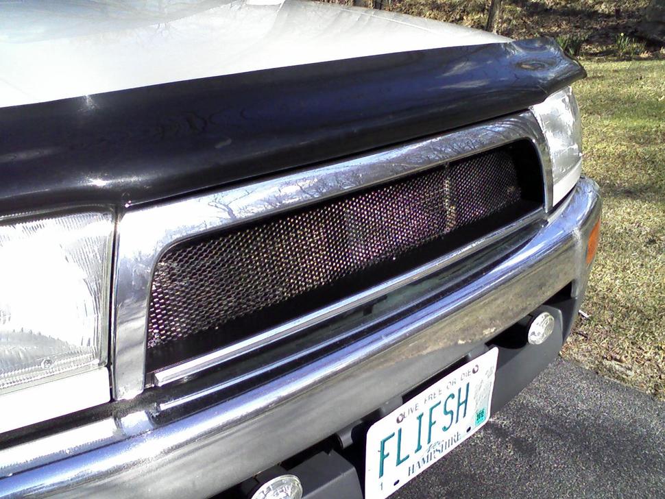

Thanks!!!!!!!!!!! Finished pic coming soon.... The grill comes off by carfully squeezing the small clips in each top corner, then below the clips squeeze from behind. You have to take your time and it will come. BTW, the dangling horn...I agree...broke the bolt when I was trying to move them...so I completely removed, and painted them too....remounted with self tappers...sweet things!! I am soooo happy with the finished product!!! Thanks for your thoughts!!
Pics of the finished grill...but still no decision on the emblem...soon...

Hey...about 2 hours total.... I got the mesh from Home Depot and used enamel black paint. I cut the grill with a coping saw, then used my dremel tool and a cutoff wheel....then small sanding drum to smooth out, I also used JB Weld to fill the small gaps...Go For It!!!!
