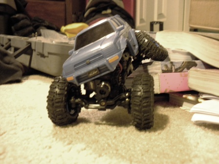

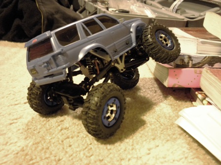

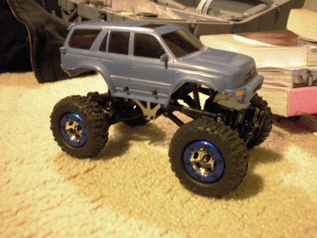

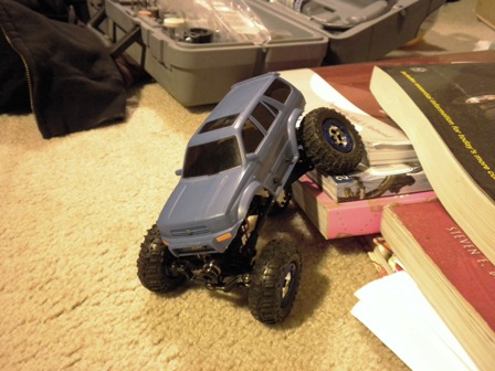

I just got it today. Brought it home and a light bulb went on above my head. Just got done trimming it. And tomorrow im going to get some black paint. DSCN0161[1].jpg

The Chassis is a Team Losi Micro Rock crawler, electric, they don't make gas rock crawlers, electrics have a lot more torque for crawling. Well I can't tell you were i got the body but it came with a little 4x4 chassis that takes two double a's. It would be a miracle if you found one on the internet.

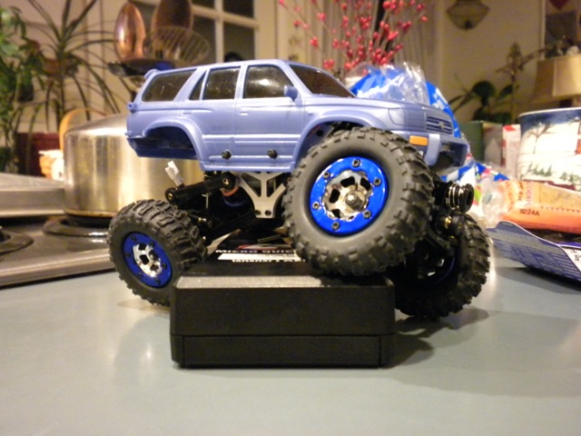

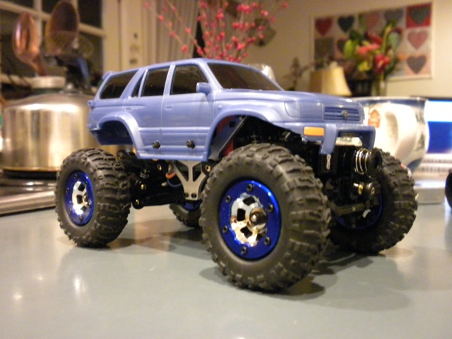

I lowered it so it doesn't look like monster truck and the cog is a lot lower and retaining all it's flex.DSCN0203[1].jpg

K2R, have you done any mods to it yet (besides the new body)? I've found that clipping the top two coils of the springs and running semi-droop lowers the stance nicely. I also reduced quite a bit of the weight up high by removing the ESC from the case, reconfiguring the chassis braces and putting the battery on the rear axle have all helped with it tipping over.
