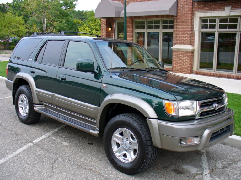

Here is the new baby. I'm not sure if I mind the green and gold
First mods, deckplate and ISR. But I was thinking if more airflow, les fuel might cause more harm. Then I will be putting the 17" limited sequoia rims from my old runner on. Installing my old system, 5% all around and 35% on the full windshield. Then the 7th injector from URD. I will be getting some terra grapplers when the tires are spent. It has a brush guard that needs refinishing, which I will most likely refinish with spray on liner. I want to get some new tail lights. I have to figure out how to reattach the wind deflectors from my old runner. I need to refinish the rear plastic piece on the upper rear bumper. There is a little surface rust that needs tending to. I'm not sure if I will go solid green yet, I will see if the current color continues to grow on me. I have a few stickers I need to add, (custom snook stircker, "salt life" sticker and possibly a TR4.ORG sticker. And I want to shave all emblems. I will eventually add a few inches of lift, when I replace the shocks. I'm still thinking if I want a suspention lift of a body lift. As far as the supercharger goes, I might stop at the 7th injector, but I'm thinking about maybe a tranny cooler and possibly different pulleys. Not sure If I want to add more strain to the engine. I will also be replacing the head gaskets eventually, I need to pull them off and see what condition they are in. I remember someone saying something about the "rear diff breather mod" which I will be looking into. Any other ideas would be great.

ehh, you know what yer doin lol, good list of plans...hey maybe getting the new runner is a blessing in disguise! now you have a supercharged runner, and you know EXACTLY what yer doing now, so you can do it PERFECTLY!

Congrats on the new truck! Looks good!
