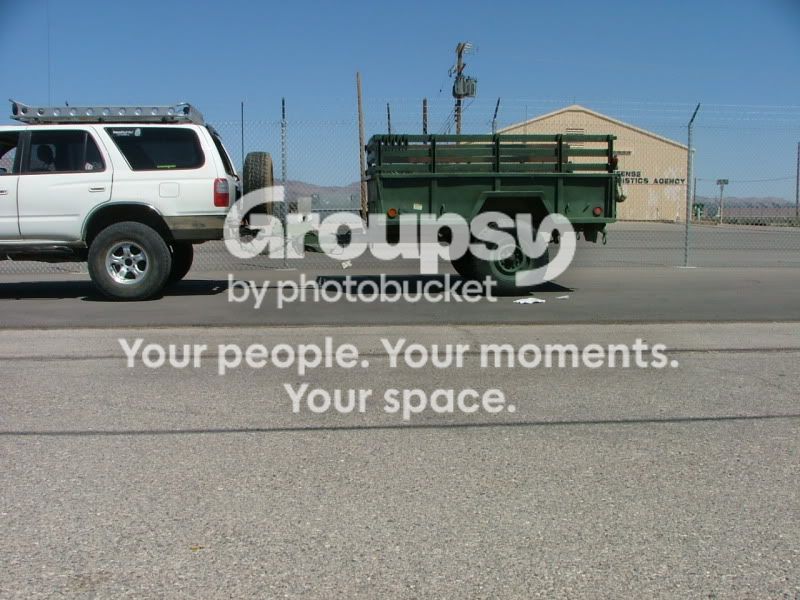

Ok so it isnt a 4Runner but it will be towed by one. I am not sure, might be a little big but for the price i couldnt pass it up. I went to Government Surplus Auctions at Government Liquidation and won the auction for this for $210. I went all the way to Vegas today round trip to pick it up. Here are some pictures of the trip, and a little goofing around midway home.
DSCF5580.jpg~original
Double checking it was still back there because it towed so nice.
DSCF5581.jpg~original

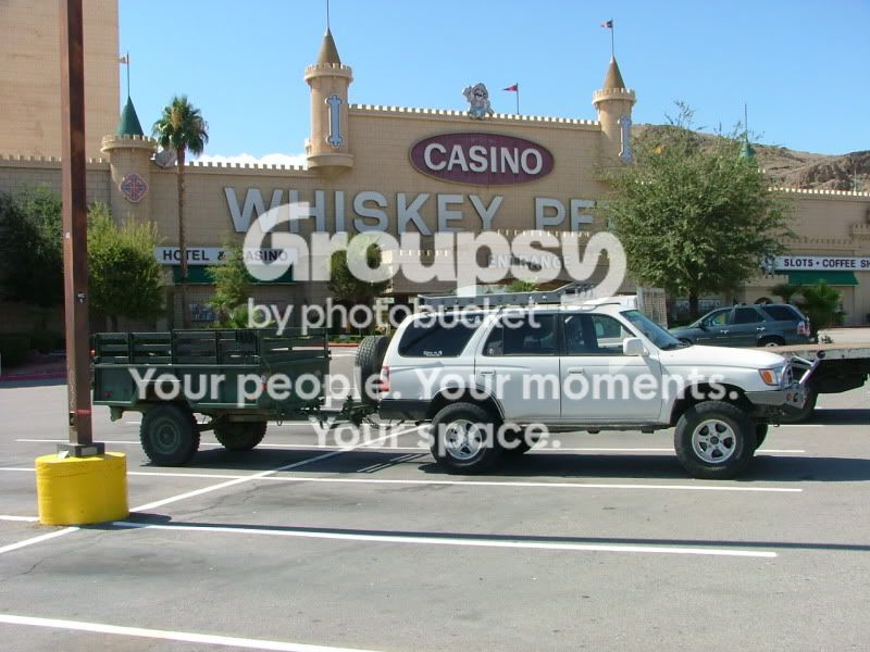

Stopping at State Line to have lunch
DSCF5583.jpg~original
DSCF5584.jpg~original

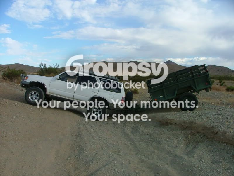

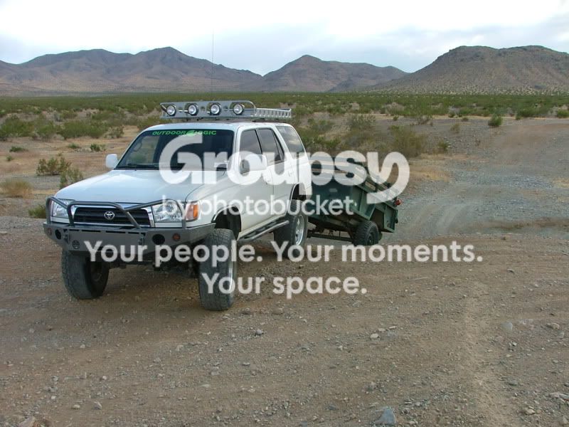

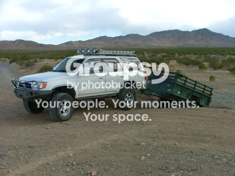

The goofing off part
DSCF5587.jpg~original
DSCF5588.jpg~original
DSCF5589.jpg~original

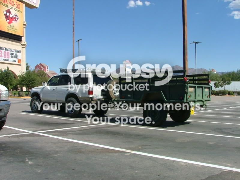

Tires are 235/75/16 on GM 8 lug. I am planning on swapping out the axle for a regular #3500lb trailer axle with 10x2.5 electric brakes and Toyota lug pattern. It does have the full military bows but the tarp was shredded. Initial plans are to place angle Iron along the sides about 2" below the lip on the inside with 3/4" gas spaced for rubbermaid totes. I will have plywood vertically to load block the totes and then when I reach campsite pull them up and lay horizontally to create sleeping platform. Once I use it a few times and decide if it is usable(also saving my pennies) decide how to build it.
