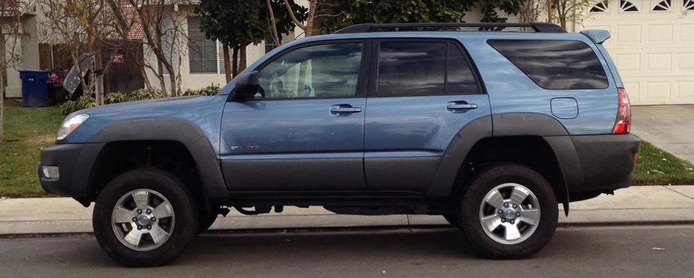

If you added 3 to front and 2.5 to rear, I'm curious to see a picture! Something doesn't sound right

You would have to see in person to realize the sag. i'm just looking for a way to level it out
I see the "sag" to me, looks like the front is really high. Can you post a pic of the suspension installed?
Rear looks right, looks like front is 4" or more to me
do the measure like ebg18t said, mine appeared the same, i cut down a 1.5" poly to 1" and added to my rear to look better. Or you can remove the top plate spacers.
Which tires are you going to run later? Depeding on tire size, either remove the top spacers or add some in rear. Thats my thoughts

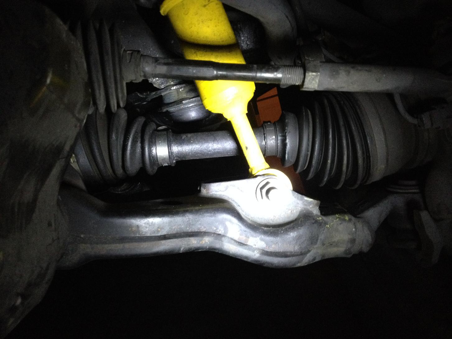

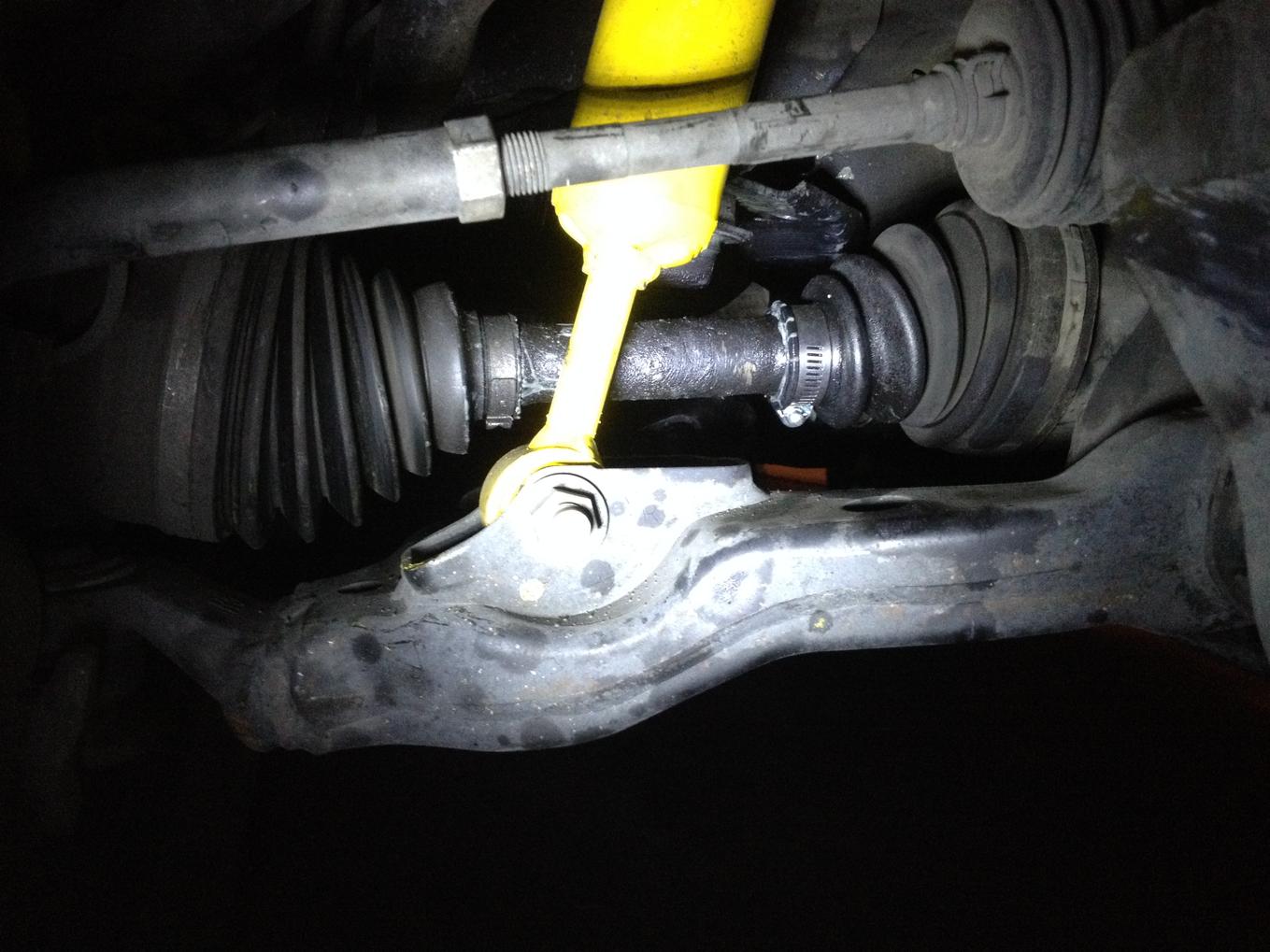

Post a pic of your cv angles too. Looking at your pic, I guess the front is a tad high.

post a pic of your cv angles too. Looking at your pic, i guess the front is a tad high.

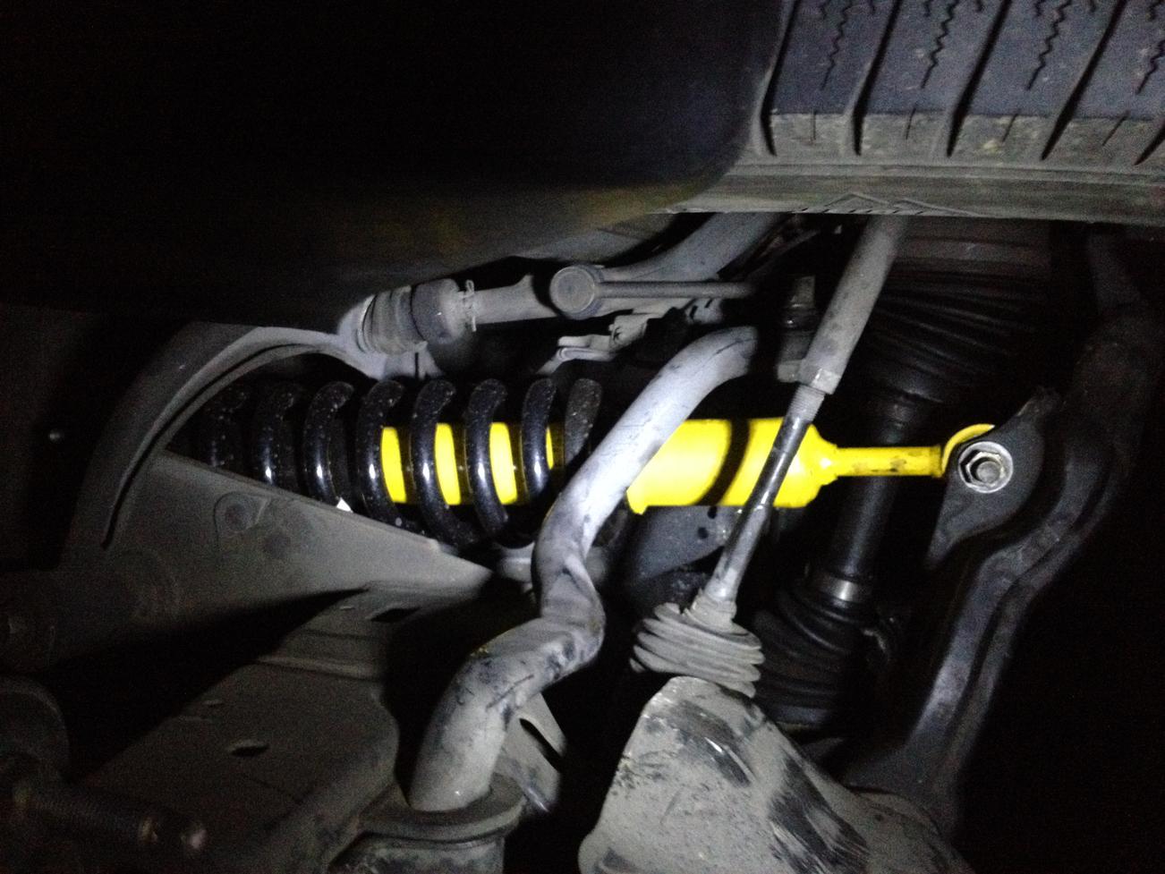

Driver Side
Passanger Side

You are going to want a little rake, if your even front will still look high, go with some daystar 1.5" you should be able to find cheap
