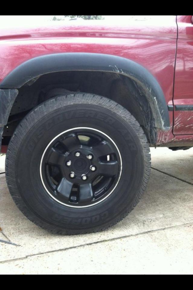

I would start with checking your tire pressure, they could simply be overinflated and that's a free fix. Also post what make/model/size/load rating tires you are running, as that could also be the issue.

i feel any bump front and back and i have " rancho's" that i got from autozone.
i mean i feel every crack and my tires are at 50 psi (rated for 80 max)
ill try what was said, but im only saying this bc i drove in my moms f150 on the way home and said "be careful this bump is BAD" and we drove over it and my mom said "uhhh that wasnt bad at all (it wasnt) and its 3 blocks form my house so i drive over it often and i knew in my truck it was the big *****. in other trucks is not. but ill look.
