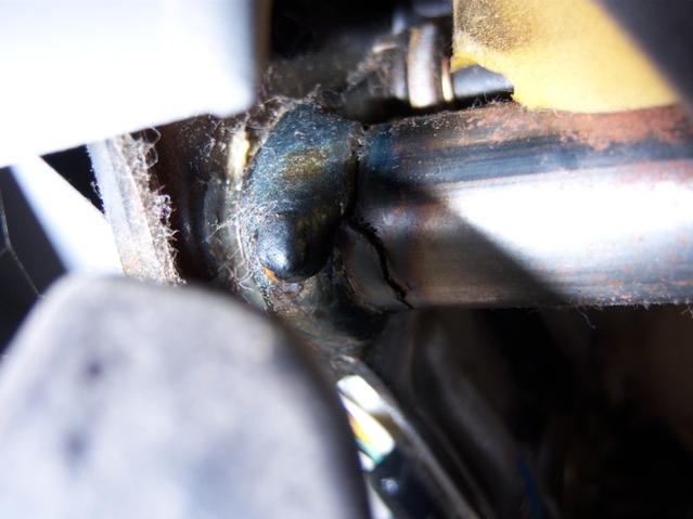

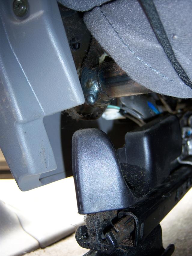

I really dont know how this happened but i noticed when i hit a bumb or something my seat would lean to the right side so i looked under it today and on the bar in the back on the left side was a crack. just seeing if anyone has had this problem or this is apart of a recall or something

I have had a wobble with my drivers seat as well. Im gonna have to take a look now and see whats going on. If thats the case ill prob just pull it out and weld it back up myself since its an 03. I doubt the dealer would do anything for me.
that happened to mine a couple months ago. i took the seat out , removed the trim and welded it alot better then is was. havent had any problems since. hope this helps.

Honestly, the weld is actually good, if you notice, the crack is next to the weld. A proper weld will be stronger that the surrounding metal. I assume, that we're just harder on the trucks than the egg heads thought we'd be...

I had the same issue. Pulled seat out and confirmed that the weld had broken. I don't have access to a welder but I have used JB Weld in the past and so decided to give it a try.
First I cleaned area with wire brush. Then, as I was wondering how I could get the broken weld "lined up" one side of the bar to the other, I had an idea: Hose Clamp. So I slipped a hose clamp loosely around the bar and pushed it off to one side.
Then I mixed up about a teaspoon of solvent, shove some inside of the bar, the rest on the outside of the bar, all the way around. Then I slipped the hose clamp over the repair, "straddling" where the crack was, so the clamp overlapped repair on both sides. I then tightened up the clamp as tight as I could, then smeared some more JB Weld over the top of the clamp.
I made sure that I didn't let any weld get on any of the surrounding parts, like the rail that the seat slides on. I let it set up over night, then reinstalled the seat.
Solid as a rock!
