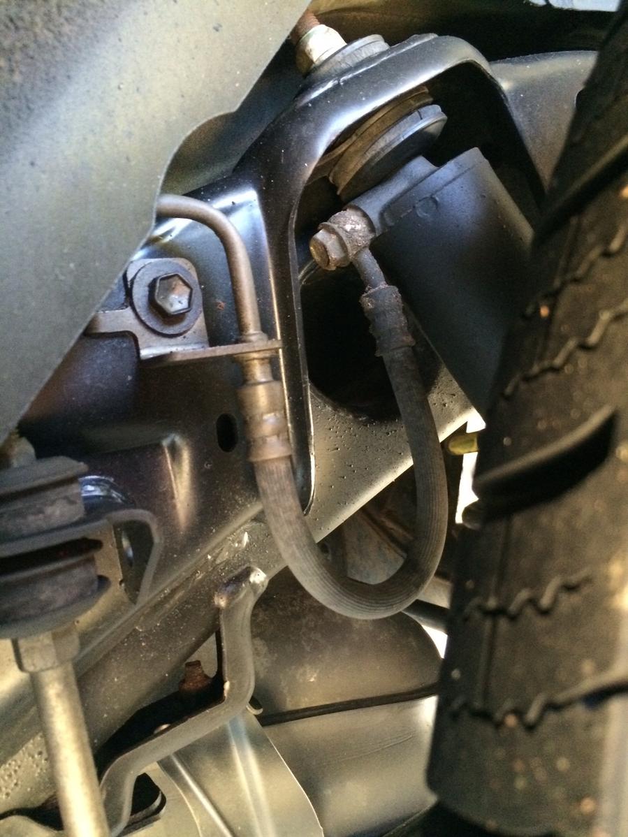

See pic - XREAS?

XREAS with badly dry rotted rubber bushings on the shocks and sway bar links.
I suspect that the rest of the bushings have seen better days, as well.

That shock looks interesting.i bet it was leaking and the mechanics were told during the inspection to leave it alone,the detail department will take care of that.pressure washer anyone. ;)
See pic - XREAS?
