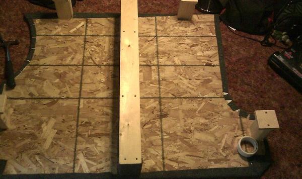

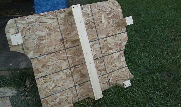

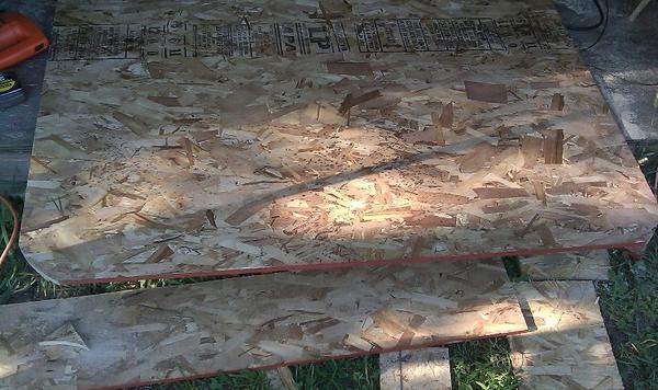

first had to cut the particle board to the proper dimensions and round the edges, this includes the fender well curves. those were a pain.

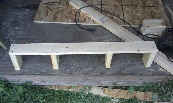

next the supports for underneath the board. i built it with 7'' of room for the tubs i had

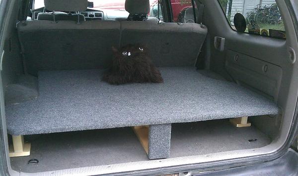

next i attached the supports and checked it for fit, make sure that everything fits well so that changes could be made if needed.

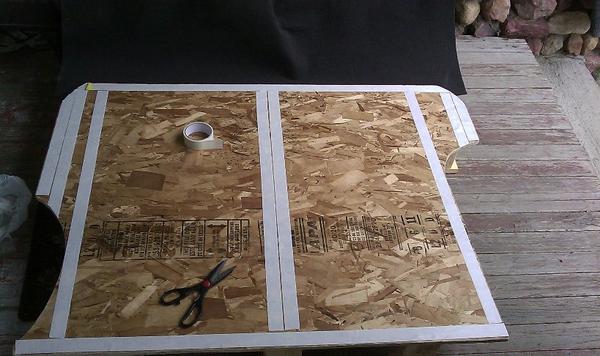

once everything fits as needed, its onto the carpet tape and installation of carpet. i used carpet tape in conjunction with a staple gun to ensure that the carpet wouldnt come undone

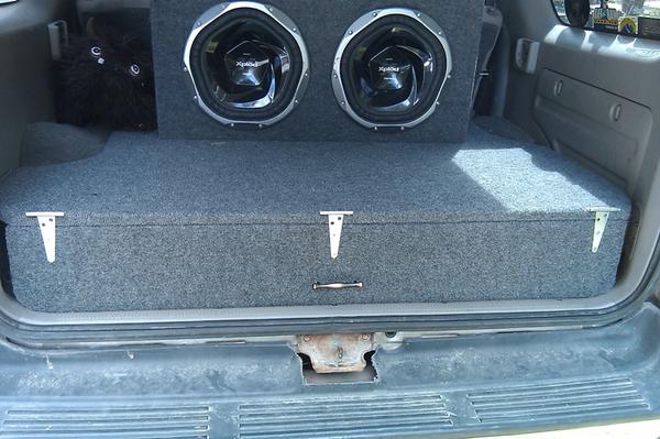

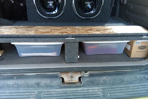

after the carpet is installed its on to another fit test to make sure nothing has changed. once that's done, add in a few hinges, a handle, and a door and your done
and of coarse, the tubs. even enough room to keep my spare alternator just incase

How did you get the carpet so tight with no folds or anything near the bends?
That was a little tricky. I laid down several strips of carpet tape to ensure that the carpet did not move. The edges were stapled down with a staple gun and the corners too. The corners I had to cut grooves in to all for overlap so that it would all lay down flat and could be stapled.
