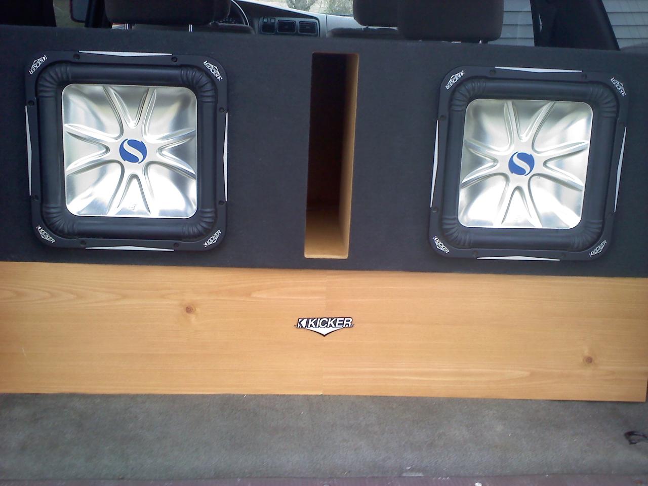

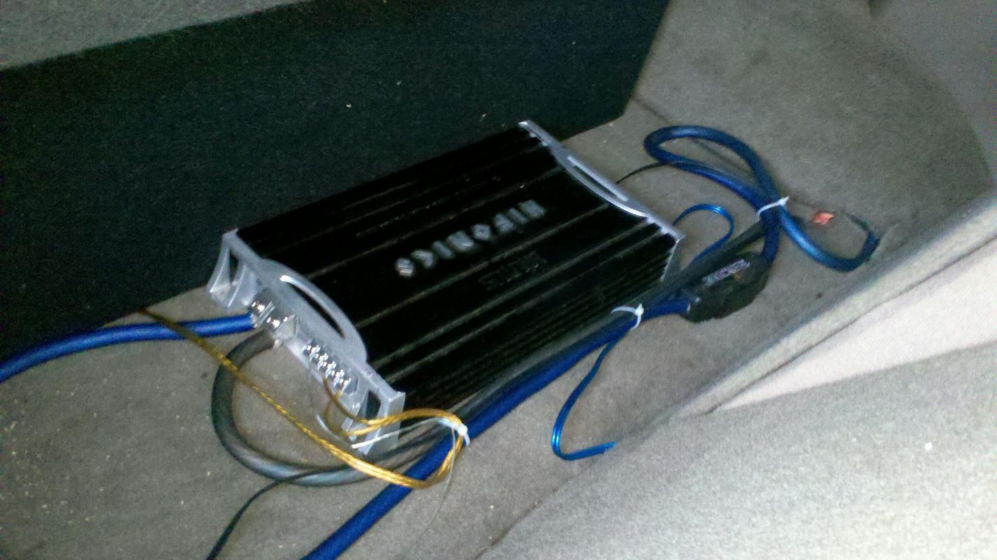

I was bored and i decided i would share my system with you all. Enjoy

Its a 2000 watt class D. Yea it is enough those subs are rated 750-1000 watts max. Thanks!
Nice Setup! I offer you this advice: place the fuse closer to the battery. You will get better sound quality and more protection for your amp. But still amazing setup. 2 Kicker Solo's 12"?
Sweet. Love the subs...
Thanks for the advice on the fuse, its my first system and i hooked it up myself but had help with the headunit wire harness lol i will fersure put the fuse close to the battery the next time around and give it a try. And they are L7s
Didn't even notice the fuse, but now I do. You definitely should put it within 6-10" of the battery!
There wont be a next time because your truck will have burned to the ground by then. Do it now and save a headache or two.
LOL but yes it is supposed to be installed within 6" of the battery. Check out crutchfield.com (& their forums) for install plans, guides and advice.
