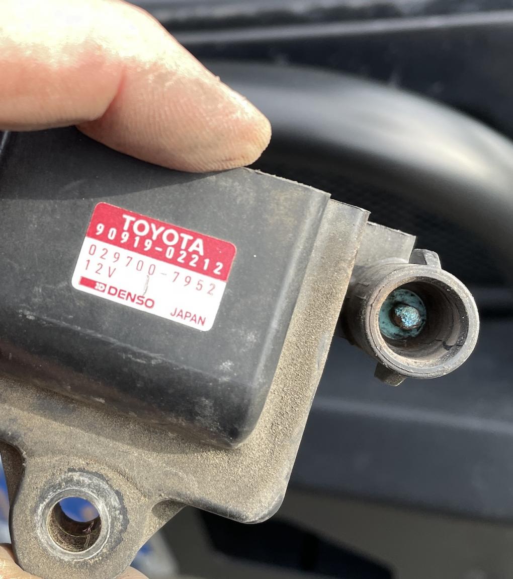

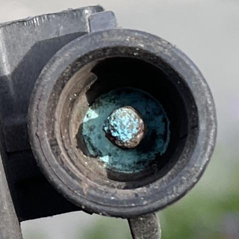

So given the lack of time yesterday I got as far as swapping coil pack in cylinder 1 with 5 (meant to do #3 but a nasty cold / brain fog is my excuse - first one since well pre-covid). I didn't realize I didn't have a 5/8 socket, so I couldn't pull the #1 plug. The reason I'm even mentioning this half-assed progress it to mention that the seat for the #4 cylinder (on the #1 coil pack) was full of crusty dust and the metal pin was encrusted with turqouise, uh oxidation?. The other 2 on the passenger side did not have that. Unfortunately, I cleaned and blew it out for the most part before I took the photos below, so keep in mind it was way worse looking than the other two. The #4 cylinder didn't seem affected, but I am wondering if that may point to an issue with the coil pack that was sitting on #1 or some resistance somewhere else?. Hoping the misfire issue moves to #5 or #2. While I was moving the intake out of the way I did clean the MAF - the wire was filthy. I cleaned it last a couple of years ago..... thanks for any insight. Will check plugs next before investing in a compression test kit.

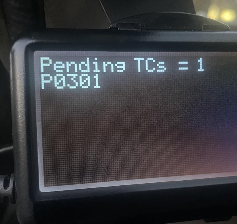

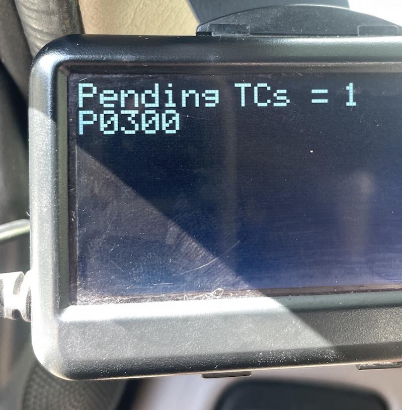

After swapping packs, I now get a PC of 0300. Should I wait until it goes full TC/CEL (will it ever pinpoint a cylinder?), or is the new Random Misfire code enough to lean towards coil packs? I got the new code within less that a mile of driving after a couple warm starts. Give it some more time to collect data? God I hope it's just a coil pack. I need to go camping at a bike race in less than 2 weeks.
If it turns out to be that, I will do 6 plugs since I'll have the slightly more involved side exposed anyway. Am I being too hopeful here without further testing?

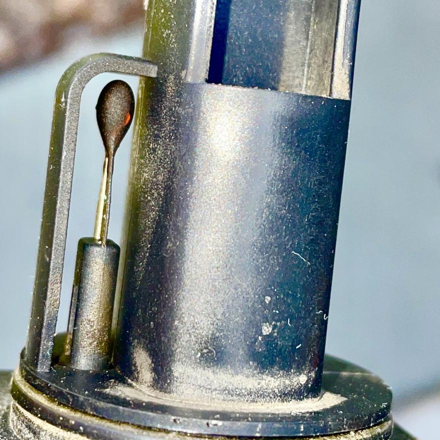

The picture you show there is just of the temperature sensor. If that's dirty, it doesn't matter much. The wire that matters is down inside the venturi tube.
-Charlie
-Charlie
Yes, I drenched the innards with MAF cleaner as well. I didn't realize the exposed wire was only for temp, though - thank you.

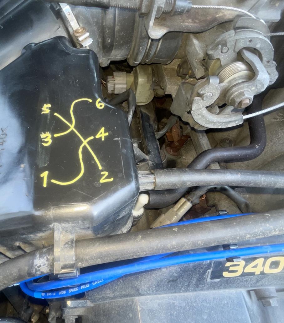

I wish I had some advice but I'm not a mechanic, just a parts-swapper unfortunately. My issue was only on a warm restart and somewhat intermittent. I could have sworn I felt a stumble the other day driving back and forth to the Sea Otter. That was after posting that this issue was Resolved and now my OBDII is constantly set to monitor Pending Trouble codes (pre-CEL). It's kinda annoying waiting for failure. When you get the CEL, does it run rough? The coil pack on Cyl 5 sends the spark to Cyl. 2. Have you tried swapping that pack with another to see if the cylinder misfire code changes?
