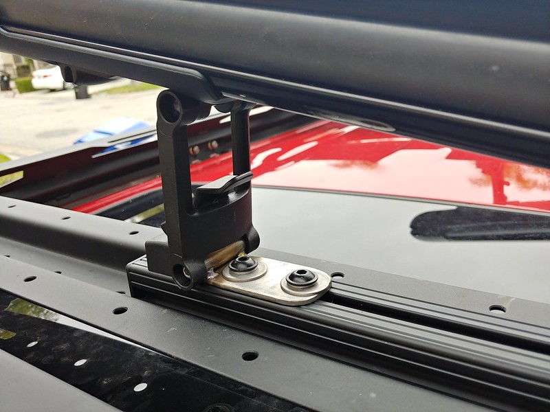

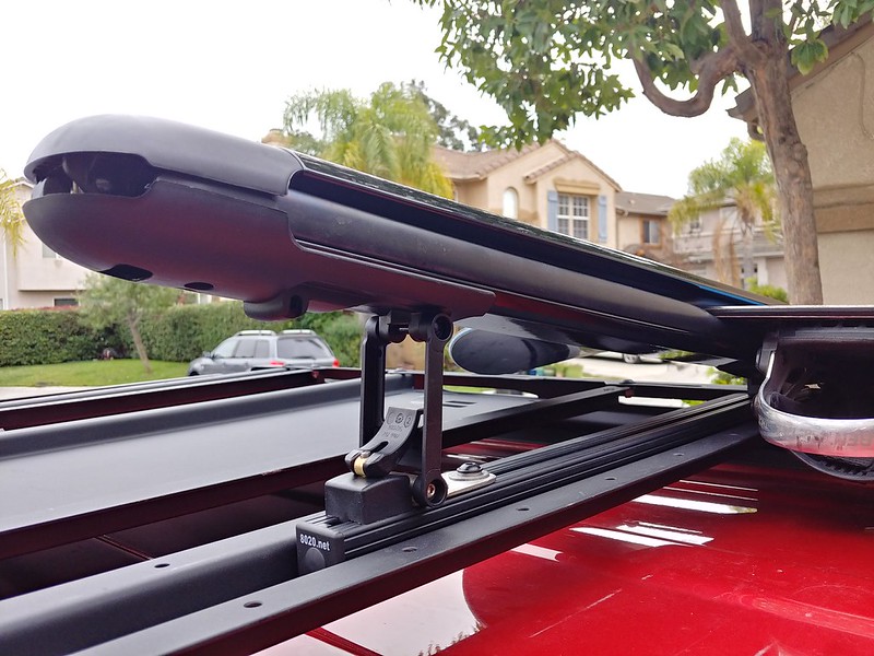

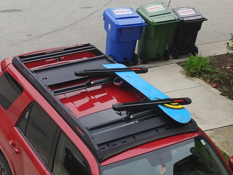

Finally got some ski racks mounted. The Yakima Fatcat set can carry 4 snowboards (if there's enough clearance to mount 2 upside down). I love to snowboard and get out any chance I can. It's been tough with the baby but if I'm lucky, my wife will let me take the day.
YouTube

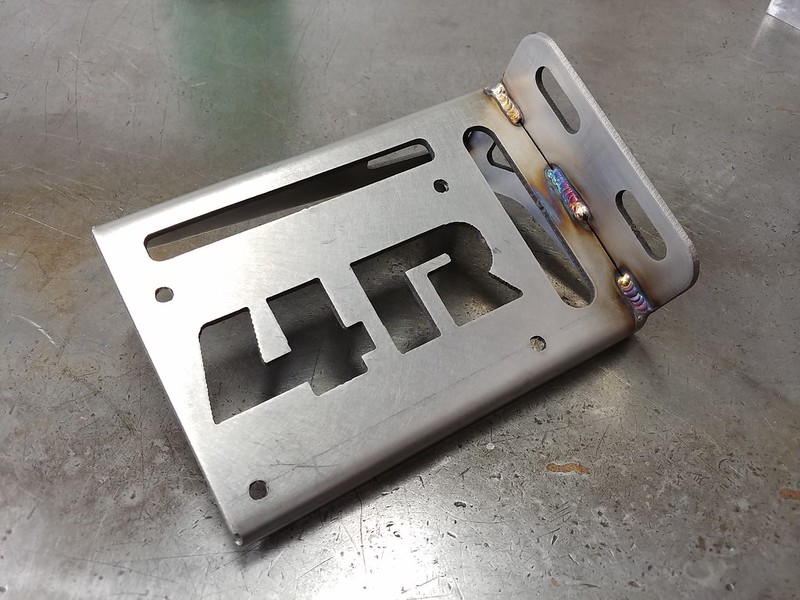

The first set of mounts I designed and made up really sucked. They were too tall, ugly, and a pain to install and adjust. I gave in and ordered a couple of two foot chunks of 1.5" T-slot. Yakima makes a kit to attach to slotted bars (called the SmarT-slot kit). They're made for Yakima crossbars, but with a bit of filing they work just fine in normal T-slot.
The standard mounts are flat, but they have a convertible piece on one side if you need more clearance. This way I can go from 2 boards to 4 boards when needed. The wrap mounts come with the provision to make these work, but I had to make my own since I was using different mounts. It's a stainless 1/4" spacer welded onto some drilled flatbar. There's a corresponding piece inside the flatbar.
The racks work well and are solid at highway speed. I'm happy with them.

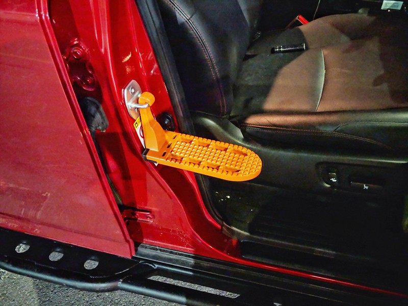

Also really helpful during the install was this little doohickey. It's called the Moki doorstep and it hooks into your door latch to provide a sturdy step for extra reach on your roof rack. There are plenty of Amazon and eBay knockoffs but I decided to support the original creators. This piece is a lot sturdier and the padding for protecting your paint is much better engineered than the knockoffs. It's also 4 times as useful as a Gobi ladder for a fraction of the price. Fight me.

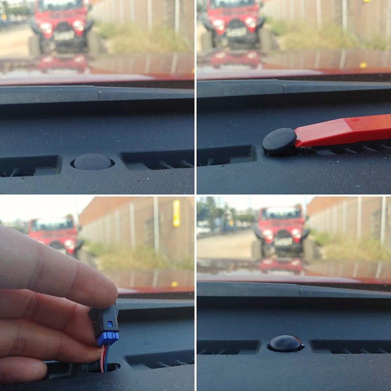

This is a cool little factory addition made possible by Old Red!

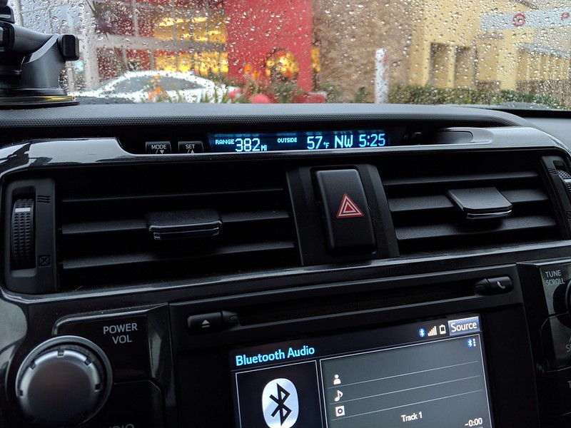

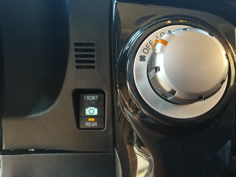

All 5th Gen 4Runners used to have this info display in the center of the dash that displayed the clock, compass, outside temp, and MPG/range (from 2010 to 2013 the display was orange). After the 2014 refresh, all of this information was relocated to the tiny center screen in between the gauges in the cluster.
Toyota must have eventually decided to eliminate this redundant source of info and repurposed this location as a cheaper digital clock across all models. However, the display stayed for one year after the dash/lighting change to blue, and it's available only in the 2014 Trail. Besides the normal display, it also shows prompts when you toggle crawl control/multi-terrain select.
Check out Old Red's 2015+ AMD thread for info on how to do this conversion with the adapter harness he created! You'll need to take apart the dash and add the harness, as well as source your own display (this one came out of a junkyard in Cape Cod).

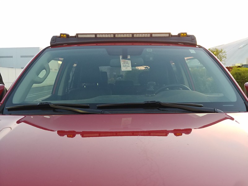

A few months ago I got it into my head that my truck simply didn't have enough overlanding points, and that the slot on the front of my roof rack looked a little empty. Let's get some lights!
There are a TON of options out there, everything from cheap eBay junk to setups that cost thousands of dollars from Baja Designs or KC HiLites. Like almost everyone, I wanted to select parts that worked for my needs (ok, nobody needs a light bar, so make that wants) and a good value for my dollar. So I ended up somewhere in the middle.

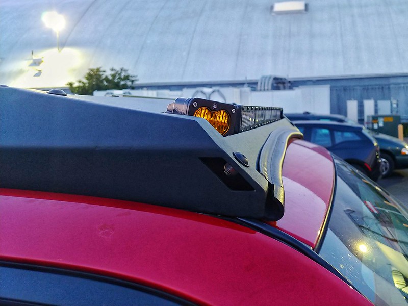

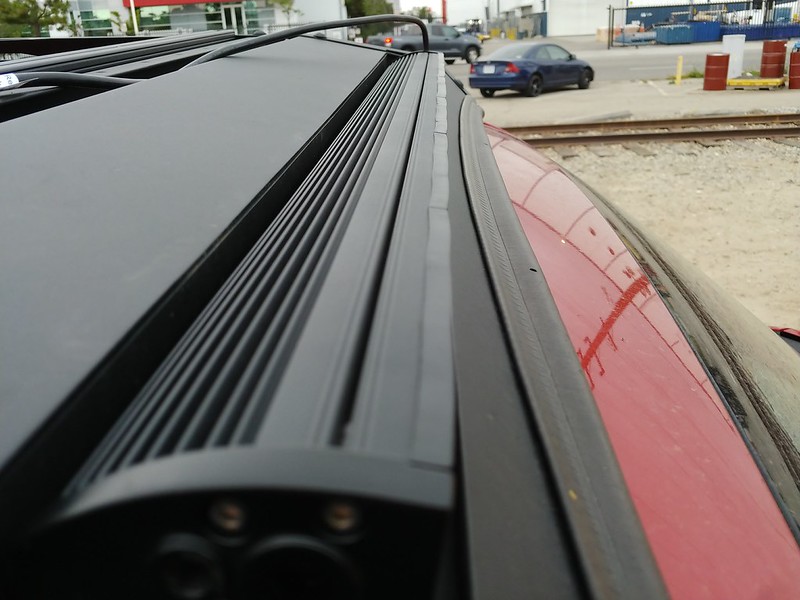

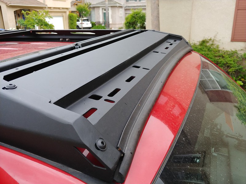

I started by figuring out what I could fit. The slot on the V2 Ecotechne racks is about 3" thick by 42" wide, and about a half inch deep. Right away, most of the big dollar bars were out. As cool as the S6 and Gravity bars are, they're simply too big and bulky to fit up there (they're also expensive and pretty overkill for my purpose). I wanted to find something that fit neatly into the slot and didn't stick out a mile. I started to look at "mid range" light bars.

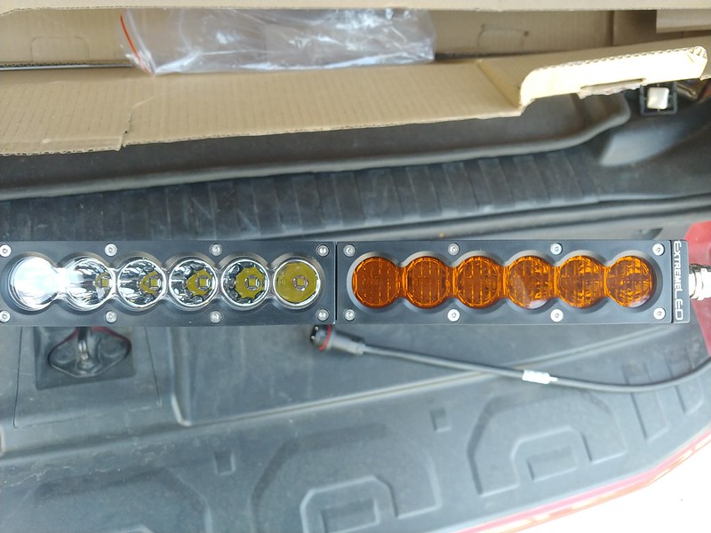

I'd seen a few people run bars from ExtremeLED, and the smaller 38" bar would fit neatly. So, I ordered one to give it a shot. Shipping was fast and packaging was protective. It fit where I wanted.
However, when I did a test fit using the provided harness, I quickly realized that this wouldn't be a great solution for a roof bar. Here's my review that I left for it after returning the bar. By the way, they have an excellent support staff that processed my return quickly and were very helpful.
I bought this light with the intention of installing it on my roof rack. I know that mounting lights on the roofline comes with the risk of producing too much glare on the hood, but I decided to try due to its description as a spot pattern. However, the optics on this bar seem way too scattered to be a true narrow-angle spot. They are simply LED chips with shallow reflector cones mounted over them. I had to aim the light way too high in order to reduce hood glare to an acceptable level, making this bar less useful than I hoped. The amber end lights also didn't seem to contribute much brightness, even when used by themselves- they don't produce much "fill light" like I hoped that they would. When the center section is on, you can hardly see the ambers at all. Finally, the faceplate covers seem to be made of a phenolic style plastic, which is fine but they appear to distort a lot during assembly when looking at the bar from the side. They may be sturdy but it gives the light a cheap look.
At least the lights in the center section are bright, but I would call the overall beam pattern disorganized. While it has a lot of output, I'm not sure it's very usable for anything other than a vague flood of light. And the BRIGHT white glare on the hood meant that my eyes were being dazzled unnecessarily, reducing the utility of the light where I wanted.
Overall, the X6S bar appears to be a stout, compact, and inexpensive light bar option; but it would not work for my application. I care much more about how the lights will work than how they'll look on instagram.

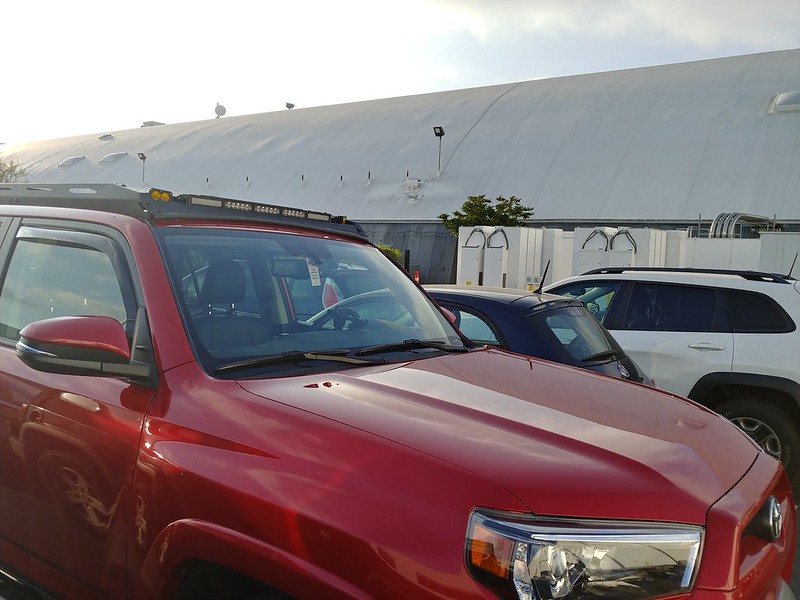

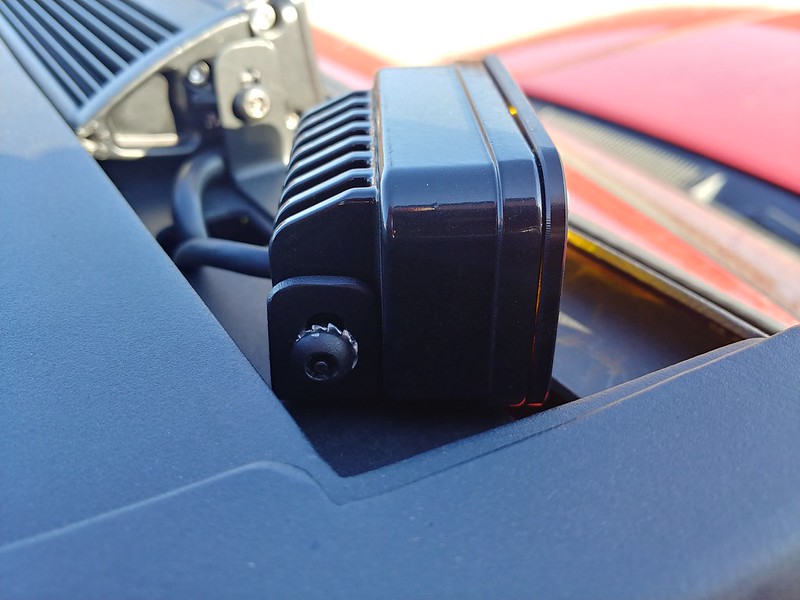

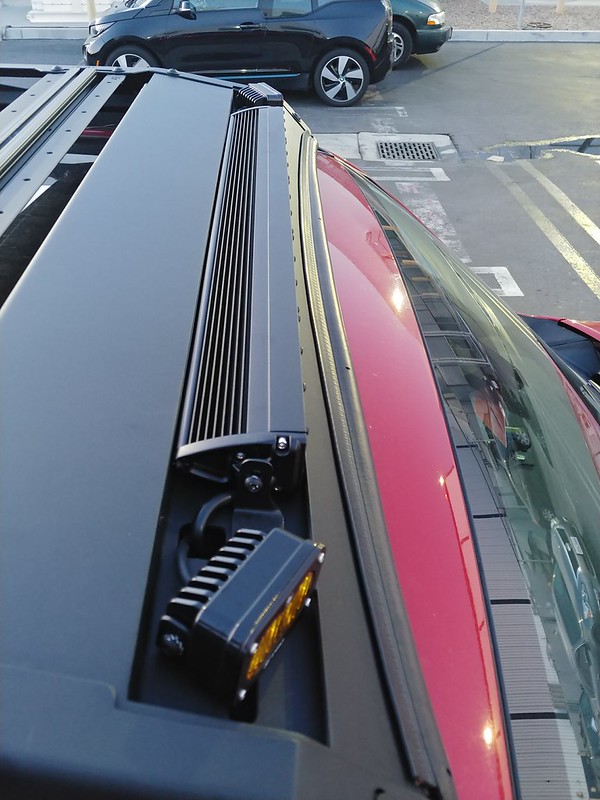

So I decided to get a 30" bar from Diode Dynamics and then flank it with a set of smaller lights that could be aimed independently. I ordered the bar in the combo pattern, meaning that the outer two segments have flood optics while the center three have a spot pattern.I ordered 2 extra spot lenses for $3 each just in case the flood lenses gave me the same glare problem on the hood. I found a great price for S2 Pro lights from BD and decided to use those as ditch lighting on the corners.

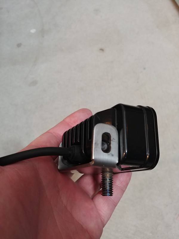

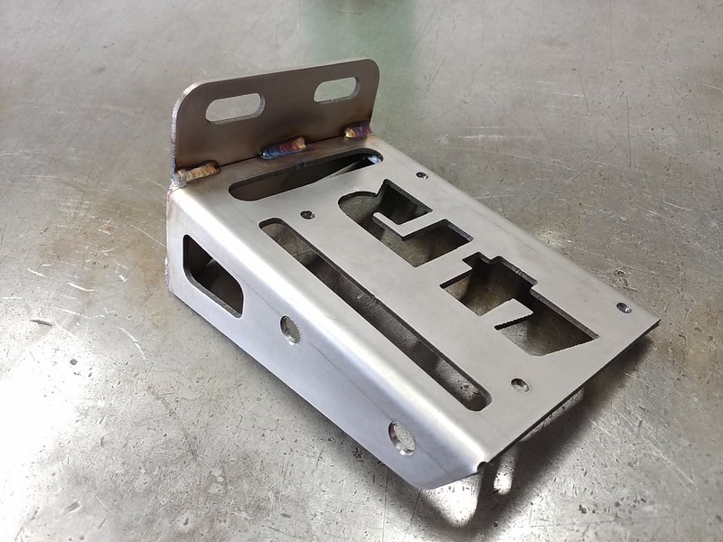

It took me a while but I was able to design and cut out some stainless brackets to have as low of a profile as possible. The brackets for the S2 lights basically allow them to be mounted flush, as I welded a 3/8" stud to them instead of having a separate bolt with a head. The main bar brackets are pretty simple 90º designs, but I needed them in custom dimensions in order to fit the cutouts already present in the roof rack fairing. I also made my own bracket for a Blue Seas fuse box.
I also spent some time organizing and purchasing all of the extra junk (wiring, fuse box and mounting bracket, relays, switches, heat shrink tubing, connectors, hardware, etc.). In fact, I spent more on all of these incidentals than on the actual lights themselves! Make sure you leave yourself plenty of budget for this stuff. The DD bar had a Deutsch connector but I decided to change everything to weatherpack to keep it consistent (I also already have a weatherpack crimper for assembling connectors).
For what it's worth, the Diode Dynamics bar is only a little more expensive than the X6S bar from Extreme (for any given size). However, I think the quality is miles ahead. The faceplates are machined aluminum and have O-ring seals. The lenses look and feel more purposeful, and the end plate castings have proper ports (one is used for a waterproof cable outlet for the wiring, and the other side has a vent installed). I'd be interested to check out a Baja Designs bar to see how much more robust it is, I know they have a serious racing pedigree. In any case, I was very impressed with the construction of the Stage Series bar.

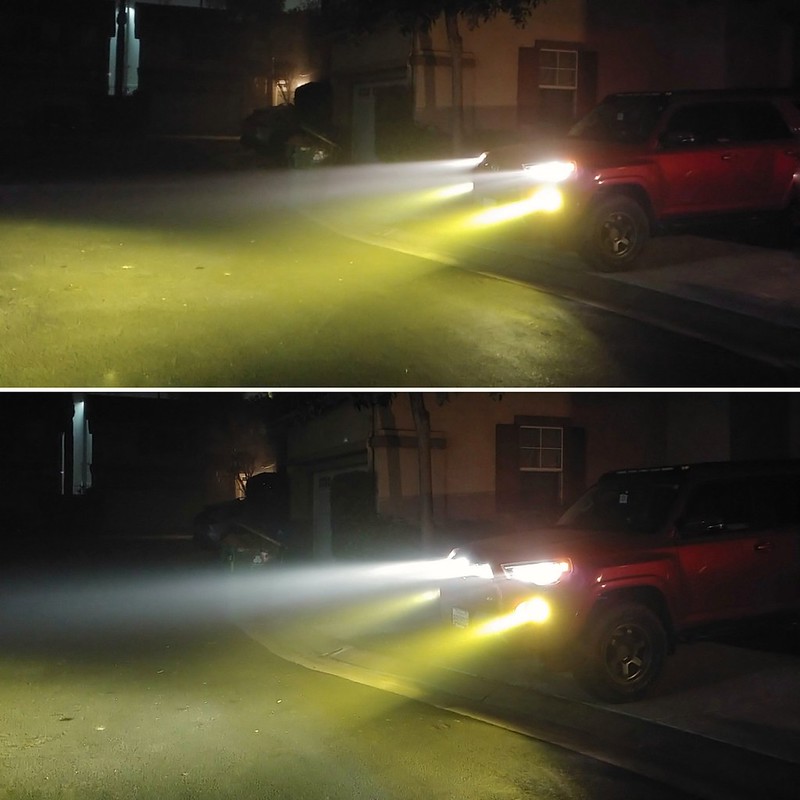

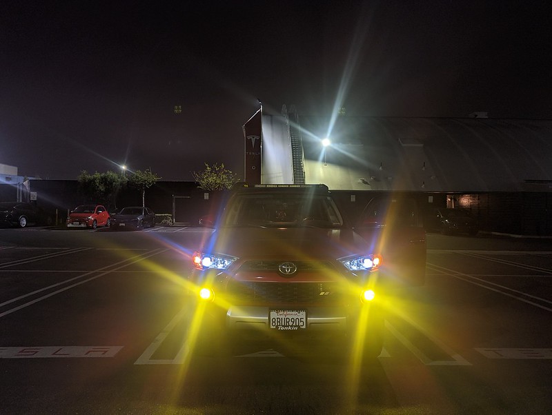

After setting it up and aiming the bar to merge with the low beams at a range of about 80-100 feet, I'm extremely happy with the output. The hood does illuminate slightly when the lights are on, but it's a soft illumination without harsh white glare reflecting back into my eyes. The light is thrown far downrange and the flood lenses help diffuse the edges for transition visibility. I'll have to take some night trips to determine if my eyes get fatigued from the hood glow, but it is definitely MUCH better than the previous bar. It is really a usable pattern that can be aimed, instead of a glaring blob of brightness. The S2 lights are also insanely bright for their size, and provide proper ditch lighting that can be seen and used- unlike the other bar where they were integrated and barely noticeable.
1. No lights
2. Morimoto 2stroke 2.0 LED low-beams
3. Low beams + Phillips 12793UNIX2 yellow fog bulbs
4. Xenon Depot Extreme LED hi-beams (with DRL module) and low beams (fog canceled)
5. Lows, fogs, and S2 ditch lights
6. Everything plus the DD bar
I'll detail a parts list, some things I learned, and things that I would do differently in the next post.

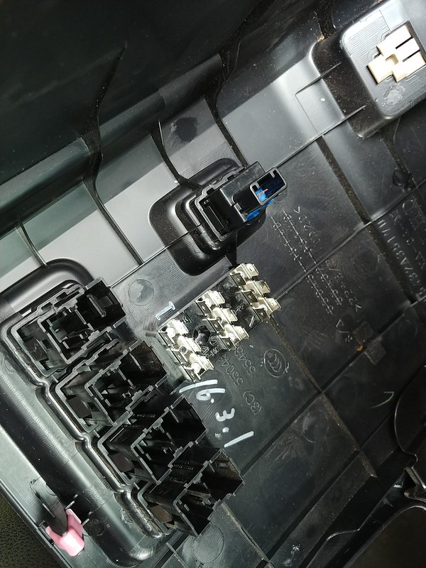

For the switch wiring through the firewall, I bundled six 18ga GXL wires together and used MCMaster adhesive heat shrink (a huge pain in the ass to get therm all pushed through). After hitting it with the heat gun and passing it through the firewall grommet, I terminated each end with a weatherpack 6-pin connector.
McMaster parts used:
Adhesive, UV stable heat-shrink: 8195K33
Mesh sleeving: 9196K12
Silicone grommets that fit the plugged factory holes: 1061T15
Non-adhesive, UV stable heat-shrink: 8061K95
While I like how the fusebox and bracket turned out, I'm bummed that the relays I ordered will only install upside down on the Rago relay bracket. It looks very untidy, so I'm going to switch gears and build a Bussmann RTMR using a Shrockworks bracket and the Bodenzord guide. Honestly I should have done this from the start, but I wasn't sure if I'd be able to do the full install in time for my 4th of July trip. Plus it was a fun learning curve building my own.
At first, I used the adhesive heat shrink to wrap the 14ga GXL wiring and pushed it into the windshield channels going up to the rack. However, the bundles were just slightly too thick and they kept popping out and flapping on the highway. I switched to the non-adhesive tubing which was a bit smaller after shrinking, and these seem to stay in place much better. They're also UV resistant, so they should resist fading. I may add a small bead of butyl tape in the channel to keep them stuck in a little more securely.
I also tried to organize my wiring under the rack fairing a little more using adhesive zip-tie mounts, but those ended up debonding a few days later (heating/cooling/condensation cycles), so I'm not even bothering to include them in the parts list.

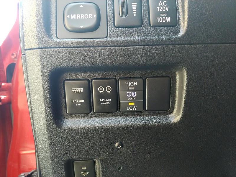

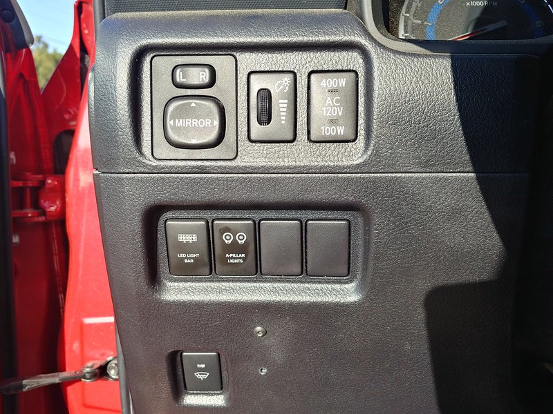

Switches are Air On Board Toyota push style, in blue that matches the dash lighting.
For connecting the switch circuits, I used a triple bus bar all the way from Germany- It was the only terminal block that did what i wanted with a small footprint. One bus has +12V from the fuse tap for the switch circuit power. I used the charging port circuit for the add-a-fuse, so the switches only get power when the key is in the ignition. The middle bus is +12V for the illumination circuit, and the third bus is either for pure ground or illumination ground, I haven't decided yet (the illumination dimming function is variable between 0 and 12V, and is what allows your dash to dim when you scroll the dial). If I hook it to pure ground, the switches will not dim along with the rest of the dash. However, I have some other things that would benefit from having an easily accessible ground bus.I still haven't tapped into illumination yet, so I'll figure that out later.

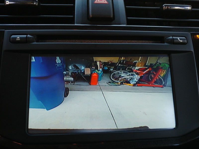

Finally, camera setup by anytimebackupcamera.com
This was a fairly easy install, with the hardest part being the RCA cable routing. RCA cable ends are very bulky, so pushing it through the firewall grommet and dash components was a real pain. Works well though, and I mounted the rocker switch in the old "party mode" blank near the ignition tumbler. Great for parking at the mall and self-spotting alike.

Added picture of the front cam in the original post. If you look closely, you can see my license plate frame in the very bottom of the camera view. So it's a good combination of forward and bottom. Should help a lot with parallel parking and blind spots on the trail. There was plenty of extra cable, you could mount it anywhere. This seemed good enough for me.
Can you do a write up on how you mounted the front camera and what the camera view is like? I've been wanting to do this for a while, but never got around to it.
The camera has a threaded extrusion that you use to attach it. I drilled a 5/16" hole in that part of the grill and then threaded the supplied nut on there. Make sure you don't lose it- I tried measuring it and it doesn't appear to be any common SAE or metric thread. I didn't even remove the grill- just the plastic fairing on top of the radiator that has the pop-off buttons. Reached down and tightened the nut while holding the camera from the outside.

Thanks for the brief overview of installing the front camera. Did you purchase the camera from anytimecamera or did you buy the camera separately? How would you compare the camera quality to the original backup camera?
Yes I bought the included camera as a kit. Other cameras might work but I'm not sure. This one uses a very small 4-pin connector to connect to the RCA cable assembly. Whatever you get, make sure it has the RCA connector and a power/ground included.
The image quality appears the same as stock but I can't be sure. It has a decent dynamic range, you can see it change exposure when you move from a bright to a shady area etc. There's no vehicle outlines obviously. It's enough to see clearly, though it will take some time getting used to the perspective and where the corners of your truck are compared to the camera view.
YouTube

I was curious about that Moki doorstep doohickey you mentioned... would it work on the 2nd row door latch? I'm setting up my roof rack system and the box I have sits toward the back, so I have to use the back tire to get up there since I'm not very tall.

So, funny thing about the rear doors-they do have that diagonal kick that prevents the step from sitting perfectly level. Also, I have noticed some minor dimples in the door sheetmetal due to the step- only on the rear doors. This doesn't bother me, but you might decide that it's a dealbreaker; or you might be skinnier than me and it won't matter.

Thanks for answering my camera questions and supplying a photo of the forward view!
I've ordered the same kit and hopefully will have it soon.

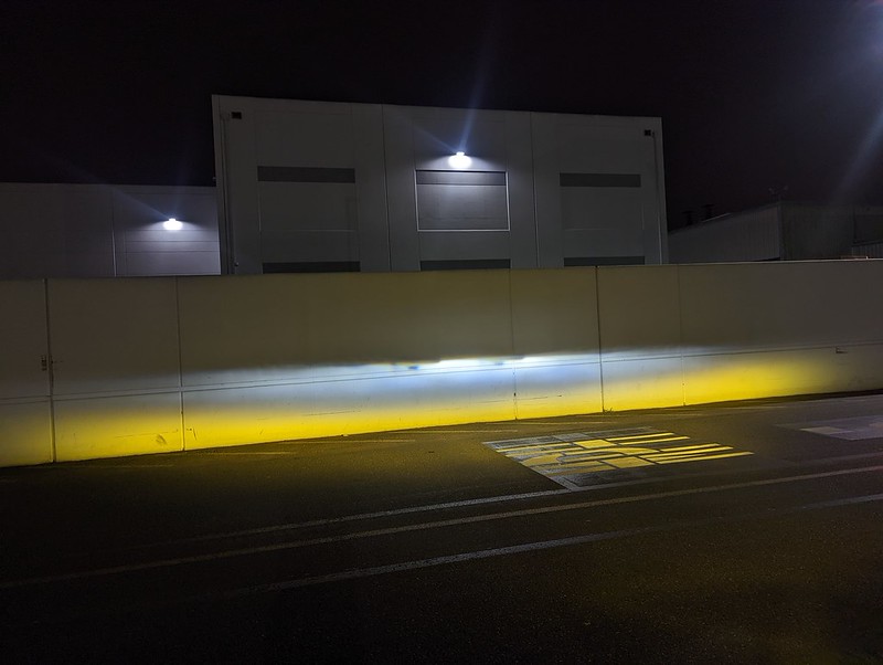

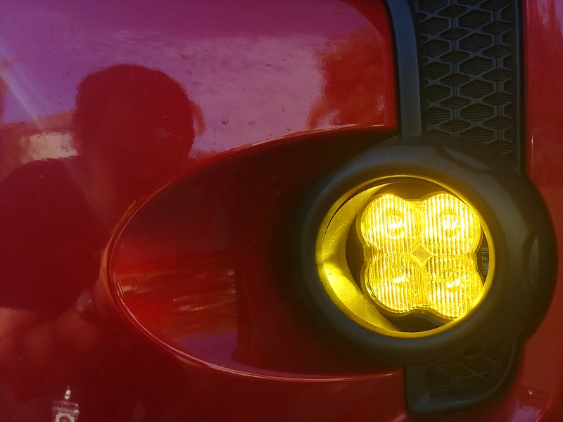

Next up were the fog lights. Late last year, Diode Dynamics released the new SS3 pods with their TIR (total internal reflection) optics. Similar to their light bars, these optics are much more advanced than standard projectors or reflector cones. They're designed to capture all of the light leaving an LED chip and direct it off of a controlled surface, which reduces unneeded glare and increases intensity. One step ahead of even their light bars, the lens is incorporated into the TIR optic itself, reducing inefficiencies of light transferring through different mediums. Again, here's a review on Tacomaworld where they completely trounce any other fog light on the market in terms of intensity and pattern width. Also, they're completely street legal and J583 compliant, unlike other "fog light" offerings from other companies.
The LED SAE J583 Fog Pod & Fog Light Review | Page 137 | Tacoma World

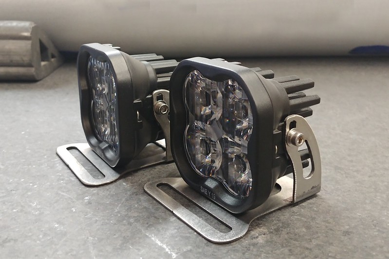

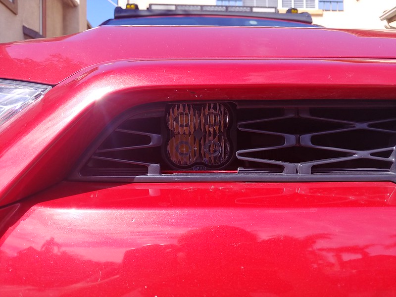

I also got a set of SS3 pods in their driving pattern, which are J581 compliant and legal to use as auxiliary high-beams. I wanted to mount them in the grill, to keep them a little more discreet. At the same time, auxiliary lighting should be mounted as high as practicality allows, to carry the light as far as possible down the road.
Auxiliary high beams should be mounted between 22” (min) and 54” (max) from the ground, on the same horizontal plane as far apart as practical.
https://www.govinfo.gov/content/pkg/CFR-2004-title49-vol5/xml/CFR-2004-title49-vol5-sec571-108.xml
Aux high beams should be mounted as high as practical to avoid shadows and the light being interrupted by changes in the roadway elevation. On my truck with a 2.25” lift and 1.5” larger tires, 54” will just hit the ditch light mount location. However hood glare is really counterproductive/harmful for your night vision, so I would keep them forward of the hood line.

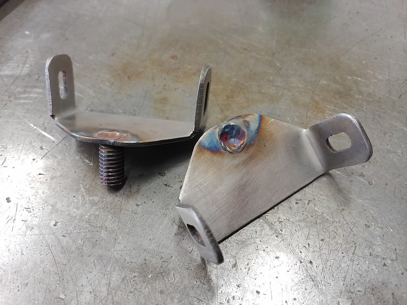

Instead of using a hidden light bar mount to fit behind the lower grill, like a Rago Fab unit- I decided I want to mount them in the upper grill, for the reasons listed above. I started cutting things up and played around with a few prototype brackets that attached to the grill mount crossbar, including some that placed them outside in front. Because of fitment and adjustability issues, I had much better luck bringing them back inside the grill.
Although it took a few tries and a lot of prototyping, I really like how they turned out. My favorite part is that they're really tough to spot unless you're looking for them. They're insanely bright and throw light way down the road like a big set of old-school reflectors, but in a much smaller package. I hooked them up to a relay using a SPDT switch from AnytimeBackupCamera.com. LOW turns them on independently any time I want (off road etc.) while HIGH ties them directly to the high-beam circuit. This way I can control them legally on the road by dipping them as needed using the high-beam stalk. And of course, I can turn them off entirely when the switch is in the middle position.

I really like this, and i'm seriously considering the theft of your idea here. I have the SS3 yellow fogs and LOVE them, and i've been wanting the aux pods for driving to give off better light. I like the idea of getting more light when the low beams are on so I can use the fogs as well.
It appears you fabricated your own brackets? How would someone go about seating these in the grill if one does not have the ability to fab? Appreciate any help. Also any tips on how you ran the wiring. Cheers.
I have a .dxf file of the bracket here, you would just need to have a metal shop cut it out and bend it for you. These lights are a little too heavy to attach with zip ties or whatever. Plus you wouldn't be able to aim them.
SS3 inverted bracket.dxf - Google Drive (if I remember correctly, this one isn't the final version. I ended up having to extend the ears about 0.200" or so).

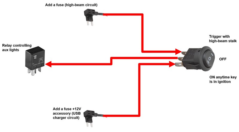

The wiring is fairly straightforward, if you know your way around a basic 4-pin relay. The HIGH/LOW switch is actually being wired backwards from its intended orientation though. I tapped one of the high-beam fuses in the engine bay as a trigger wire and ran that through the firewall for the HIGH circuit on the switch. The LOW circuit is tapped into the accessory 12V charger, so it can turn on anytime the key is in. The switch now has a 12V OUT wire back through the firewall that goes to the relay trigger. This is how a single relay can control the light in three modes (anytime, high-beam only, or off entirely).
Also, heads up because the high beams use pulse width modulation to work in DRL mode. This means that if you have the HIGH switch activated and your daytime running lights are on, it will ping the relay very quickly, causing it to buzz and occasionally flicker the auxiliary lights. I'm working on an inline filter to prevent this.

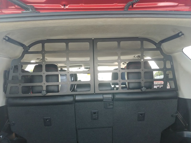

Next up is a pet barrier upgrade. The Raingler nets work great if you have laid back dogs, but one of ours is so persistent that she finds a way to wiggle around it every time. I bought the Bullet Proof Fabrication pet barrier (still on sale?) and it works phenomenally. It is also easy to add gear to. I attached a soft first aid kit in the dead space next to the headrest (front of the panel).

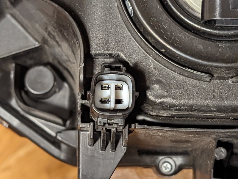

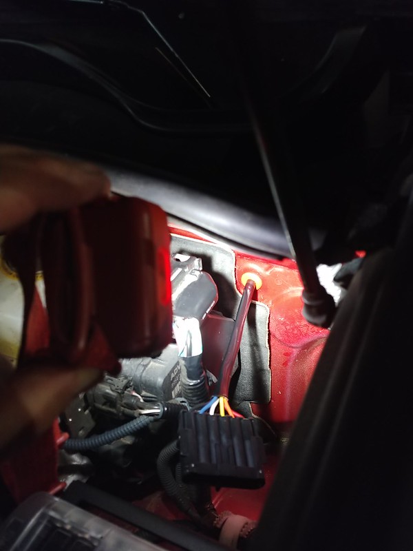

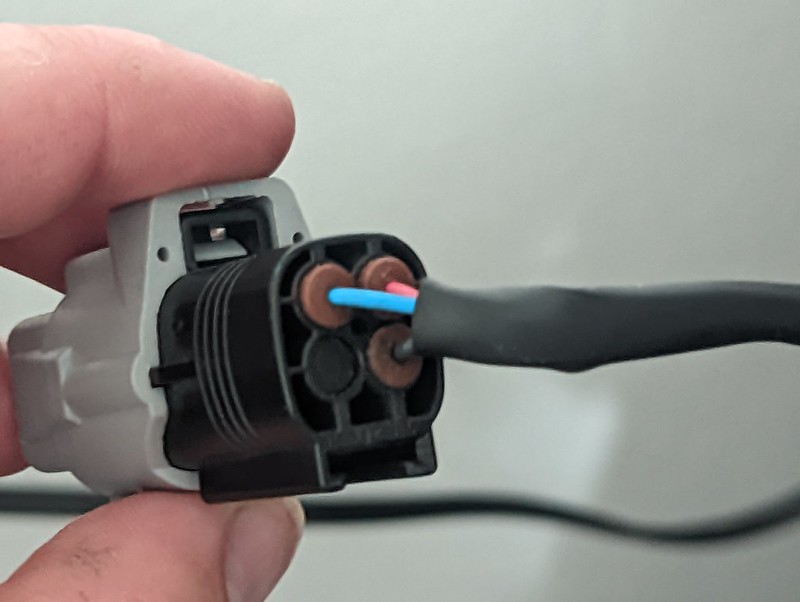

So I finally got my hands on a set of OEM bi-LED headlights. Originally, I was hoping to get the single low-beam units from select 2021 trims for the sake of simplicity. However, I think it's a moot point now. I'll explain below.

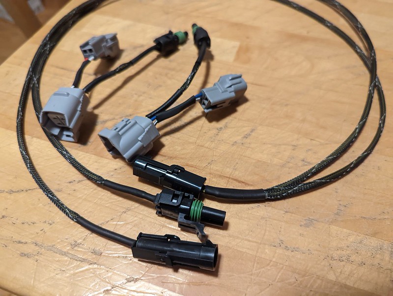

Once the headlights were in transit, I contacted Dave Easa on Tacomaworld for help on adapters. We agreed on a plan for him to ship a pigtail with bare leads so I could connect to 12V and determine pin functions.
As most have figured out, red is to light the lamp, blue is to activate the high-beam shutter, and black is a common ground. What's interesting is that the connector appears to be the same for both types of headlights, with the populated pins dropping to 2 for the low-beam only units. That's not the only similarity.
So Dave built me some harness adapters to go from the existing halogen connector on the truck to the new LED connector on the headlights. This way I wouldn't need to de-pin the connectors and I can easily return to halogen headlights if desired. But, we added an extra trick: an additional wire lead out of the shutter connection that can be controlled externally. I terminated it with a single weatherpack connector for my own harness.
The lights work perfectly. Here they are paired with Diode Dynamics SS3 Max fog lights.
As with the low beam units, they have those goofy shadow artifacts in the beams, just below the cutoffs. My theory is that Toyota used the exact same projector for both models of headlights, and then just depopulated one of the wires for the "cheaper" trims. It would be really funny if someone opens up their SR5 headlights and finds inactive shutters in the projectors. I digress.
As for the custom harness, I made the old mistake of measuring once and cutting twice- it's too short between the headlights and I will need to remake it. However, I did connect it to the driver headlight and confirm that the shutters do activate when triggered with 12V!
Temporarily, I have the shutter circuit connected to the relay and switch that usually control my auxiliary driving lights. I'll need to add more relays to control my growing collection of lighting upgrades. Maybe a Bussman box or SPOD is in my future.
Warning: If you attempt this mod, you will need to figure out a way to prevent your DRL mode from pinging the shutters. Older 5th gen 4Runners use PWM to dim the high beams for DRL duty. If you are using a trigger from the high-beam circuit (like an add-a-fuse etc.), you must not directly connect it to the custom connector. Otherwise, when you turn on DRLs you will rapidly signal the shutters at a high frequency, which may wear them out or destroy them.
The way my switch and relay is laid out, I have dual control- meaning I can activate the shutters anytime in LOW and they toggle with the ordinary high beam circuit in HIGH. I can also can turn it off completely to avoid DRL buzzing the relay. However, the circuit can still be exposed if I forget to turn the switch off. Eventually I plan to build a capacitor filter to prevent the problem entirely.
Since I messed up my harness and need to wait for more wire sleeving to try again, I have not had any road experience with the quad high-beam setup. However, I am VERY impressed with the quality and intensity of the factory LED units in low beam in comparison to the older halogen units. As Crash shows in his test data here, the LED units are nearly twice as performant as the best halogen bulb upgrade and nearly three times as intense as the factory equipped halogen bulbs.
Also as suspected, the halogen reflectors are much better than the bi-LED only high beams, and they can get even better with a 9011 bulb upgrade. With an older truck and some custom wire harnessing, you can easily achieve a quad high beam setup for ultimate headlight performance! I will update when I get the new harness finished.
Dave on Tacomaworld was hugely helpful in making this happen. If you're interested in the same modification, you might want to contact him here. If it is popular enough, he might consider adding it to his custom wiring store here. He is an awesome dude and huge asset to the Toyota community.
