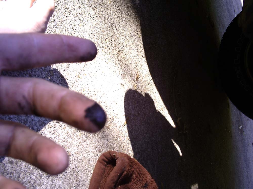

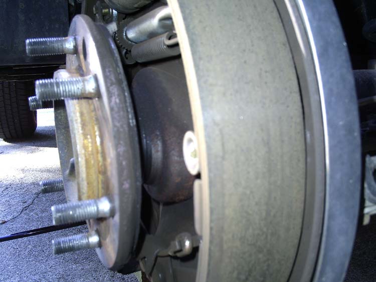

Pulled break drums. Neither was seriously greasy. One was a little more than the other. Only on essentially the deepest recesses towards the axle could I find something that looked a tad slick. Here's the picture.

That picture looks like there is a minor leak from the axle seal. It's hard to say for sure but the darker areas towards the center combined with what's on your fingers indicates a seal leak. There should not be anything slick around there.
Sent pictures to buddy mechanic and the local Toyota dlrshp. They both agree that leak is minor.
