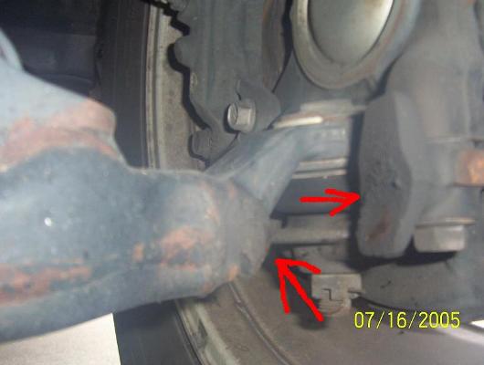

Your "popping" noise at full lock may be the result of contact with the lower control arm.
This has been discussed previously and the dealer fix is to apply a wad of grease to the areas indicated in the picture.
This picture was previously posted by user NCSCOTT:
