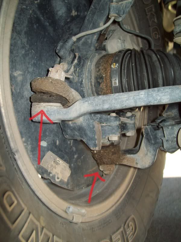

This is my only guess as too what is causing the noise.
100_2467.jpg~original

Techno has given great advice. I am guessing ball joints.
Well, I took the 4runner in this morning before work to have it checked out.
According to the tech the outer tie rod end needs to be replaced and that the steering gear/rack n pinion has excessive play.
The tie rod I believe since it looks like crap compared to the other side but the whole steering gear/rack n pinion I have a hard time with. How do you even tell if that is bad?? I'm not going to do anything about that until I get some one elses opinion.
Nothing was said about the ball joint.
Went ahead and bought a new outer tie rod. Looking at the repair manual it says that you need a separtor to feel the joint loose. Do you really need or can you just tap it lightly with a hammer unit it comes loose? Do you need an alignment after replacing it?

Steering play is when you turn the steering wheel and there is movement before the wheels actually start turning. That would cause sloppy steering, but not this noise. I really think its the lower ball joint, which looks really bad. A tie rod puller is fairly cheap to buy. Mark the thread spots where the old one was and you should be able to get the alignment back the same.
i agree about the balljoint. how many miles do you have on your 4runner?
Well, the lower ball joint was a part of the problem ($250 for parts, labor and alignment). The one noise is now gone.
However, the second shop that I took it too confirmed the first shops diagnoses that they steering rack has excessive play in it.
My 4runner now has a nice metal on metal contact sound to it. :ybrick::ybrick::ybrick: So the search is on for a new steering rack.
