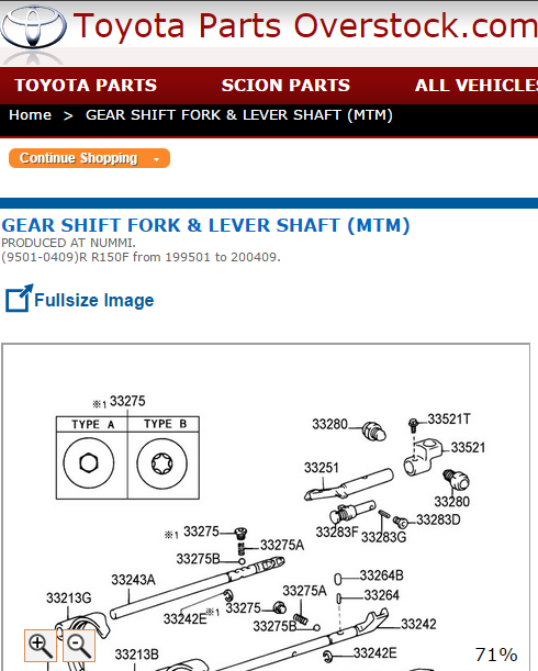

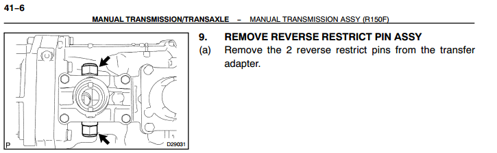

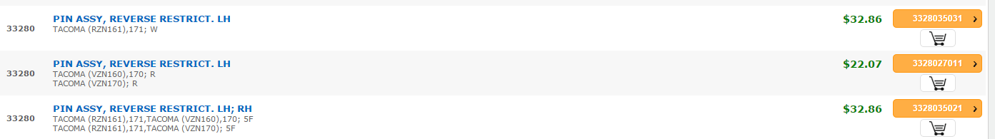

So far this is what I've found
Now to see how to remove them. Seems like they "simply" just screw out.
I couldn't wait! I took them out. Bit of a finger pincher but they came out pretty easy.
