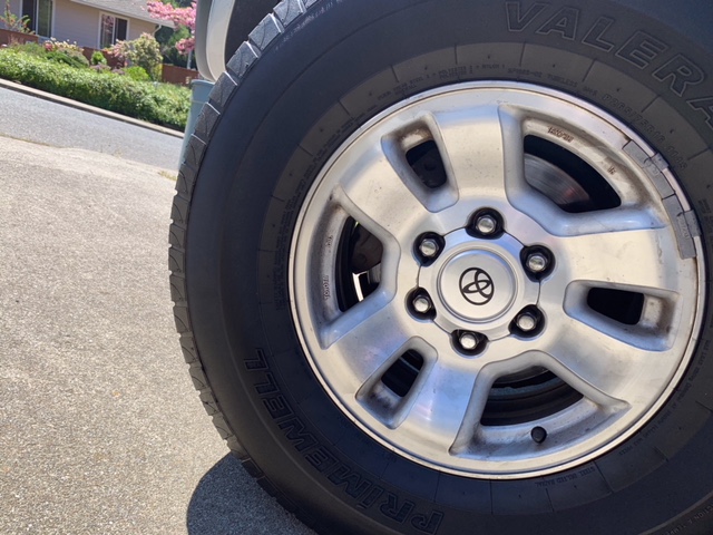

OK, my first substantive post here, I picked up my first 4runner, a ‘97 Limited with e-locker. I have warped rotors, or at least hella shimmy on braking, and want to tow in the future. I have spent too much time searching about which stock rims will clear the 231mm Tundra calipers, including the upgrade thread which unfortunately has a couple photos missing of a couple stock wheels.
Anyway, what is this 16” wheel nicknamed/called? And will it clear the v8 Tundra 321mm calipers? Hate to ask but I have really tried looking at various websites including search engines.

Damn fine bit of info there, I NEVER would have considered that...will look into it, still want the 231mm campers/rotors, will look for extended studs and 1/4" spacers...
look for different OEM wheel options as well - there's always plenty for dirt cheap on CL
If you are handy with a grinder, you can take some material off the back of the rims. You'll see a "point" in the casting on the backside. I did this before I got the TRD tacoma wheels that clear completely. You're taking off a fairly insignificant amount of aluminum on each of the 6 spokes so it doesn't affect balance or ride.
1/4" spacers are cheap. And Toyota rear studs...no grinding for me.
Just a heads up though, universal spacers can affect ride quality and develop a shimmy. Makes the wheels lug-centric instead of hub-centric. I didn't want this so I busted out the grinder.
