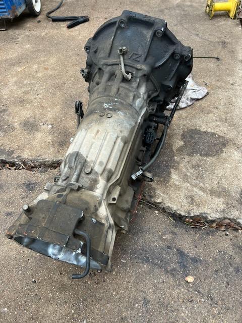

Done a complete OEM suspension refresh using '99 highlander springs/struts/shocks, not driven yet but boy is it taller. Old original bushings either had large cracks or were missing large chunks, this should feel really good. Didn't add up all the costs but they were plenty even as I shopped around. Hopefully trans shows up next week and I'll be wheeling out to the deer lease next weekend, more to come.

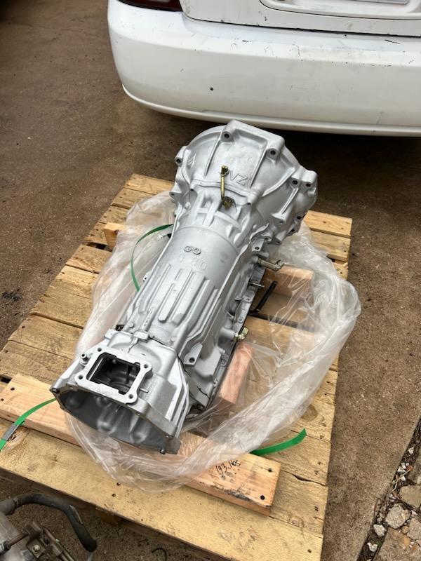

I have a call into Yota1 < Yota1 Performance Engine & Machine - Your Toyota needs all in one place! > out of Riverbank, CA (nearish Stockton/SF area) about what to do next.

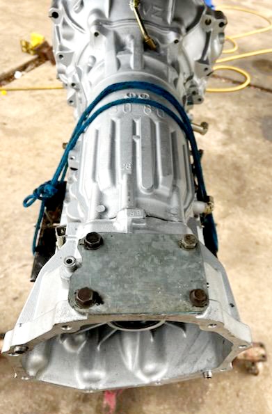

Edit: Spoke to Nick, he said they can send the plate/gasket/bolts out or we could make one or swap tailends. We chose having them send the plate/stuff.
We'll install new trans and put part on after it arrives, need to get this vehicle out of the way.

After 2 days of waiting for the 'official' tail end top plate, we made one.
Replaced transmission mount with new OEM. Installed transmission, new Magnefine filter before fluid entering coolers, Hayden 699 cooler in-series after radiator cooler, new Denso radiator, OEM cap, Toyota red coolant, OEM thermostat and OEM heater control valve, filled with Toyota TIII fluid and tested.
Runs very smooth, firm yet not harsh 1-2, just like OEM and gentle 2-3 and final 'shift' into OD. Took it easy first day and now have driven at highway speeds while climbing hills where I could turn OD off, handles it very well.
I can now tell old trans was 'sluggish' 1-2 and 2-3 shifts, this one feels like I'd shift a Porsche manual, fast, smooth and accurate with a quick power take off in next gear.
Old trans fluid was changed just last summer, it came out Black and had many tiny chunks. Tried to remove TC from old trans, it was stuck solidly in place - its bearings must have failed and it glued itself in place. Despite this, it would still shift and run with occasional noises like marbles inside of it. It lasted 338, 861 miles, RIP.

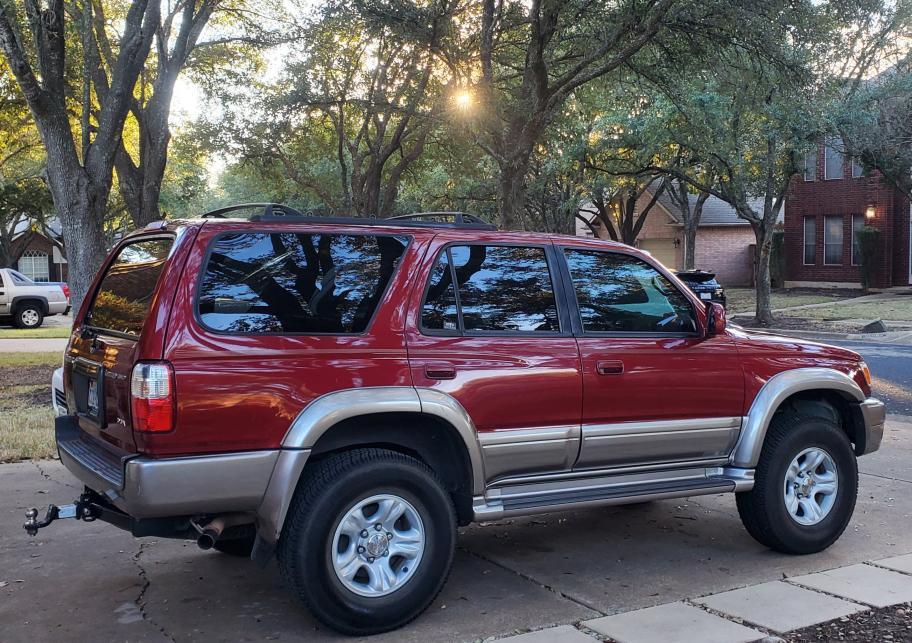

While we were at it we aimed for a suspension refresh, we swapped out all shocks/springs (blue/yellow & yellow/red) using new '99 highlander 'talls'. Also replaced all bushings, many were quite a pain to R&R, some were easier, LBJs with new bolts + protector boots, upper ball joints and rear upper control arms. Then took it in for a 4 wheel alignment, toe in was significant - feel great now.
Here's a pic of how it sits now, the change in driving characteristics is night and day - even that doesn't describe it. More car like and less truck like. The off-road tests come next.

Oh man. I could have sent you a plate if I knew you needed it.. :)

mtbtim - Thanks for catching my dyslexic mistake of the day!
Minor update: Drove about 150 miles today, with about 40 of that being off-road in 4wd, partially in 4Lo. Smooth shifting up and down, held in 2nd in 4Lo when starting there. Always very quite. On way home, using OD override seemed much quiter than with previous oem trans. Temps after 1.5hrs of driving stayed between 145 and 185 with those 'higher' temps only being seen for a few seconds, then quickly back to mid 160s.
Jan '23 Update: The good - transmission from Yota1 is working very well. Have about 800 miles on it so far. Only once while traveling slowly in town wiht little throttle did a slightly harsh 1-2 shift occur, that worried me. It never did it again, with nothing but smooth shifts up and down.
Now here is another Plus. Fuel efficiency has gone Up dramatically. Previously even on Full highway driving, the best it could achieve was upper 14s/lower 15s, the other day it broke 17!! So clearly something was very wrong with my old trans, it shifted smooth until it last day but the T-converter would not move at all when removed it, weird.

96Red was same color scheme with chrome bumpers by far best color, yours looks great.
