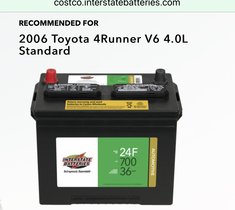

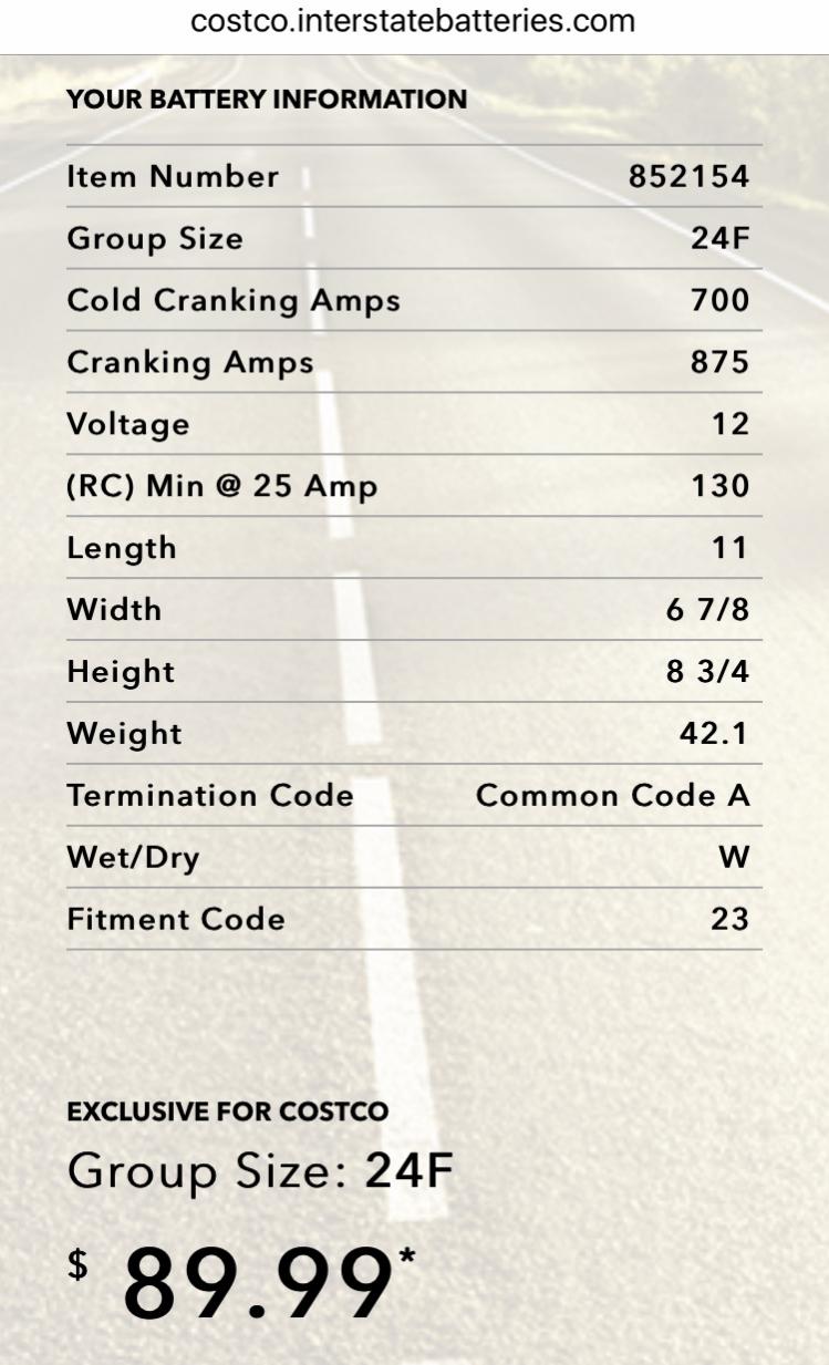

Interstate - Costco
EverStart Maxx (Yellow) - Walmart
Those are me two go-to for regular automotive batteries... quality is good, price is right.
